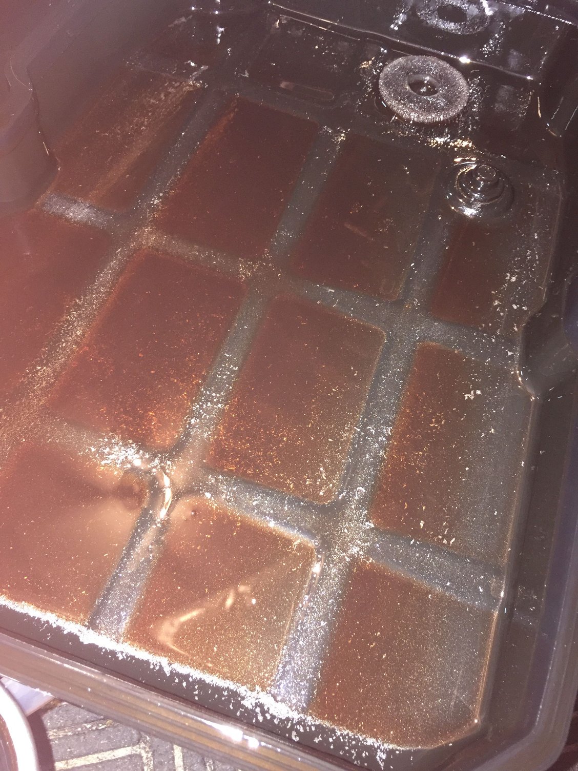

To update, after changing the conductor plate and driving for about a mile it's become obvious the trans is completely shot. I'll attach a pic of the inside of the pan after the mile drive on fresh fluid. As far as symptoms, the car never got rid of the p0715 code during all of this and stayed stuck in 2 gear limp mode after changing the conductor plate.
I found a local place that will do a full rebuild of the trans plus a few extras for $2200 and can do turnaround in less than a week so I'll be going that route.
