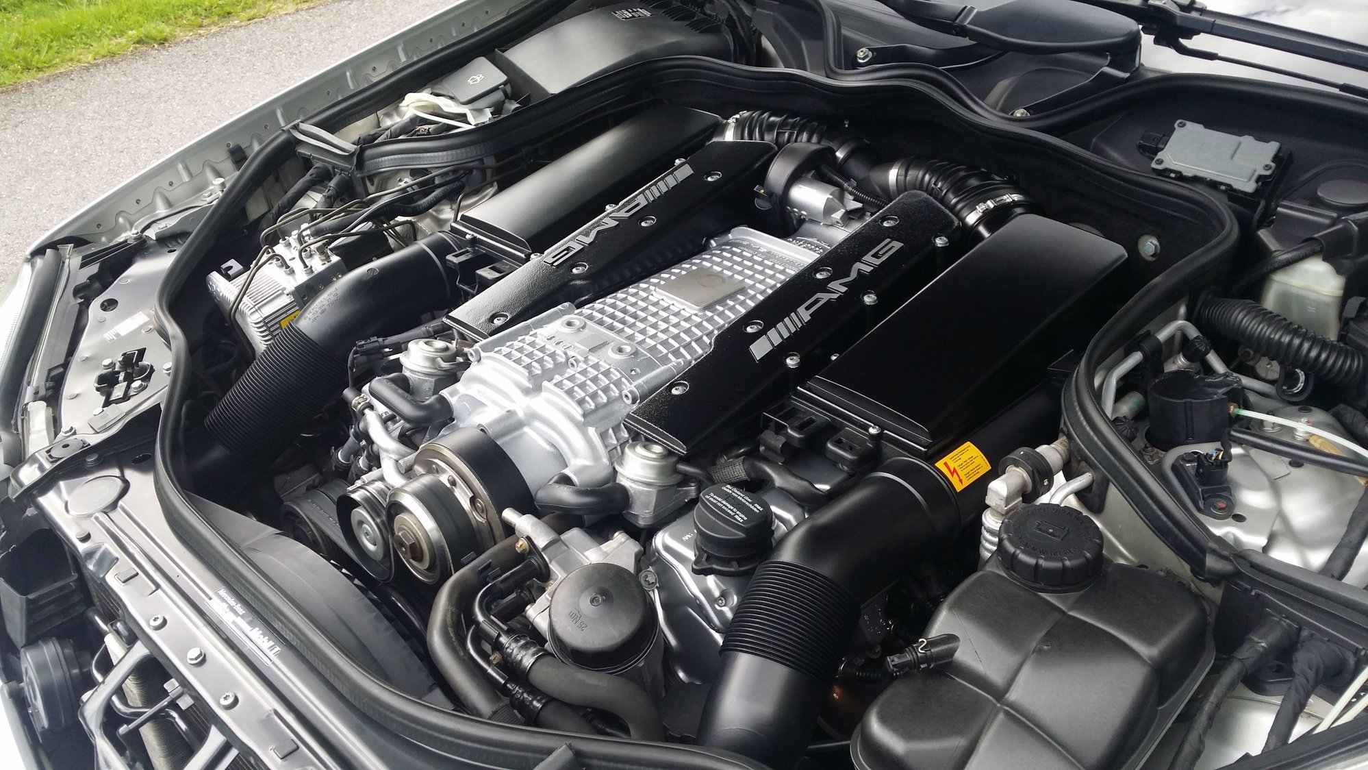

I used VHT Wrinkle Black on my surge tanks and valve covers. Holding up really nicely so far...
Did you mask off the AMG logo or just paint over it?

Very thin layer of Vaseline on the lettering and logo. Wipe clean when done. Then I sanded the lettering with 200 grit sandpaper to refresh it and give it a uniform look.
