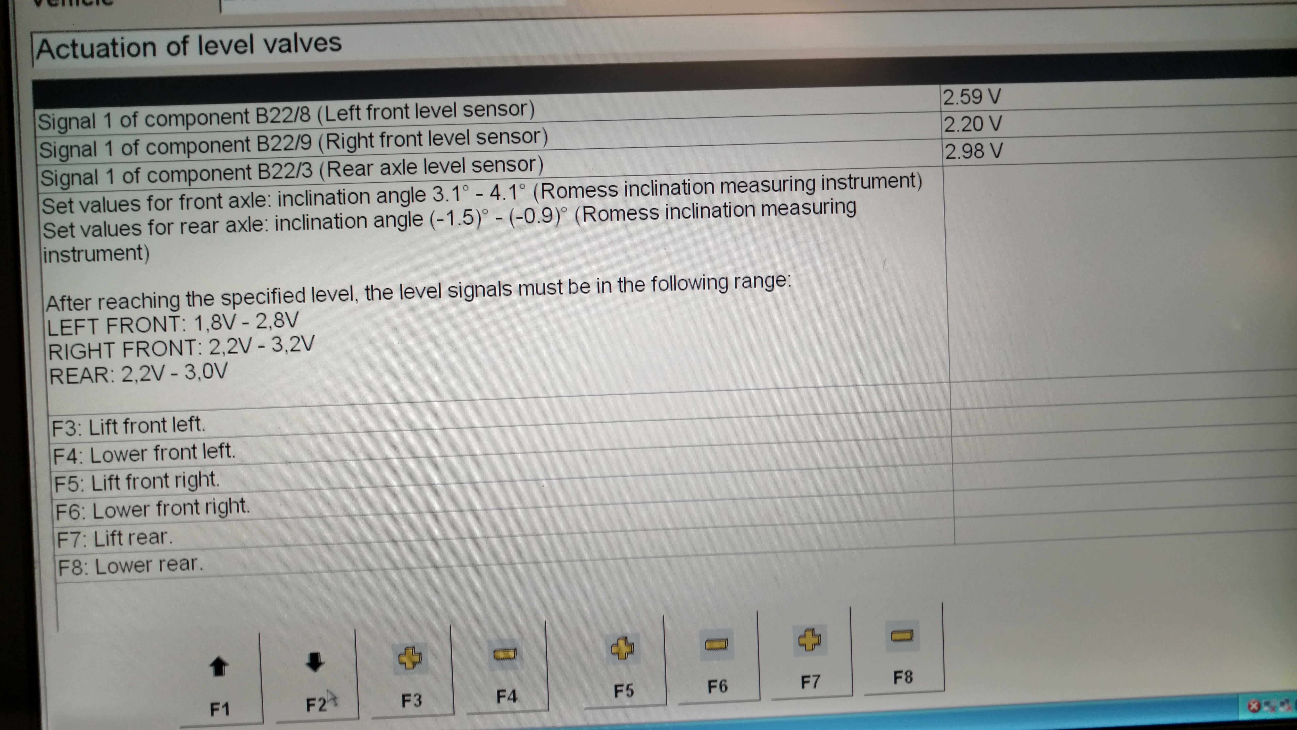

aligned in comfort. mostly been driving in comfort as well.
this is how the car sits. i swear this thing lowers itself a half inch after i park.
ive also been contemplating reverting back to stock ride height to see if that helps, but have no idea what the stock values are for inclination, nor how to revert back to where stock ride height was lol.
also last time i checked the airmatics via star there were 0 faults in the system.
one thing that might be worth mentioning is that everytime i go to mess with lowering via star the level signals voltages are way below or over what i set the height to.
they are supposed to be
LF1.8v-2.8v
RF 2.2v-3.2v
rear 2.2v-3.0v
i have the cars height where i want it, and within the voltages. set the inclinations all is well. no errors or messages but now if i go back into to star and mess with airmatics again the car is no longer within the values
LF1.8v-2.8v
RF 2.2v-3.2v
rear 2.2v-3.0v
could this be my issue?

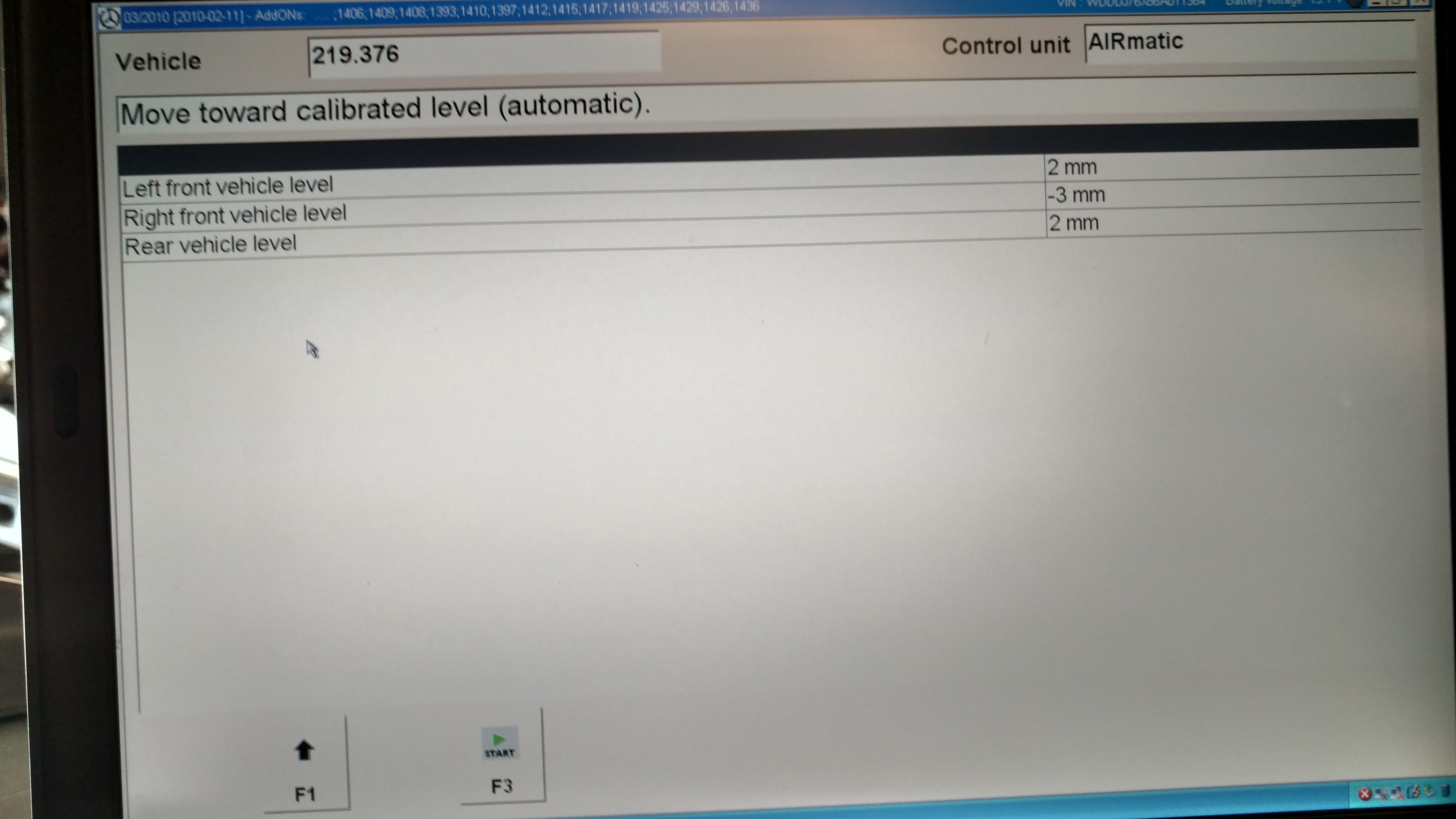

also raised the car an additional inch yesterday, and this time my voltage values were the same as what i set them in april. 0 faults were found in the airmatics, tested everything individually via star as well.
only things i found weird was the vehicle level
LF vehicle level was 2mm
RF vehicle level was -3mm
rear vehicle level was 2mm
first pic of actuation levels is what i had set in april. i dont get why the left wheel is at closer to high side of the voltage,
and the left side is at the minimum.

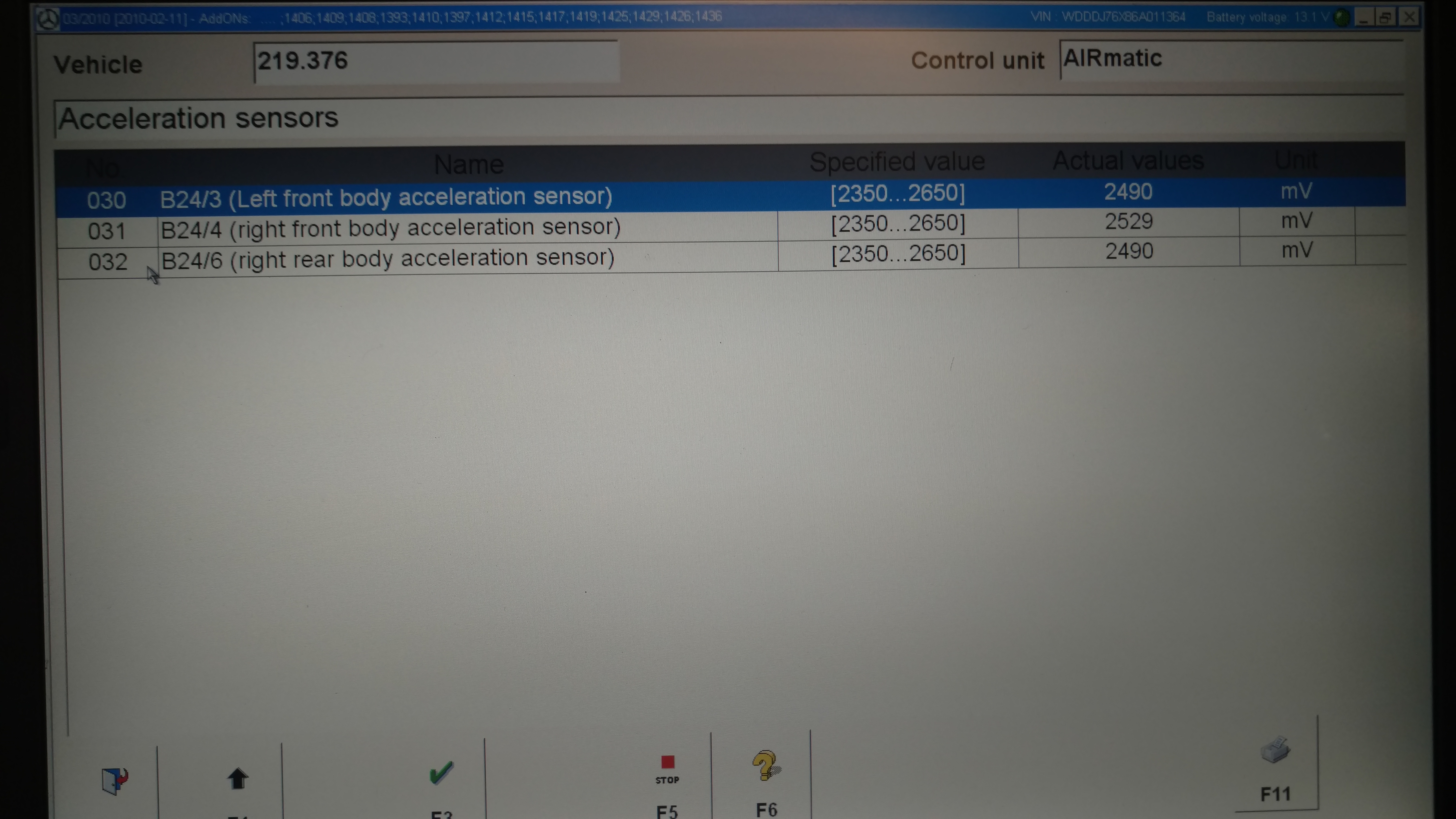

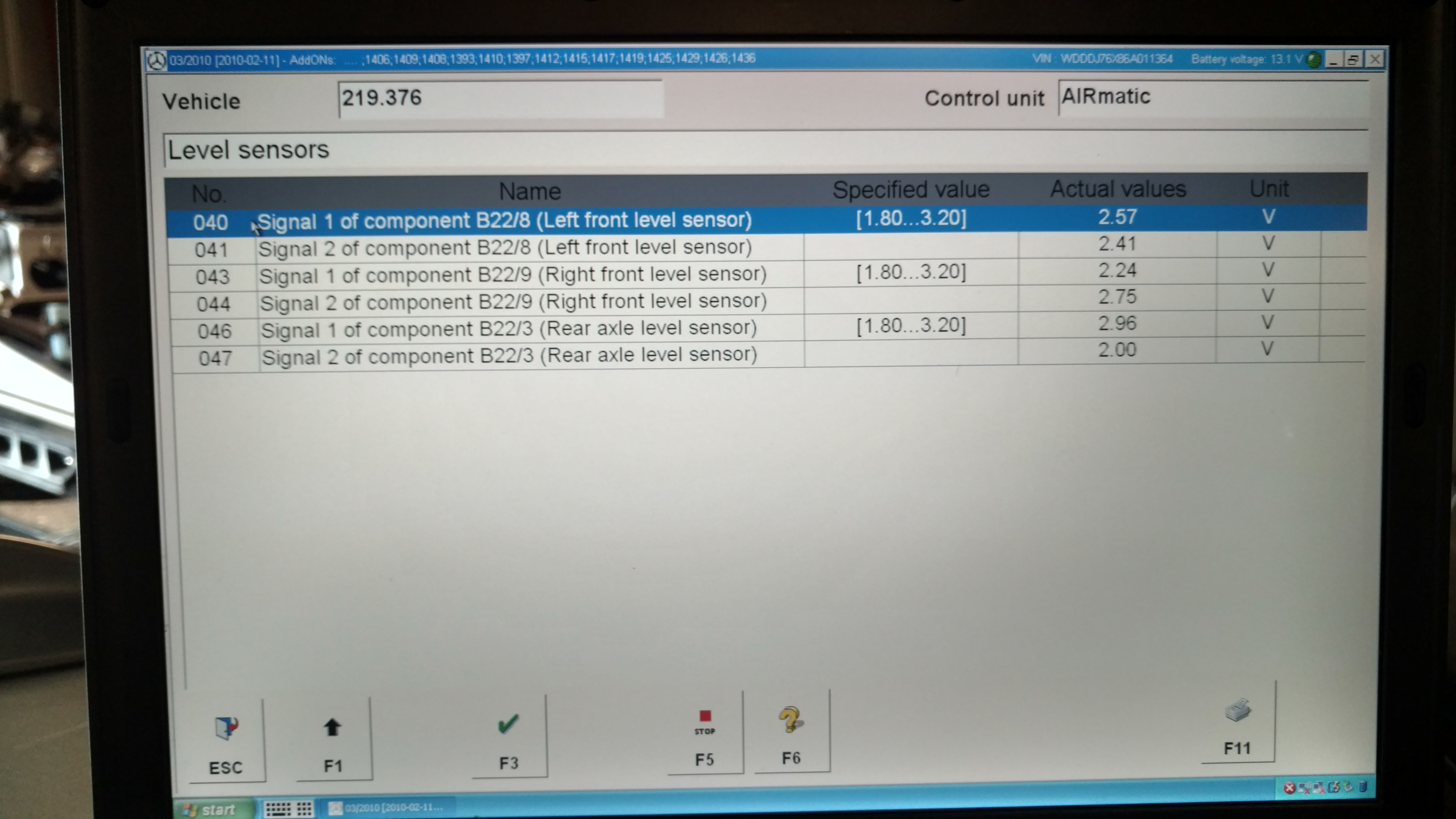

more screen shots
