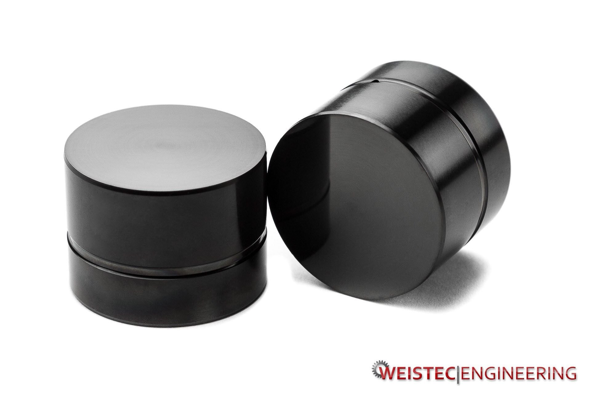

For prevention of breakage of the engine I think, to replace bolts of a head and lifters. What lifters is better to choose, (for the standard engine) (514 HPs). I think to establish lifters from a black series of SLS... who what thinks ?Or after all , better standard lifters of SLS! what difference between them?

To do this job you will need to remove the heads and it has a lot of labor time involved. Also do the head bolts since they have this issue and the normal SLS valve buckets are just fine the difference is the coating i believe. I am doing the same to my car right now. You will also need new gaskets since the old ones can't be reused.
Here someone wrote me that bolts of a head can be replaced, in turn without removing a head! 😑
