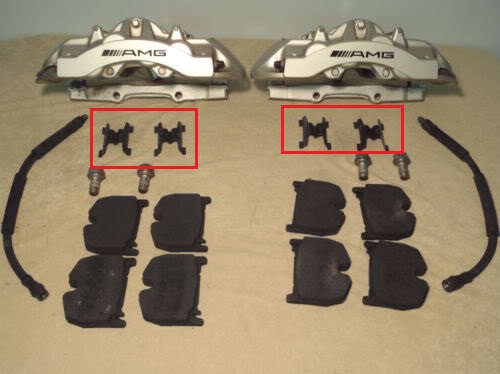

So I need just a little bit of help since I can't seem to find what I need for the brakes.
I'm swapping the 4 piston fronts/single piston rear calipers on our e350 for the AMG e55 8 piston fronts/4 piston rears. They appears to be solid but I am missing some of the hardware.

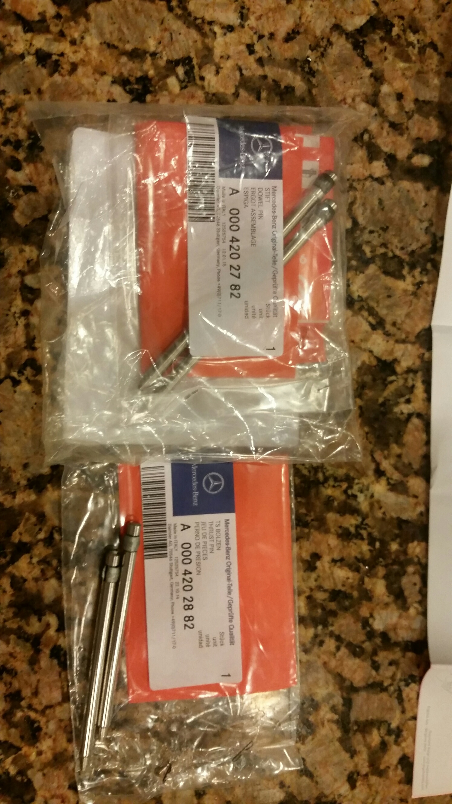

I was on FCP Euro and ordered what I thought was the pin/clip kit however, it's only the front /rear caliper pins. (which my calipers already have)

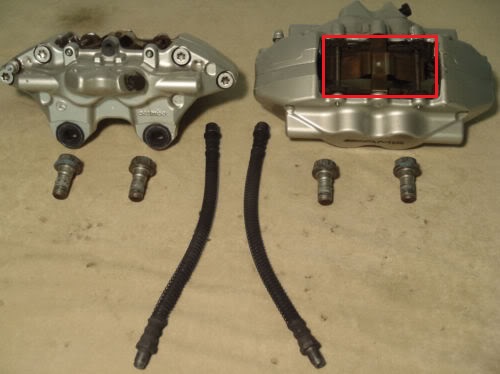

What I need are the rear anti rattle clips/metal items that go on the back of the brake pads so they don't rattle/move around.
Below is the part number that I purchased. The other two images are what I need. Other than that, I already have stoptech s/s brake lines, akebono pads and the rotors. Just need the backing metal plates for the pads.
Prefer OEM/MB. No Orileys around me or anything like that so ordering online is fine. I just don't know what I'm looking for via part numbers...lol

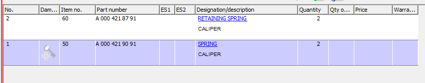

0-55:
Thank you sir!! I found the front on FCP Euro: Pricey at $14 a pop but that's ok.. they are needed.lol
https://www.fcpeuro.com/products/mer...mer-0004219091
Now trying to source the rears. They don't carry the rears for some reason. Ebay shows up nothing so I'm going to call the MB dealer in the morning to see if they can order it.
Thank you so much!! It's much appreciated!
