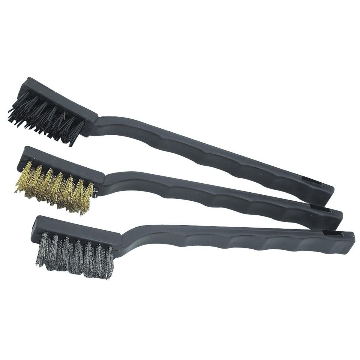

These covers are made of magnesium and don't exactly enjoy being jolted around. In my many forays into re-sealing the covers I have always had great success with using a metal pick and a plastic brush handle as a wedge.
Use the pick to run through the outer edges of the RTV seal to help loosen its grip.
Then gently wedge the back end of the brush handle between the breather barb and valve cover.
Apply force in a steadily increasing manner and you should start to hear the sealant give way (sounds like it's sucking air). Keep the pressure consistent until you have enough room to use your hands.
The metal pick comes in handy for clearing the sealant trough as well.
Metal Picks
Detailing/Cleaning Brushes
