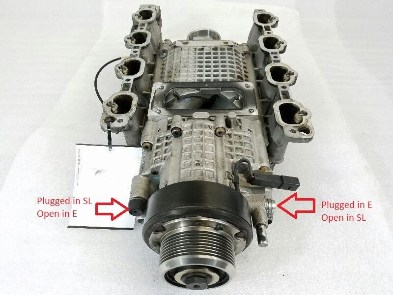

In my effort to relocate secondary air pump from right to left of center radiator, to gain more room for active cooling, I realized the essential difference between SL55 and E55 is with secondary air pipe routing.
The SL55 gets the hose under the passenger side inlet, while the driver side is plugged, and vice versa in E55
The question i couldn't answer in EPC, is does this rubber plug sell separately ? (this is a stock photo, dont mind the broken aluminum)

bayhas, is that meant to be some sort of pressure-relief device? I have ideas but I'd like to understand what it does before I throw out erroneous info.

Nope, just a plug to close an unnecessary hole.
Here is another picture of an SC out of an SL
Although the SC is upside down, its a better shot to explain, the two openings take the to exact same cavity in the SC housing, the only difference is how the hose is routed
