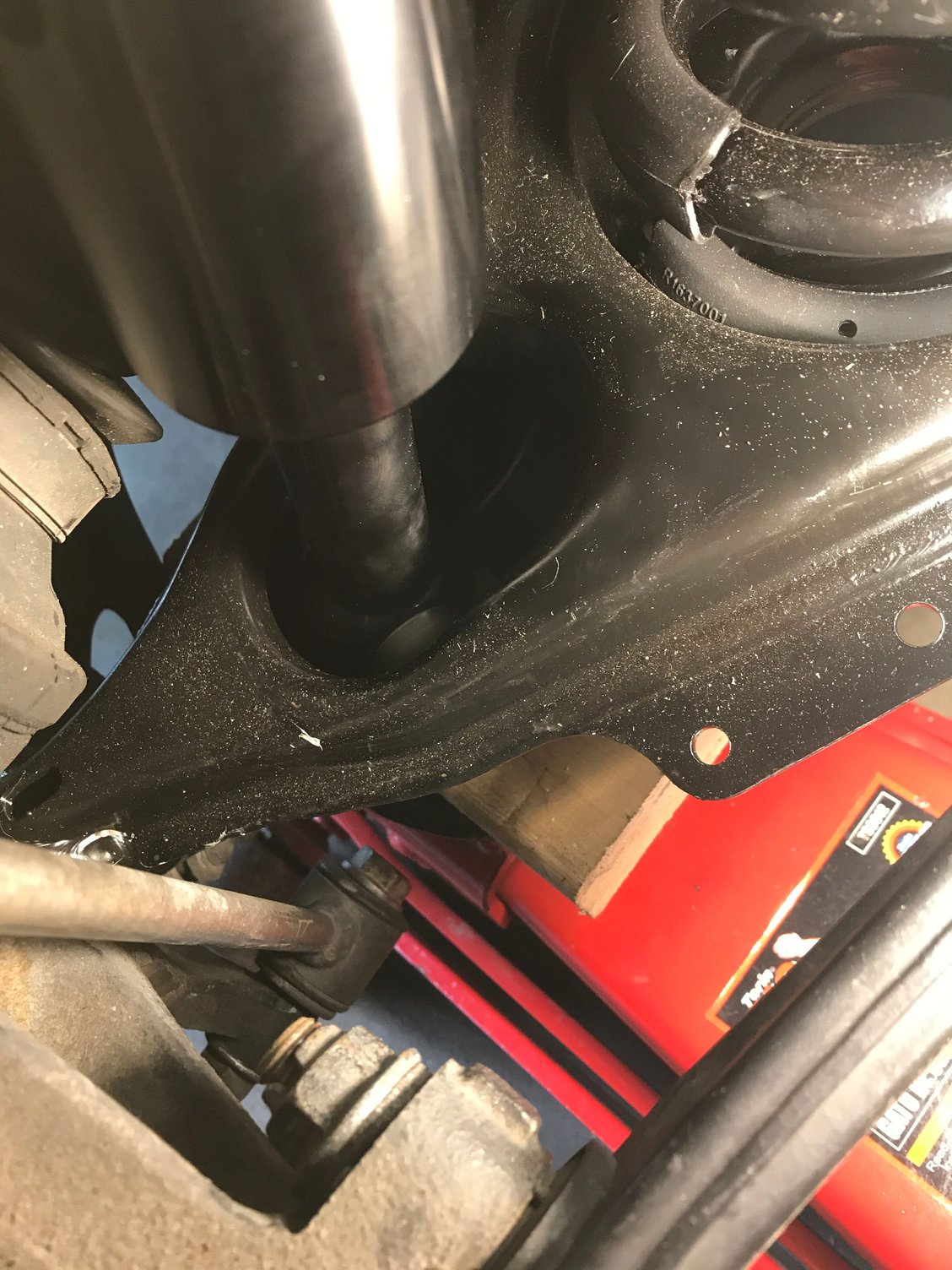

Currently I have the rear suspension up about 8mm or 0.3 inches, I am unwinding the shock a fair bit but now can get it the last inch or so since it’s hitting the side of the lca where it mounts
grrr...

Dumbass didn’t realize actual threaded sleeve turns
