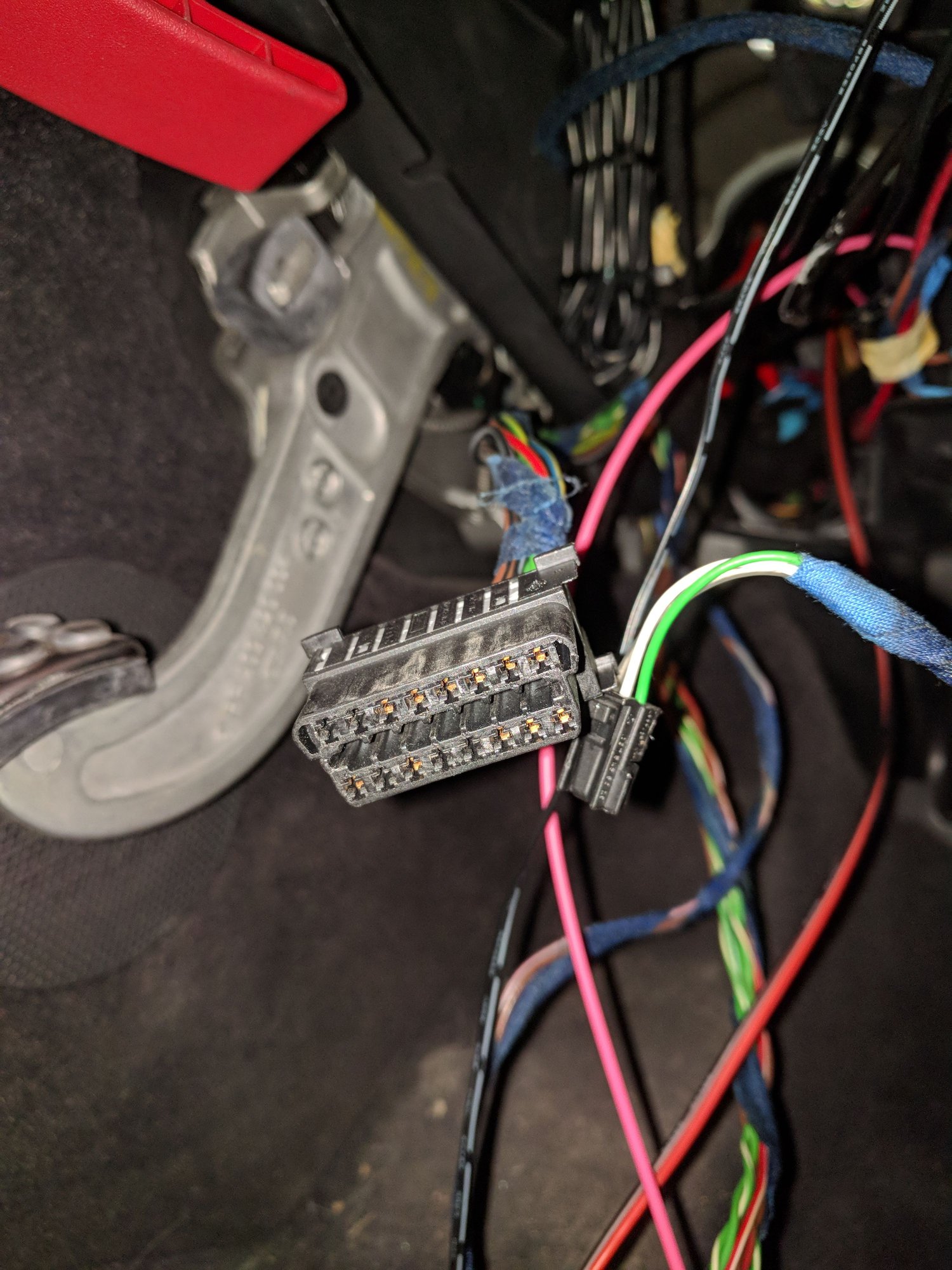

I was hoping someone could lead me in the right direction. Registration is due and I needed a smog check, my check engine has been and I have been procrastinating to address the issue. I have an OB2 scanner and it worked previously however when i plug it in the OB2 port i keep getting a link error. I know it cant be the fuse because the scanner powers on, it just doesnt connect to read the codes. I tested the OB2 scanner on another car and it worked fine. I guess the next thing to do would be to check the port itself, does anyone know to remove the port so i can make sure all the wires are good. What else could it be?

I'd check the port to make sure the terminals are seated properly and one didn't get pushed out of it's seat. The port can easily be removed by removing the under dash panel it's attached to (a few screws and a white plastic push retainer towards the firewall). From the top inside of the panel there is a retention bracket that holds the port to the panel. You need to push to slide it to one side to unlock it and then the port/wire harness pulls away from the panel.

thanks for the reply. I unseated the plug and performed a visual check and everything seems fine. Could this possibly be a connection problem between the ecu and ob2? does anyone know to check the connections to the ecu?
