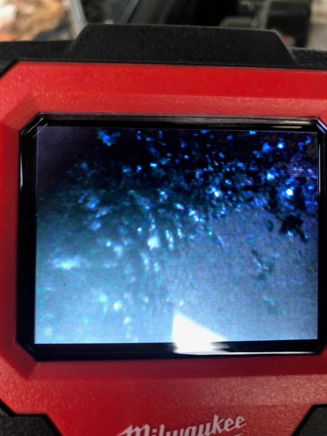

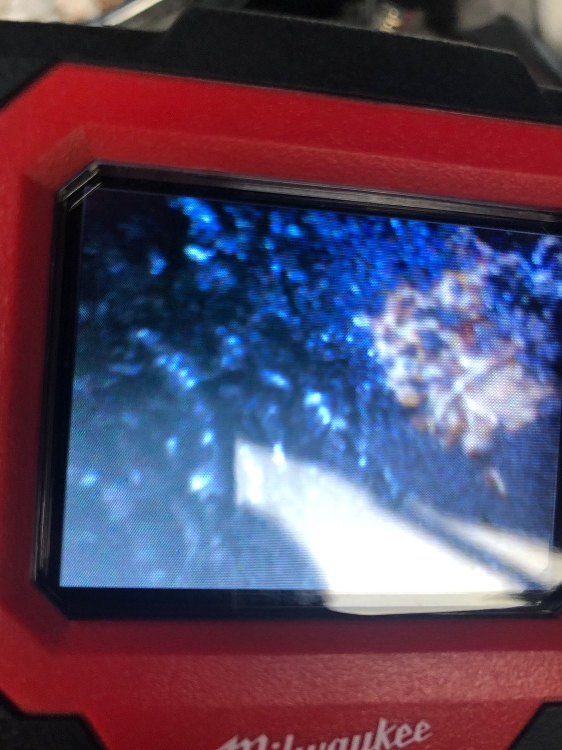

Small update.
Got a camera snake to look in the cylinders through the spark holes.
Every piston 6,7,8 look clean. No scoring on the walls and as far as I can see nothing wrong with the pistons .
The plugs on piston 8 are clean, the rest are kind of oily. The worst of them is cylinder 5
Cylinder 5 has sludge everywhere, I don't think I could even see the cylinder walls.
Buildup on piston too.
Pics attached below.
I will take off the manifolds later and see if the intake valves are ok.
I'll try to do a compression test tomorrow.
More Pics below https://imgur.com/a/udQAYeC

The car in the video sounds like valve train problems. Might be time to pull a valve cover or two if yours sounds like that.
