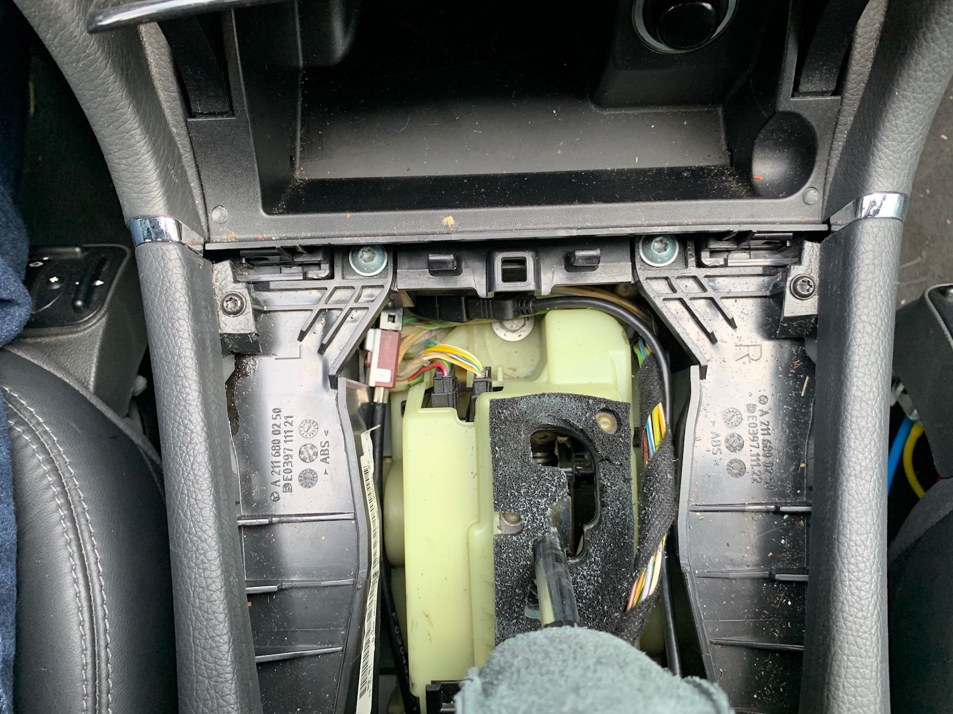

There is a spot to hook up to the OEM antenna under the shifter? I thought you had to run a wire to the trunk O.o Any chance you have any pics?
That's what I thought too. So I actually bought a 20' antenna cable and ran it down the cable channels to the back of the car. Then I pulled the damn shifter up and it was just sitting there. I hooked it up and it worked perfectly. I'll try to pop it off tonight and take a picture.
Wow, very cool thanks! I can dig into it at some point it's all good. I didn't want to run a wire back and tried an aftermarket antenna that is garbage

The maroon rectangular box is the antenna cable. I have no idea if it's on every W211, but for me it was just sitting there.
Antenna cable below shifter
