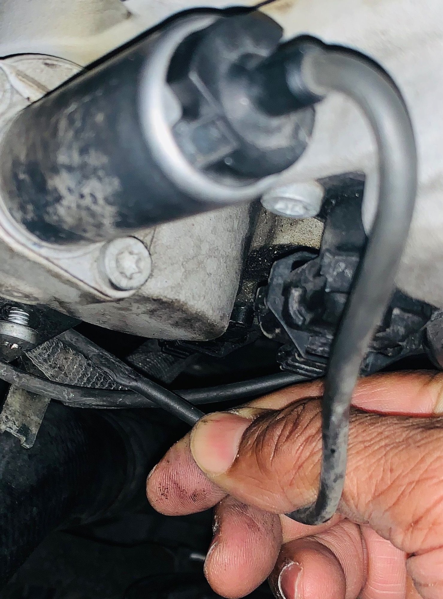

I'm doing that now. I'm hoping it's something close to what's described in the related thread below.
I did find this... researching the part now- I believe it's the valve actuator??
