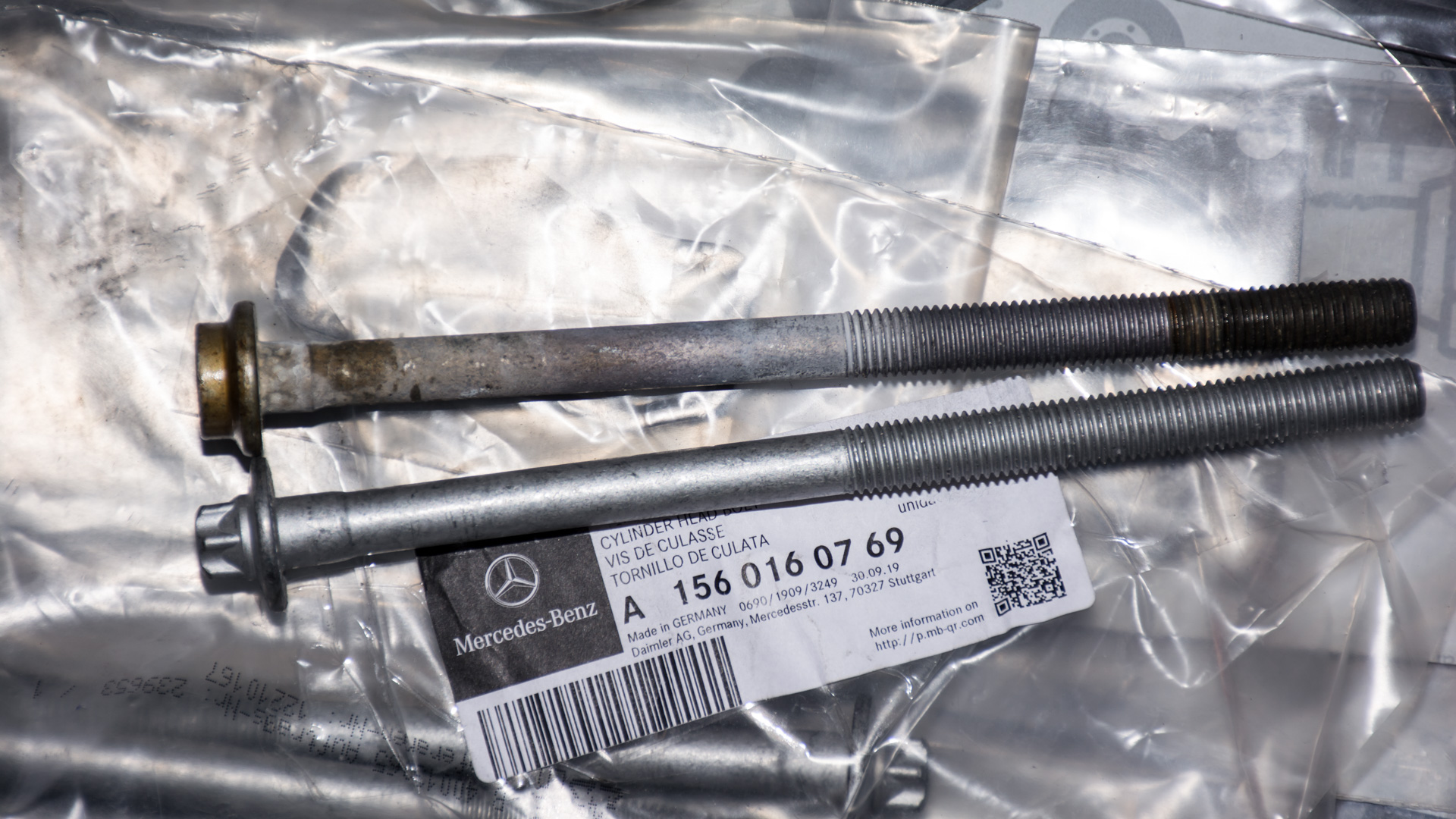

After researching a lot on this forum and YouTube (thanks Tasos Moschatos) I decided to replace head bolts on my 2007 E63 AMG. I created a video How-To for future DIYers. Hope this video will help someone. In the video, I try to capture almost every step involved in the project as well as talk about unexpected nuances encountered along the way that might not be in other resources. HUGE THANKS to the forum community and special thanks to @6172crew for providing advise and timing tools.
My car is 2007 E63 AMG with 67K miles currently and is well maintained. I expected to see much rustier bolts, but they were just fine with few of them showing some surface rust. I think I could've leave them alone and the engine would survive a long time without replacement too. There is a thread on this forum where people report high mileage cars with M156 on original bolts. Let me know in the comments of the video what you think of the bolt condition. I will post another video on YouTube where I will show each one of the bolt. I will also talk in more details about the mistakes I made along the way and how to avoid them. So subscribe if interested.

I posted another video showing the condition of the bolts. These bolts looked just fine to me, but let me know what you think?

I hope it helps you. You replace head gaskets when you pull the head. That’s the Mercedes approved way of changing head bolts which is not something I feel comfortable doing myself. My video shows what tons of people on this forum have done which is replacing head ***** one at a time. It works fine if done properly and if they haven’t been compromised. For example if you know that the coolant is already getting into the cylinders then most likely you have a broken bolt. In that case you’ll have to pull the heads and replace the gaskets. Does it answer?

Tasos Moschatos, I don't know if you know who he is, watched my video and said it was a good idea to change the bolts now. I trust his experience, although the rust I found on my bolts looked to be on the surface. Re:everything you touch breaks: it is true to some extend, especially about any plastic that's super brittle. One should expect needing to replace some solenoids, clamps, covers, etc. We all know what Achilles heel of this car is after 10+ years: breather, intake manifold gasket, crank position sensor, transmission valve body, airmatic struts, cam adjusters, and maybe head bolts (depending on what you believe in). The bottom part of the engine is strong. Once those are addressed, the car should be good, but at that point you've spent ton of money, if you didn't do any job yourself, lol .
