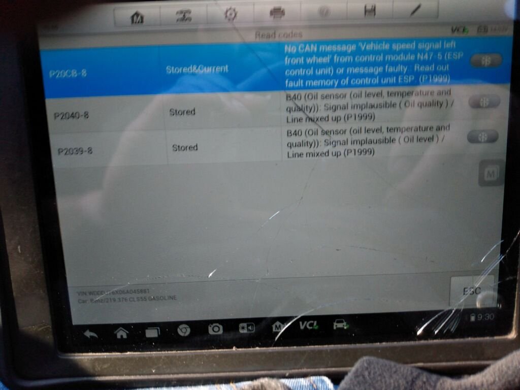

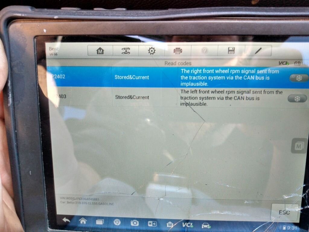

Hey guys. Its been a long time since i posted questions. I may be on the wrong feed so excuse me if I am. You guys were great in helping me changing out supercharger pulley bearings and other things before.
I had a driend help me change front break pads and we and the rotors turned. He hooked a scanner up to it also before we tested it so I dont know what the car would have a ted like before it was scanned. I dont think scanning would cause problems bht I am chrious. I have some of the codes that came up andI will add them. When I drove the car it says abs system failure esp failure and the power steering will work for a minuete and then when I start driving it goes out also. Has anyone had this same issue?

Go back under there and make sure the speed sensors are connected the right way.
I got that same code when I did the below:
When I did the brakes on my E63 I had an issue where I tightened the speed sensors on top of the plastic retaining clips, which made the sensor not sit flush inside the hole.
Secondly I would double check the wiring.
Go down there and give it a look, snap some pics as well.
Hopefully it's the same problem I had.

Worth checking your wiring regardless as the speed sensor is coming up in your scan tool.
