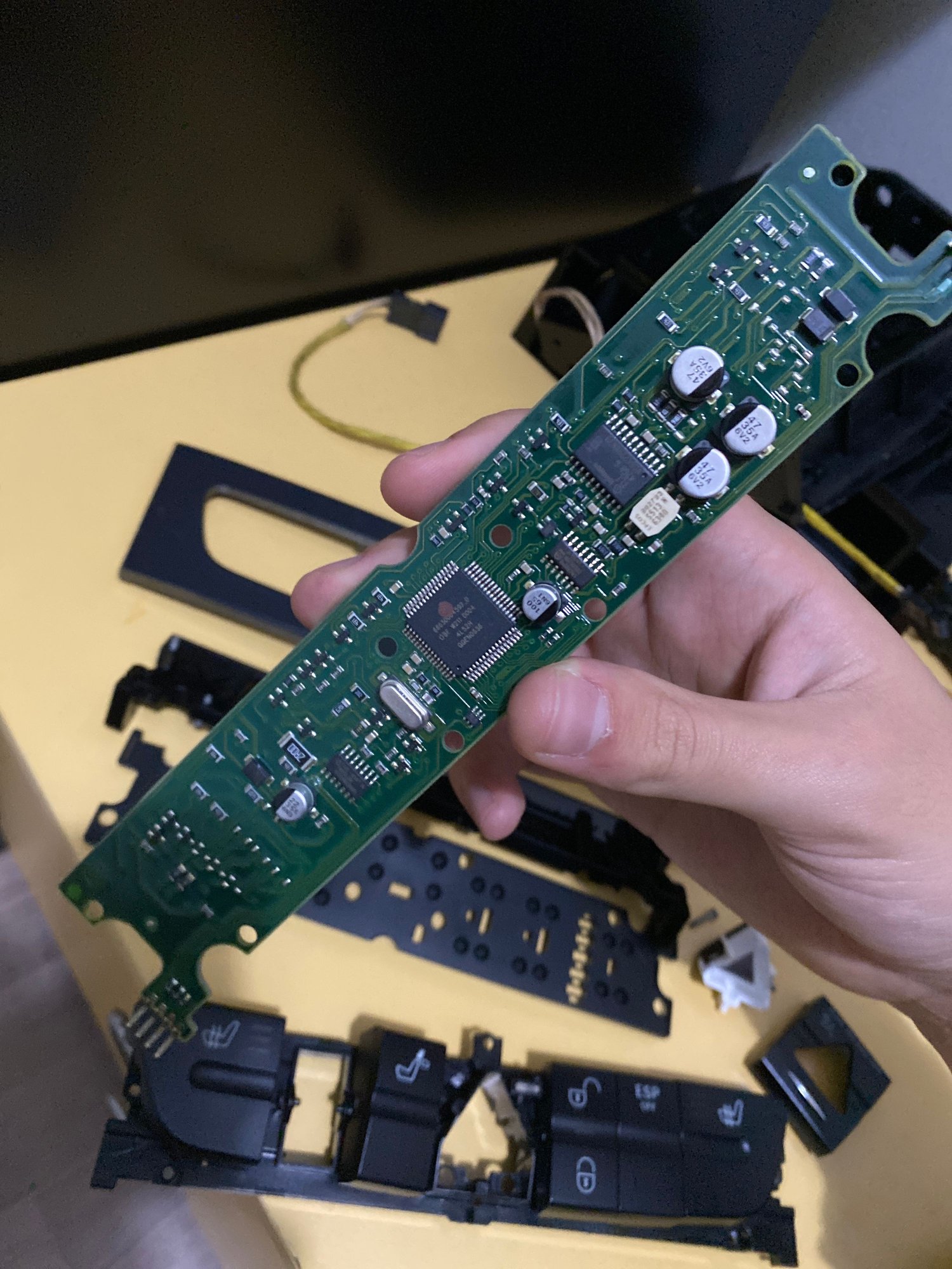

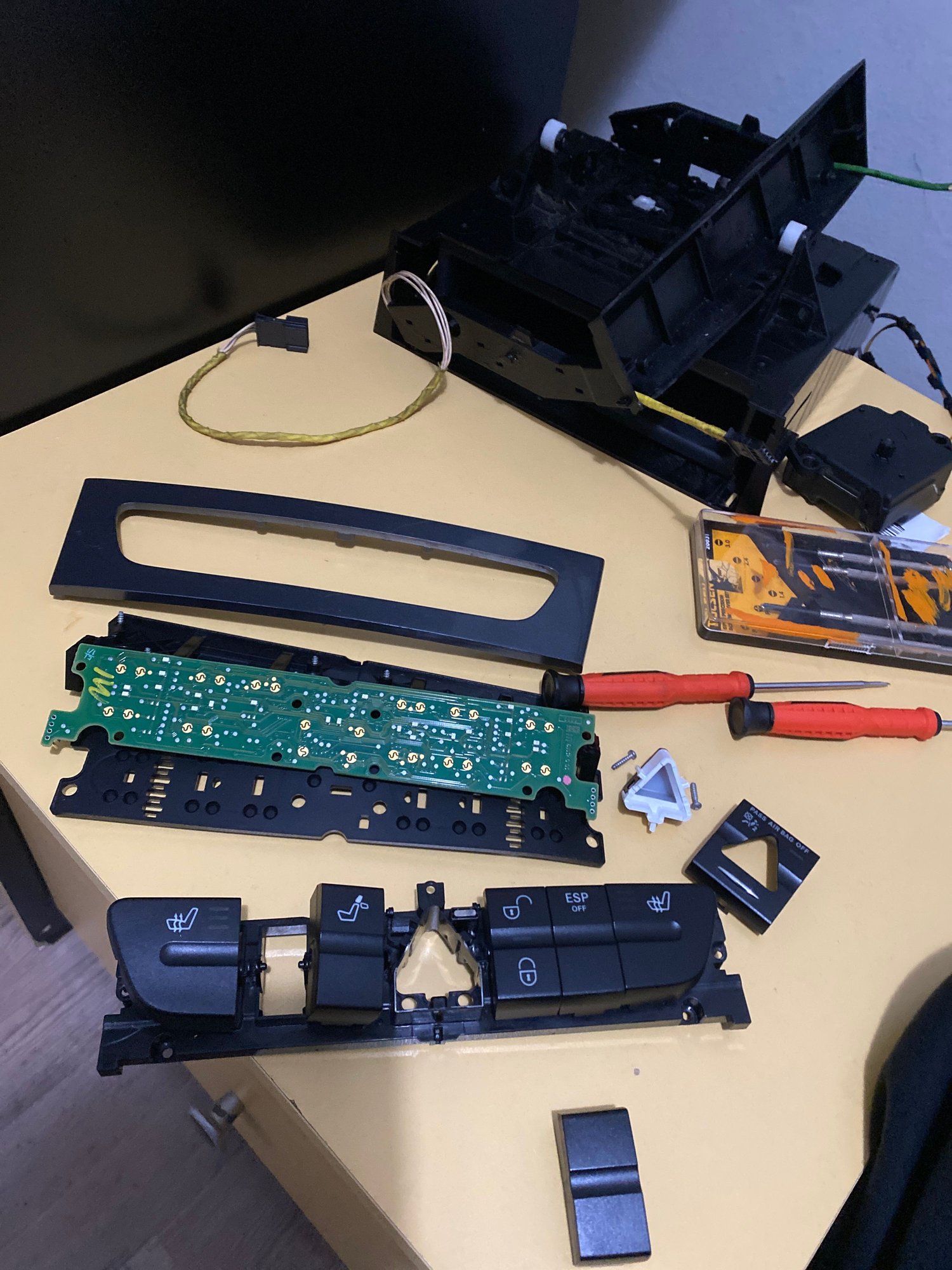

Possible to modify the center under radio buttons
Hello, I'm updating this here for anyone who's gonna run into this problem in the future. I wanted to add the rear headrest fold button to my button cluster from a wagon model. the motherboards and rubber buttons for these seem to be the uniform, with places for each button, and you can take individual buttons on and off, though it is kinda difficult to take the panel firstly off of the cd changer, then it is also difficult to take the buttons themselves off, with the seat heater buttons being the easiest. I've yet to see if just having the button clicking will do, or if the boards come programmed. I dont think adding custom buttons for options which arent OEM would be easily possible at all, but adding OEM ones seems to be pretty straightforward, although I will update this thread once again after I test it's functionality.
