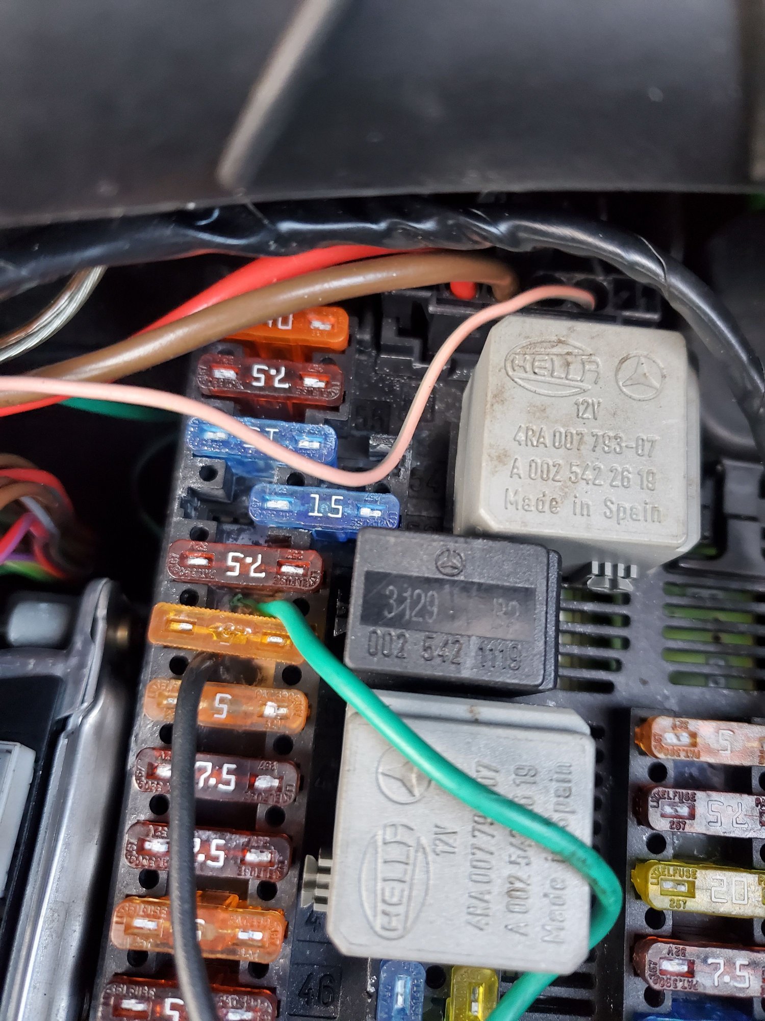

It was driven by the gentleman that rebuilt it, he mentioned before it stopped running, at WOT it would cut out and lose power and run really rough at idle. It got codes for MAP sensor and that was replaced - codes still there. I believe when the MAP sensor was being replaced the throttle cables got swapped. It also has codes for throttle potentiometer now and the vehicle will not stay running, It burns through fuel on cold start and it smoking thick black out the back. BUT WAIT THERE'S MORE lol. There are 2 fuses for the throttle bodies and 1 of them is off center(dont know why but it is functioning). The front SAM has wires stealing power from a fuse(will confirm number and purpose) and it goes somewhere in behind it and I think to the dash, will take it all apart and post pics. There is also some sort of turn dial that is installed on the left hand side of the steering wheel, which is where I believe that wire goes to. I made a video of the dial because it makes an audible tone when switching it. The SAM has corrosion building around the fuses so I'm going to take it out and clean it up. Will also take pics of it then.

Does anyone know what that turn dial is or could be ?

This place is a joke.
K40 radar detector

The off-center fuse is normal, those spots have an 'a' and a 'b' designation in the fuse diagram. Looks like it was just tapped into for the radar detector.
Yeah, first step is to get a base map on the car. With the injectors you can't use a stock map, so you'd need a tuner (I'd recommend RaceIQ) who has an off the shelf map for 550cc injectors and the other mods. You can also go straight to the dyno and start tweaking, but if you think/know it has a bad tune on there who knows what you're dealing with from the start.
MAP and TPS codes and having that 82mm TB on the car - that is not uncommon. May be worth picking up and switching back to a stock TB to eliminate that issue. Too many people have erroneously replaced MAPs that were just fine, the codes are set because the airflow confuses the MAP and the 82mm TBs in particular are to blame in many cases. And the cutoff could just be overboost with a bad tune.

@E55Greasemonkey
Thanks a ton! will have to hunt the wires down to make sure the radar unit is still there from the accident.
