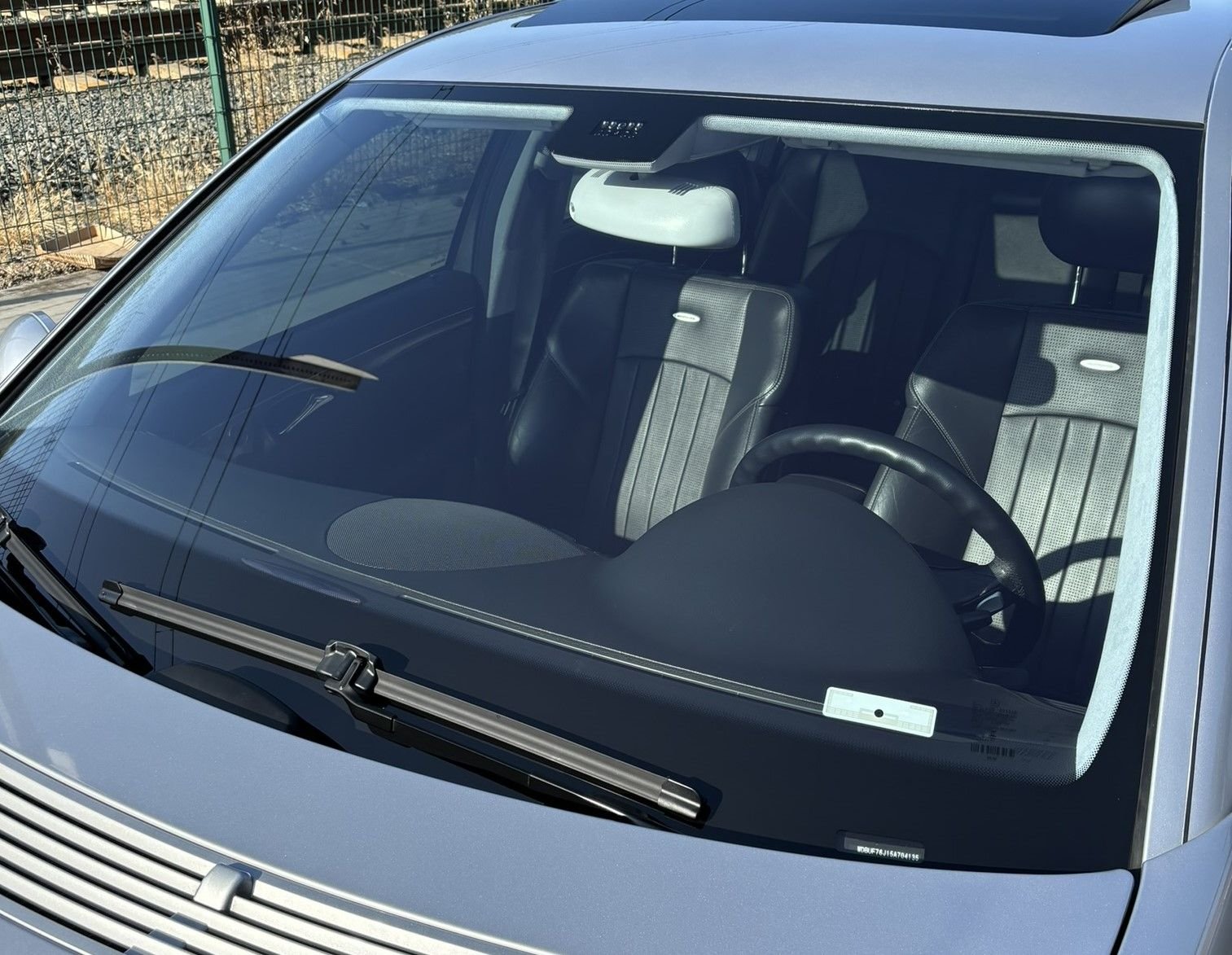

New windshield.
I should have done this a long time ago. What a HUGE difference!
I was able to locate the original AMG Mercedes blue tinted glass. Kinda pricey, but worth it. Also was lucky enough to connect with a glass installer who loves these cars as much as I do. He did an exceptional job on the install. Even made sure the factory "Mercedes" sticker made it in the proper location on the passenger's side and threw in a new set of factory wiper blades to finish the job off proper!
The original glass was covered in hundreds of tiny pits. When the sun hit the windshield just right, it was impossible to see. But this new one is crystal clear. So great!

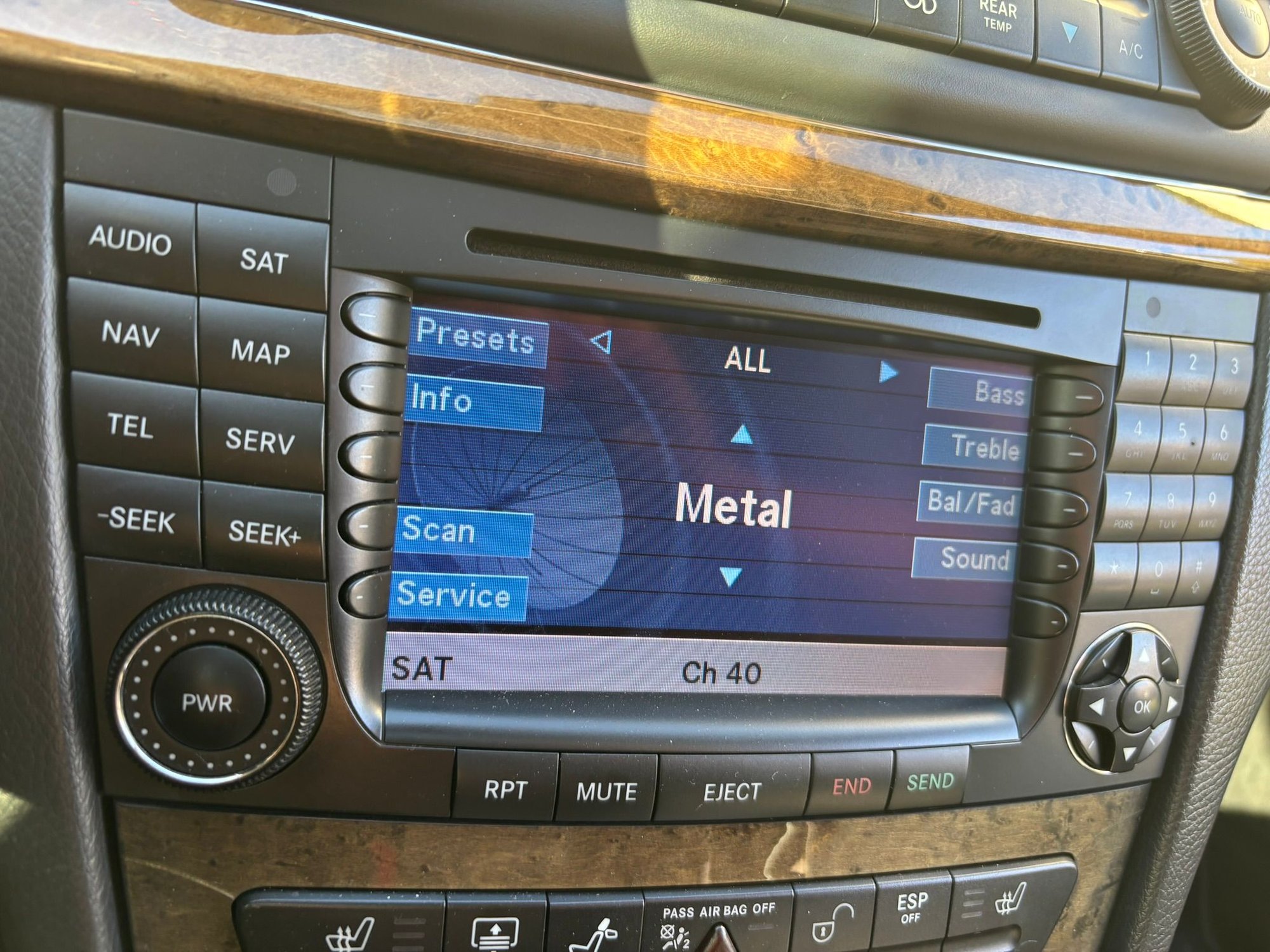

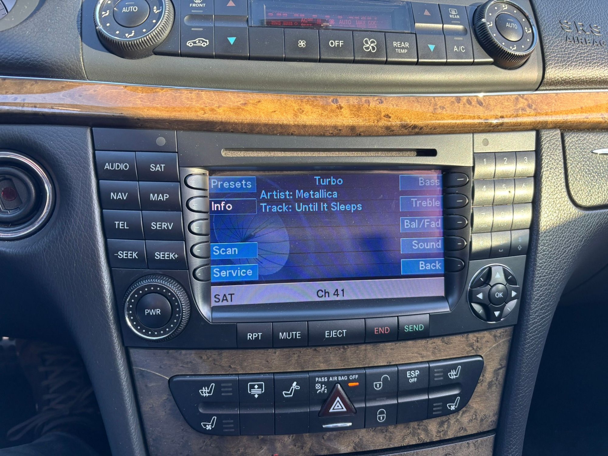

E55
DECEMBER

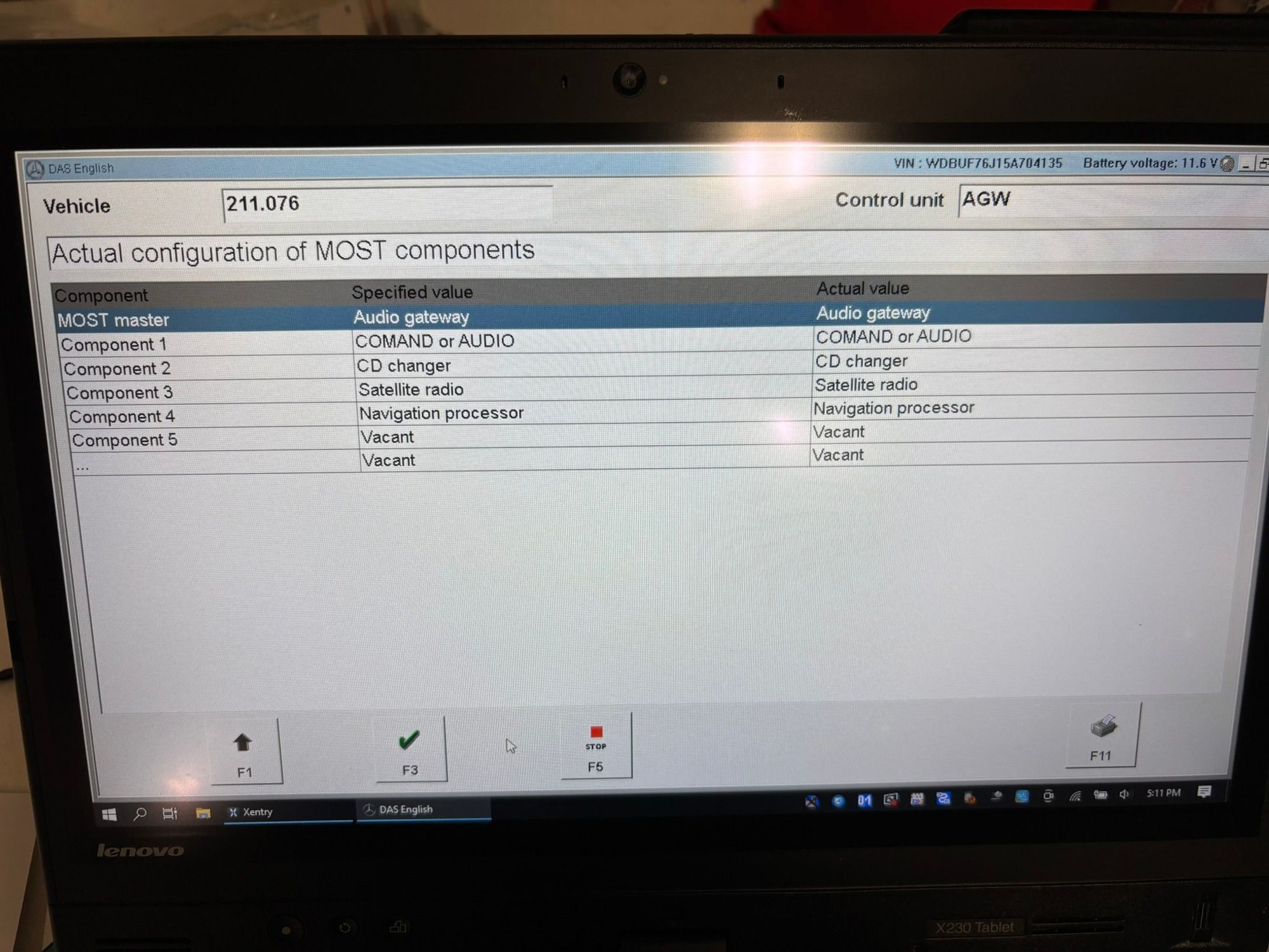

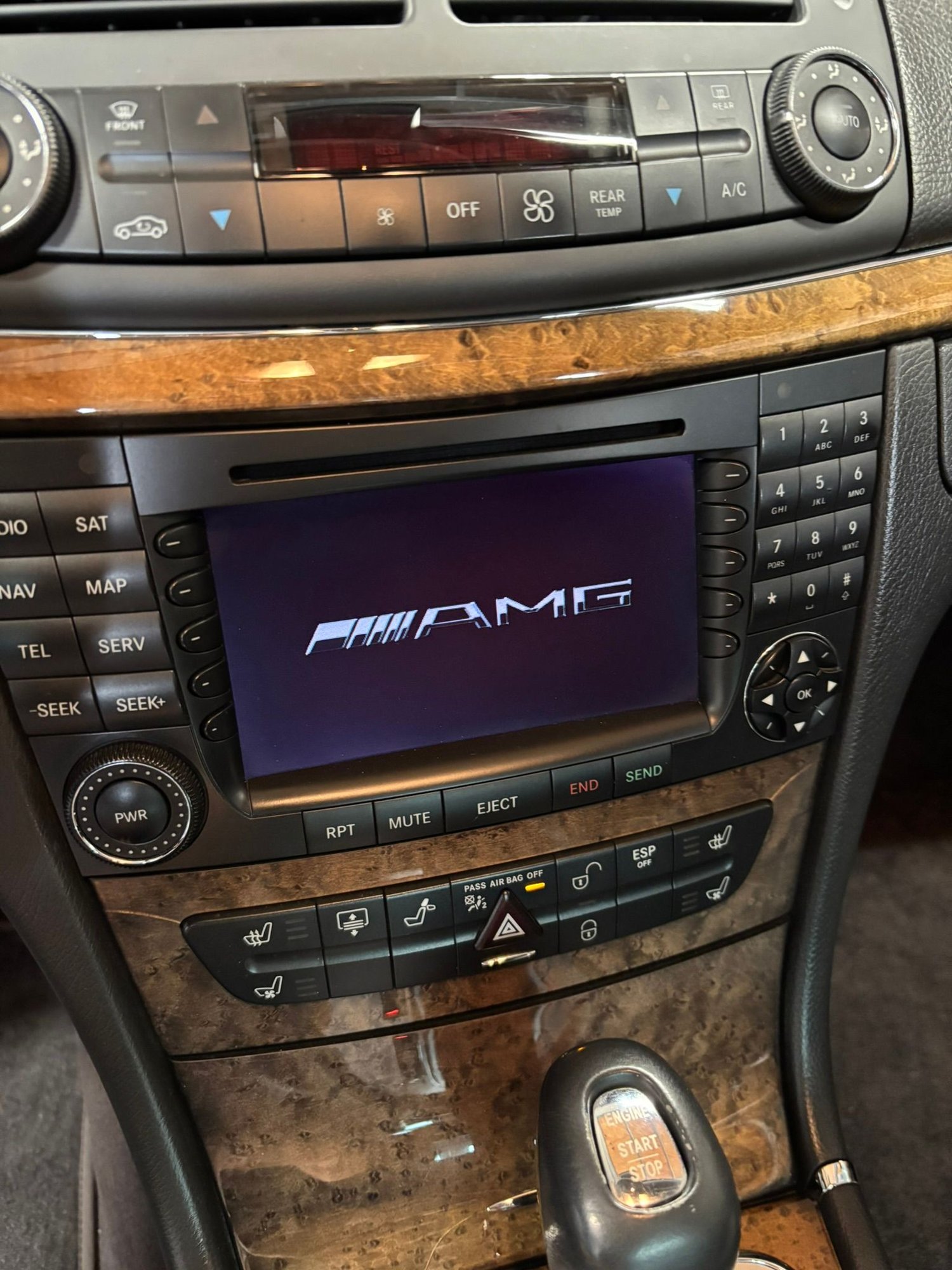

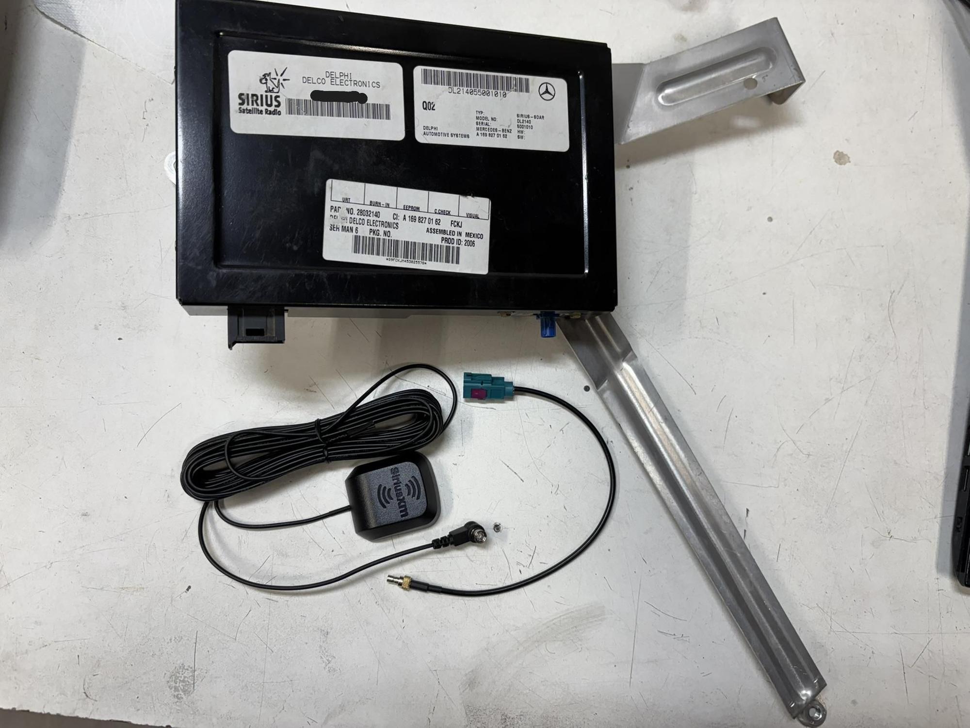

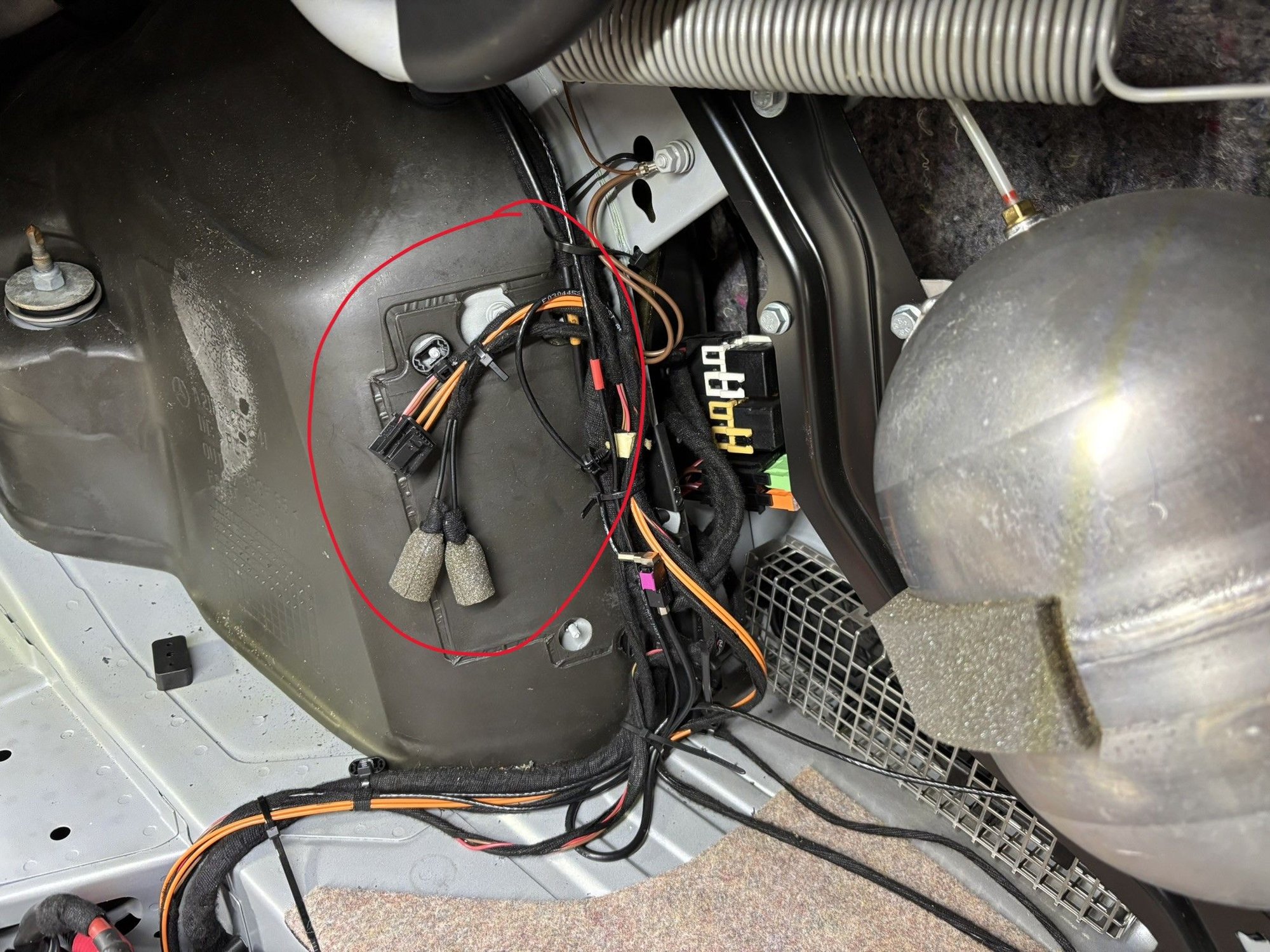

ADDING OPTION 022
There's a button on the head unit labeled SAT. It always bugged me that my particular E55 was missing that option. Pushing the button would say "No Satellite Radio". I have it in my other cars, and it's kinda nice. Wonder if I can add it….
After a little research, I discovered that some of these cars are "pre-wired" for Satellite Radio. I took a look at my car after taking the trunk apart and I believe I see the wiring right here:
OK, so is it as easy as finding a factory Mercedes Satellite Radio module and plugging it in? Ebay, here I come!
I found one from a 2006 E class (only 1 year newer) so I figured I'd take a shot. And I lucked out, it came with the bracket too. I picked up an antenna with an adapter so I could plug it in to the Satellite Radio module that I just bought:
The pre-wired part means the power/signal wires (copper) and the communication wires (fiber optic) were already there, terminated in a plug that goes into the Satellite Radio module, but the interesting part about all this is that the fiber optic cables aren’t connected to anything and they have to be added to this big fiber optic loop that's already in the car. The CD Changer, Navigation, and probably some other stuff are already part of this loop and the head unit can see all of them, so if I can get my new Satellite Radio module inserted into this loop, maybe I'll be in business. This was actually pretty fun.
The fiber optic cables are already in the right place to be added to the loop. You just have to undo a couple of fiber optic connectors and add this component to the loop. Very overengineered, but awesome at the same time!
After bolting up the bracket/module it where it belongs behind the air suspension reservoir in the passenger side rear corner of the trunk, it's time to plug it in and see if the car can "see" it. Fired up my STAR system and poked around in the Audio Gateway control module. The car could see that there was now a Satellite Radio component in the loop, so it was just a matter of "adding" the component to the configuration of the "MOST" (no idea what that means) to make it permanent.
I stuffed the antenna into one of the vent holes under the rear tray behind the back seat for now. Now, will it work? I gave Sirius a call and added the Satellite Radio module serial to my account.
HELL YEAH!!!! SUCCESS!!!! Works like a champ.

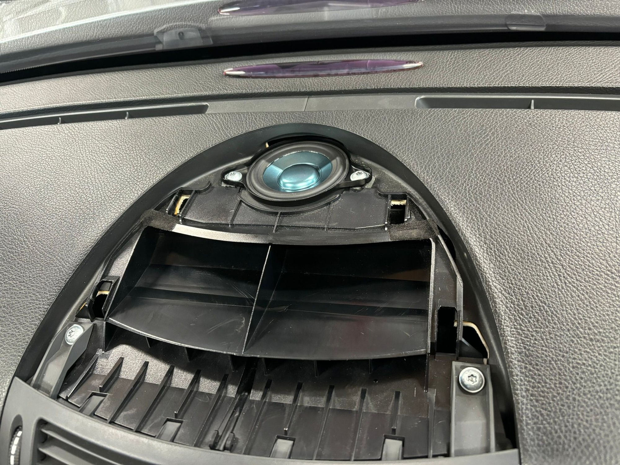

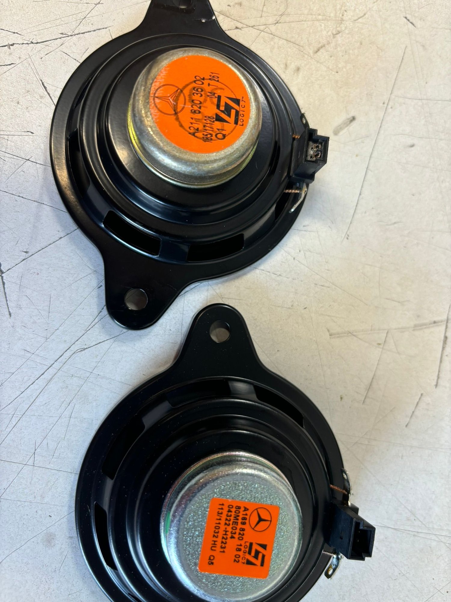

2025
FEBRUARY

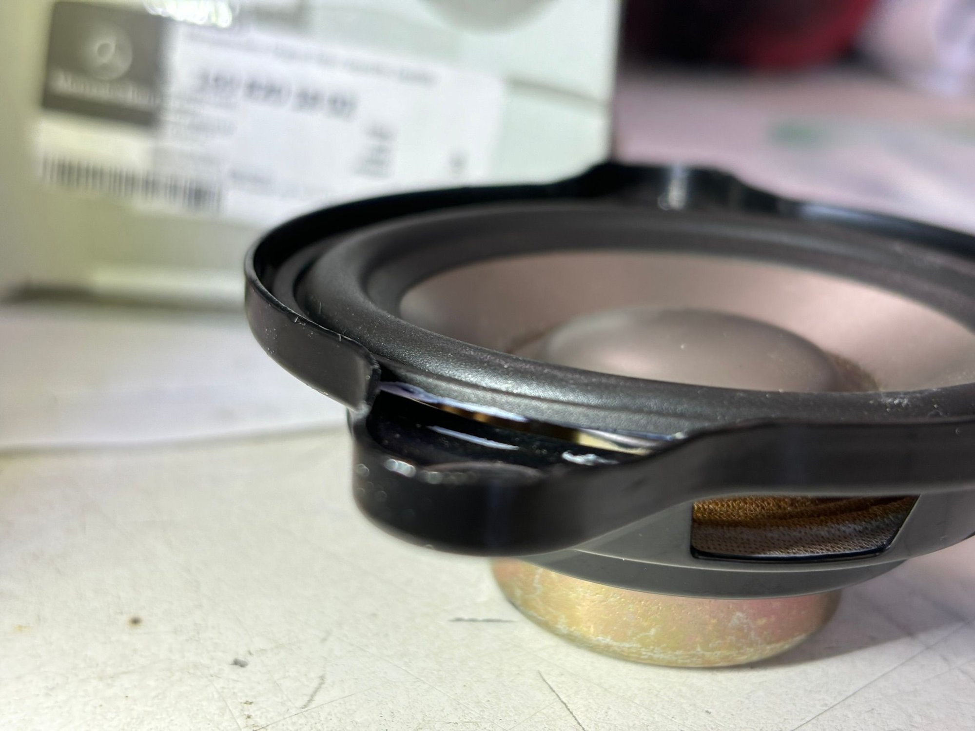

Replaced this center speaker:
The 20 year old one was just not right. The sun probably did it's thing to it over the years and the suspension was completely separating from the basket causing it to buzz and rattle.
Luckily, they're still available at the dealer! New one vs. old one below (part number is visible if you're interested). The new one is on the bottom.

Originally Posted by MetalE55
2025
FEBRUARY
Nice work man! Oddly enough the speaker just to the left of your ear, when your sitting in the drivers seat gives off an annoying rattle/vibe in mine. Been thinking of replacing it.

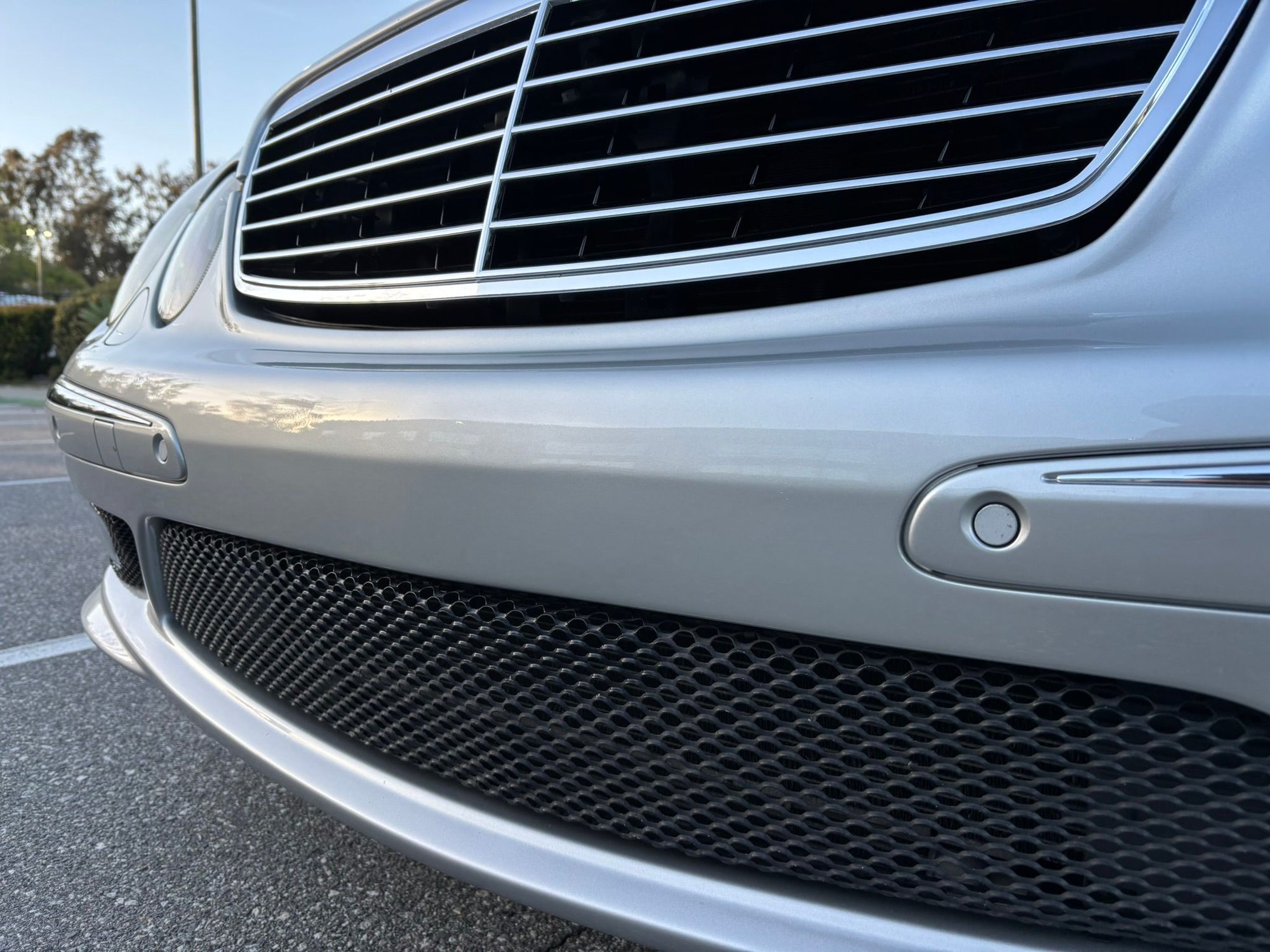

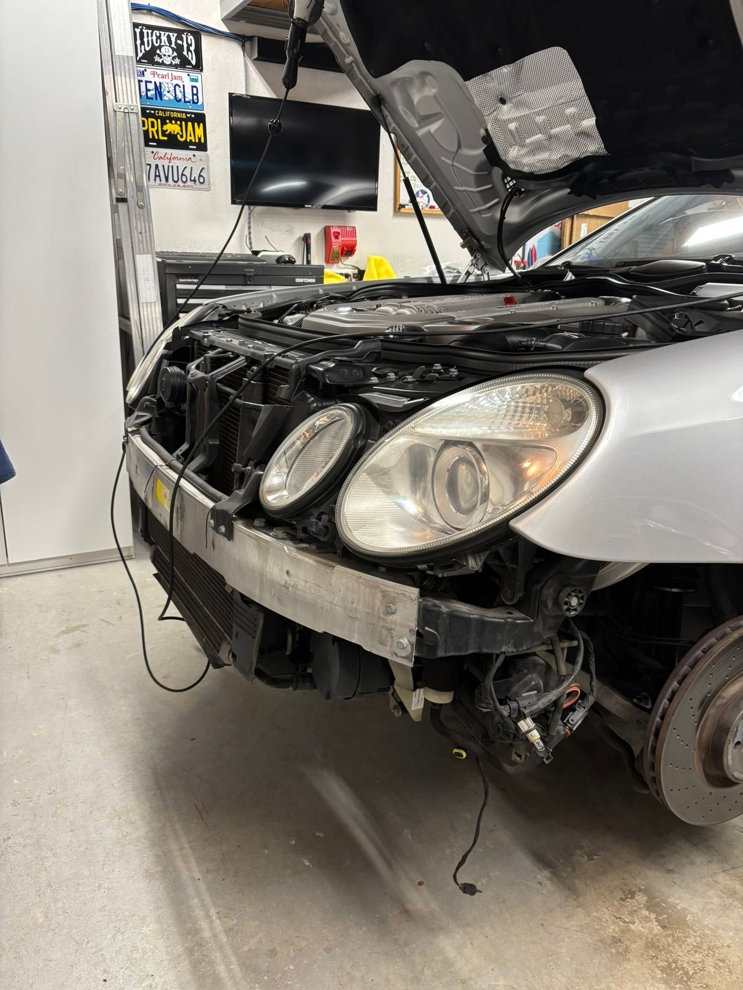

Oh no, what happened to the SpeedSled???
I have to admit that I made a mistake. If you look at pictures in prior posts, you'll see that I messed up and continued to run a front license plate after I got a fresh paintjob on my bumpers.
That was dumb.
The front plate started bugging me lately. Even though you're "supposed" to have one here in California, it just doesn't look right on this car (in my opinion). So, time to do something about it.
Bumper off, back to the paint shop. Same place that sprayed them for me originally. Had them fill the holes and re-paint.
SOOO MUCH BETTER!!! I'll risk the ticket!
While I had the bumper off, it was a good time to:

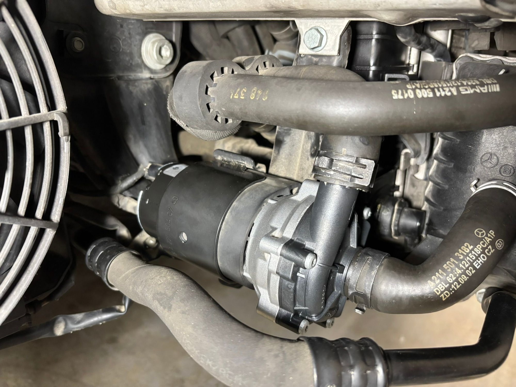

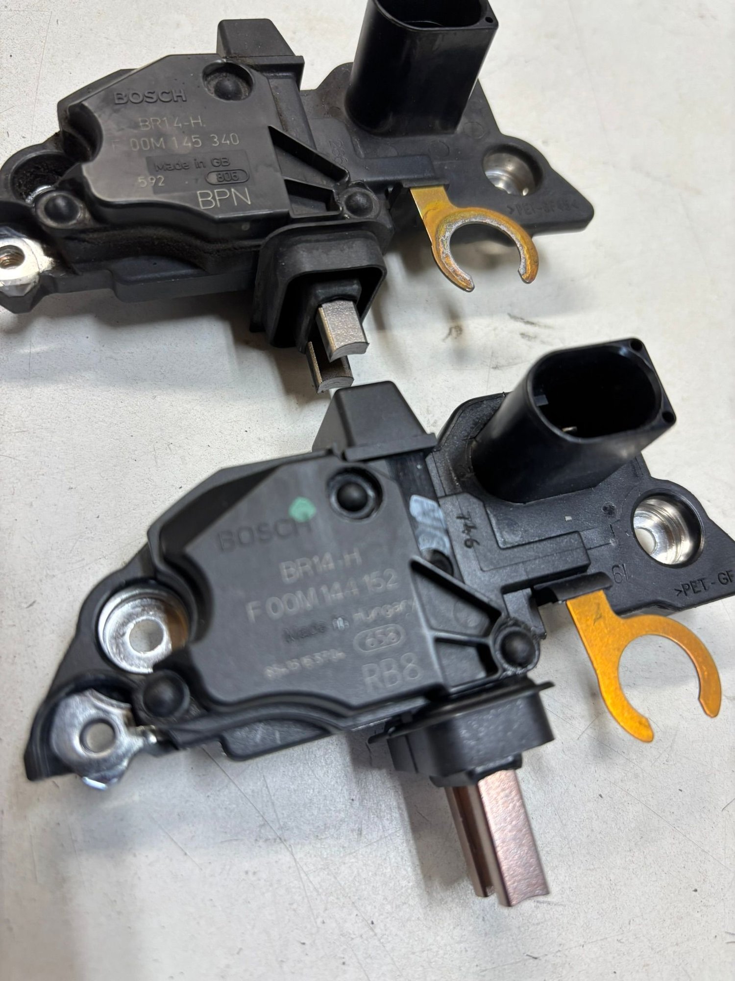

New voltage regulator. Old one is on top. Not desperate yet, but getting there. Easy swap.
Upgraded Bosch 010 intercooler pump. With the bumper off, this is a simple replacement:
Replaced air suspension compressor filter. Another simple one while the bumper is off.
I might have just made myself an easy target for cops, but hopefully the SpeedSled still blends in as "just another old E-class" and doesn't draw a ton of attention with the omitted front plate.
This probably wouldn't go down very well, but "officer, you're pulling me over for no front license plate? Have you seen a Tesla lately?"
Anyway, I think it looks WAY better this way.
