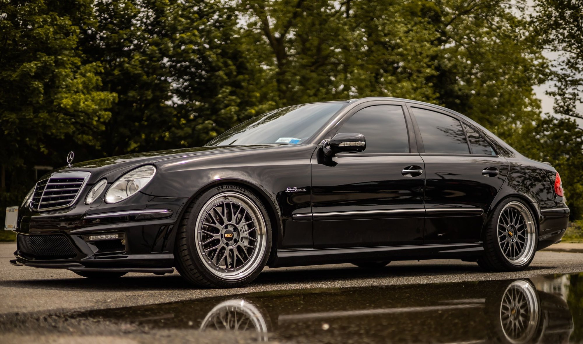

I have 19" BBS CH-R and love how they look. Front are 8.5J 32 Offset on 245s and rear is 9.5J Offset 35 on 275s. There's absolutely no rubbing, since I had to test this wheel setup for rubbing for our German TÜV, when I swapped my suspension for coilovers. The 19s are lighter than the 18 inch oem wheels as well.
