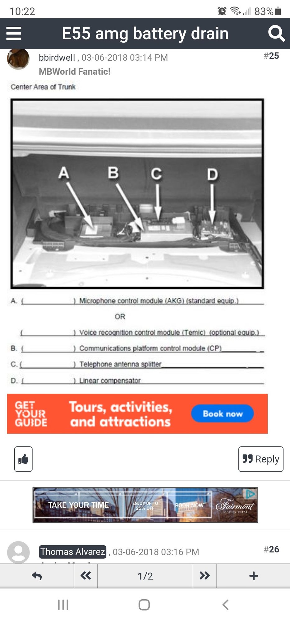

Armed with that information I messed around for a long time trying to open the plastic cover over the microphone control module, Communications platform control module, telephone antenna splitter and linear compensator. After what seemed like forever I was able to see how the tabs worked and I got the cover off. I found that removing the power cable to the back side of the Communication platform control module (CP) the draw went to zero. Removing other connectors connected to the CP module did not affect the readings.

Leave the CP module unplugged. Code the system out using STAR. That is for the old analog cell phone which is no longer compatible with the more recent digital systems.
Unplug and remove the alarm module. Replace if possible. You will get an error message in Star but it should have no effect on the car. It takes maybe 30 minutes.
