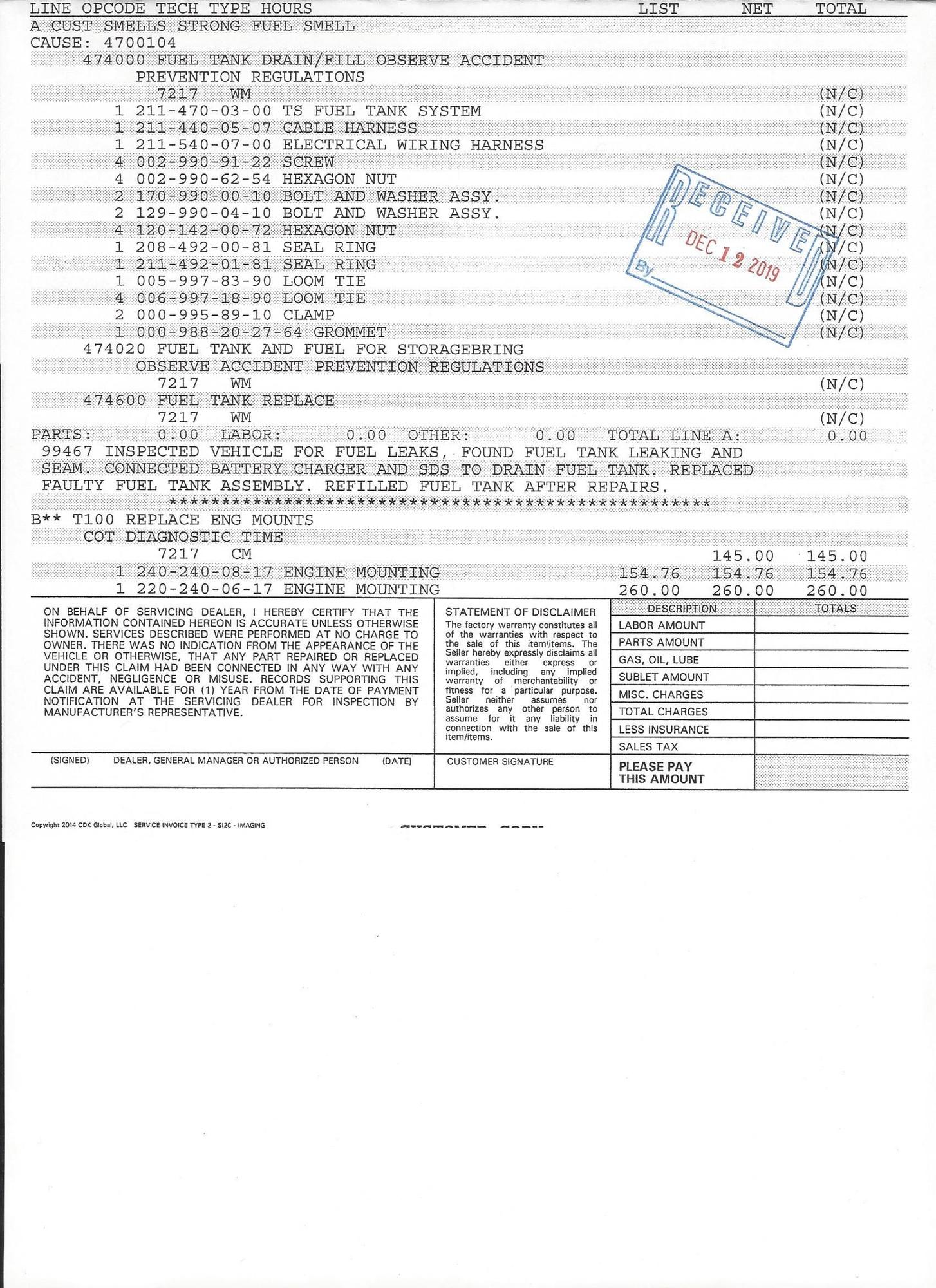

I had mine replaced under warranty. Here is the parts list and work order. Ignore the engine mounts as I had them replaced at the same time.
Hope this helps!
