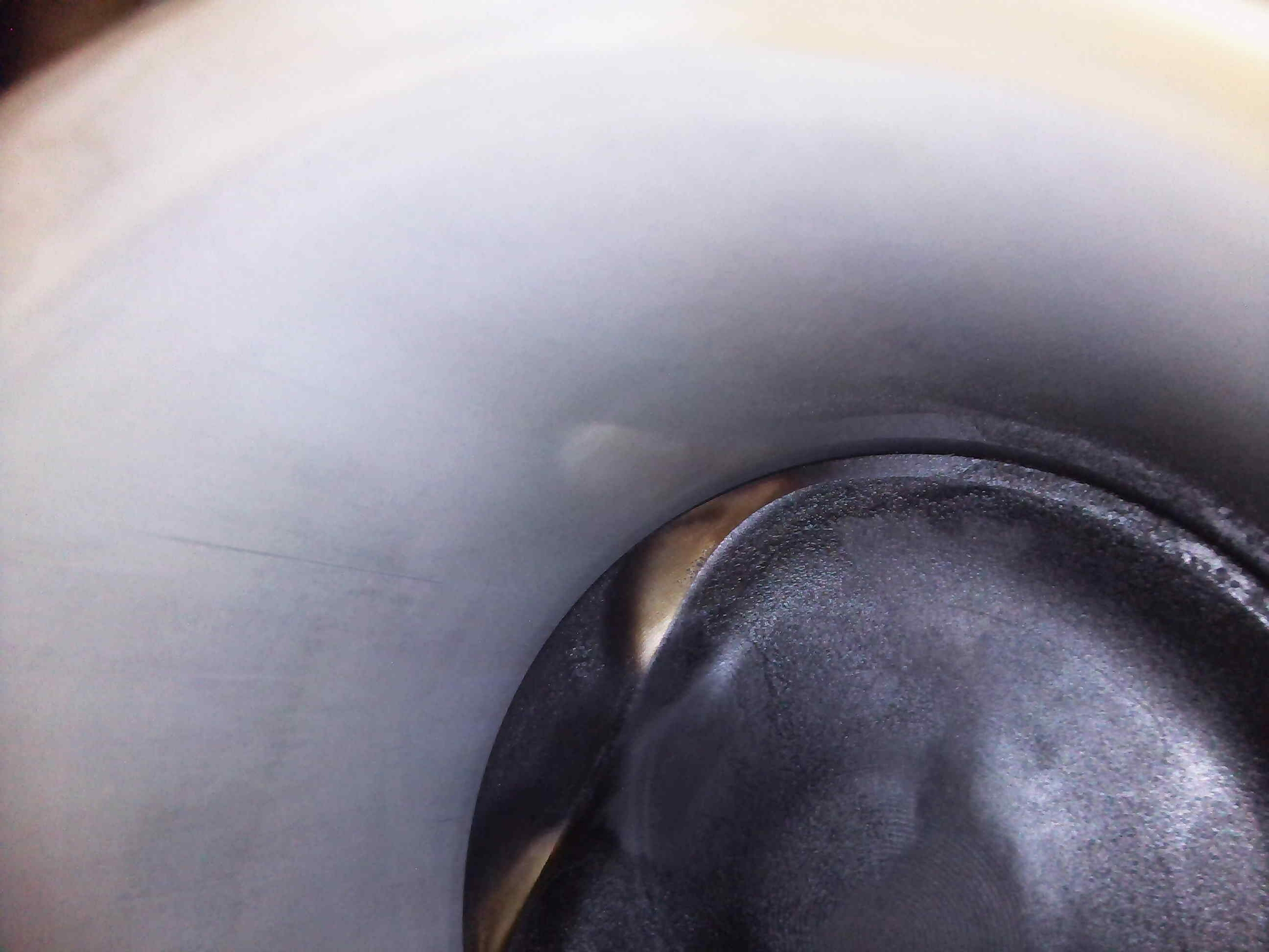

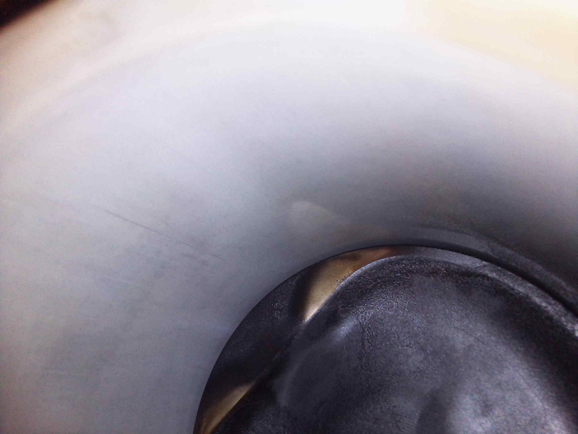

Unfortunately I have bad new's, or not.. I'll definitely need your advice..
But I think I blew the engine... I have a small scoring on one of the cilinder walls, it could be caused by some dirt...also.. but definitely not good.
I will attach a picture with the damage.
Also on that cilinder it's giving me 100psi( it was quite of a stupid compression test, only removed the coil packs and crank
it for a little bit.
What should I do, should I start saving money for re-sleeve the engine? I had this planned anyway.. but not so soon.

Did your plugs have oil on them when you pulled them? I would do a compression test just in case, but if they didn't have oil on them the scoring is probably ok?
