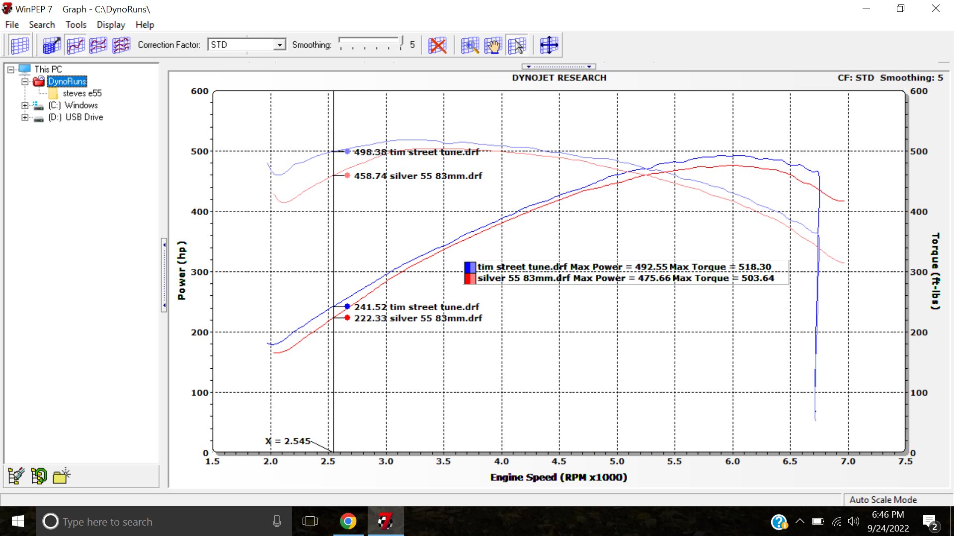

my stock pulley car and a car with a 83mm on the same day.

Thanks for sharing the graph. Was interesting to see how the curve is on a stock engine.
Mine has some bolt ons and different cams and you can see the difference of the curve itself.

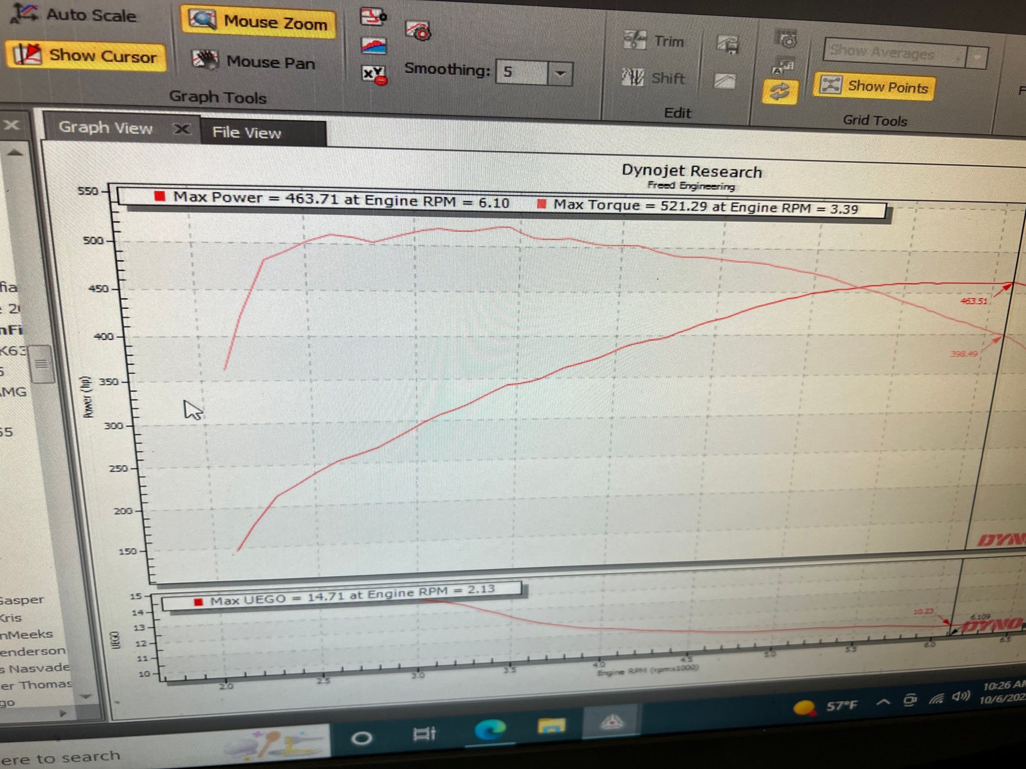

Pull 1:
I’m very happy with the results. A bit rich, but I guess a box shelf tune is safe for a reason. Mods in sig, I knew this car felt significantly stronger than my prior 06s right off the bat when it was stock…

Yep, damn near right on the money with your mods and tune. ~10hp more than mine w/ similar mods: https://mbworld.org/forums/c219/7351...ml#post7760964

Second pull was 468/542 but spun a bit - this car is a monster.

Get a good set of longtubes and call it a day: https://mbworld.org/forums/c219/7351...ml#post7784990 the 83 pully will help keep the IAT cooler w/o having to go nuts with cooling mods. My build I tried to make as much HP/TQ as possible w/o having to increase too much boost.
