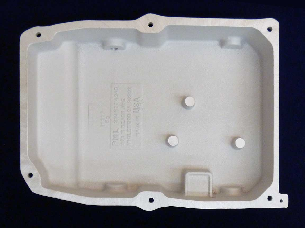

The transmission pan from VRP's link looks similar to the PML 11117 pan. See below:
https://yourcovers.com/pml-chrysler-...ssion-pan.html
If that is the case, the pan should have a step/ledge for the dipstick to bottom out on. See pic below:
The measurement procedure should match that of the OEM pan if the step/ledge is in place. Instructions and specs of the pan are provided in the link above.

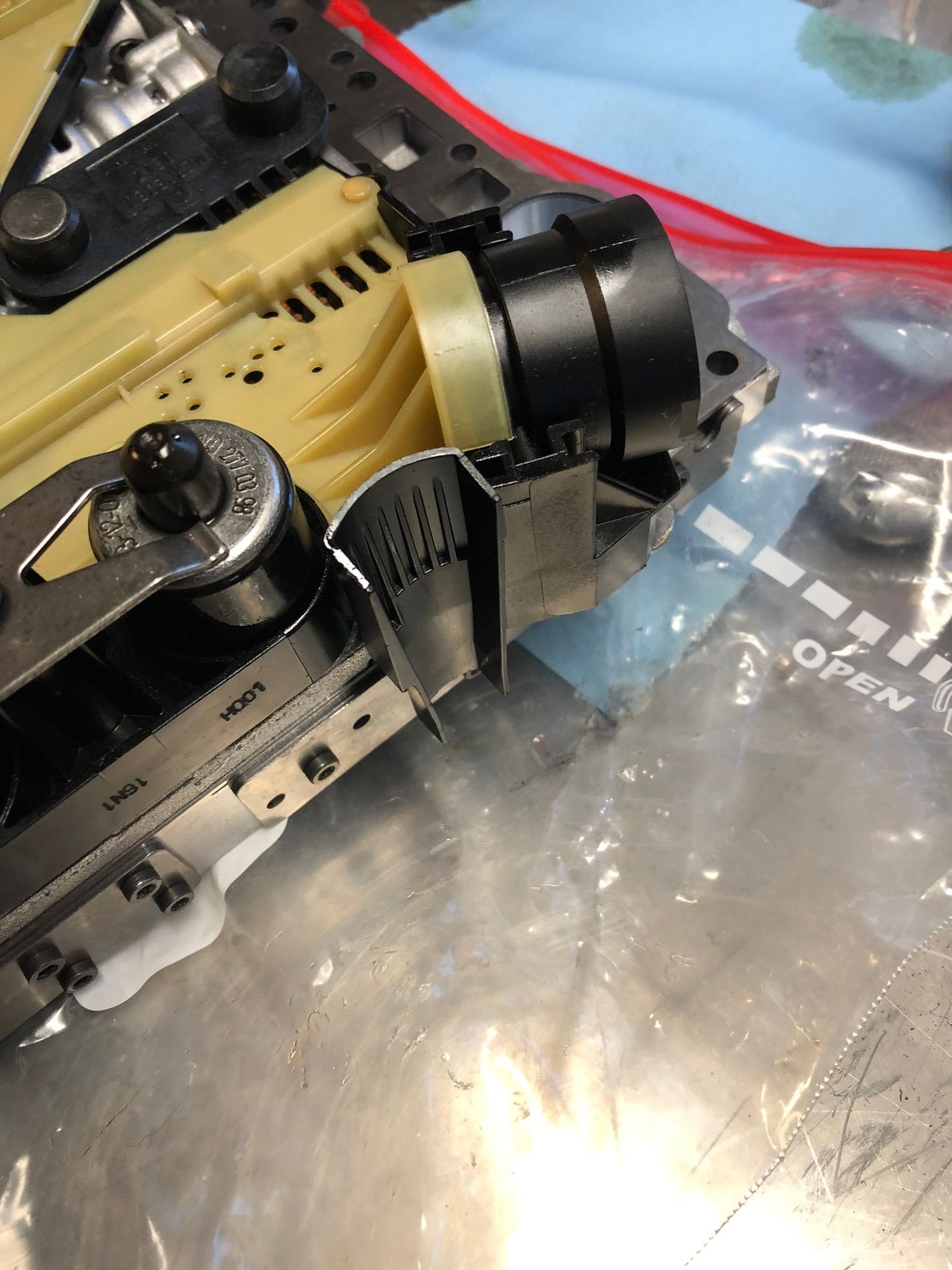

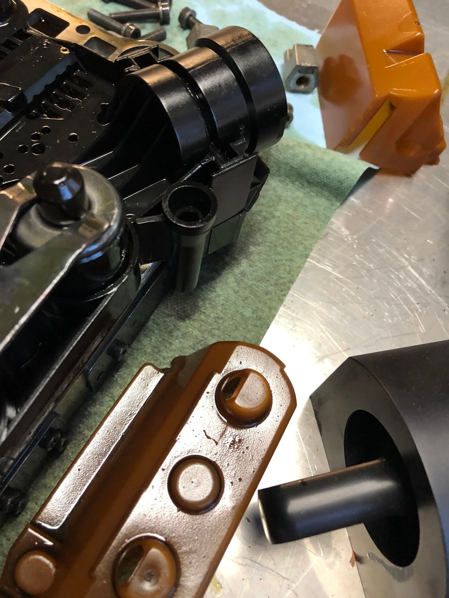

That is not correct. The Mercedes conductor plate has a stop that the dipstick fits into. The fluid level is being measured relative to the valve body, not the bottom of the pan. It is different on the Chrysler conductor plates. I figured this out when I put a Chrysler conductor plate on my Mercedes valve body and the dipstick didn't work.
Long story short, you should be able to use the same dipstick and get a valid measurement; it will just take more fluid to get up to that level in the deeper pan.
