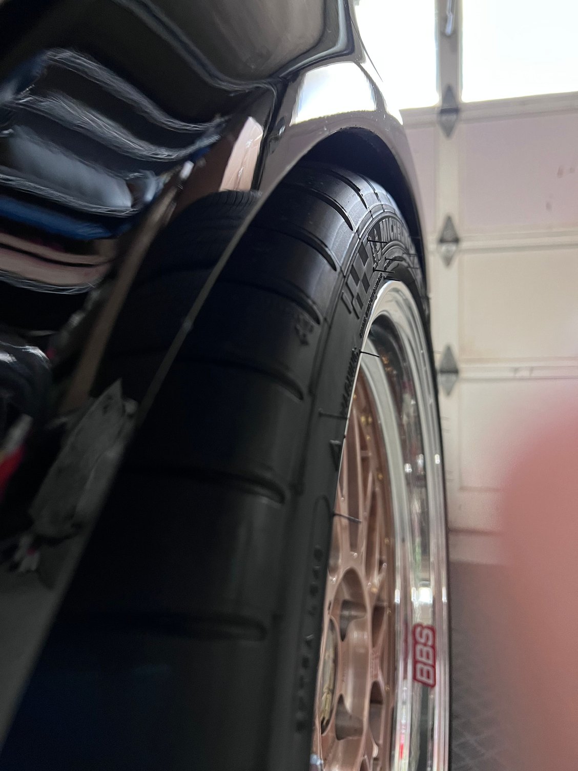

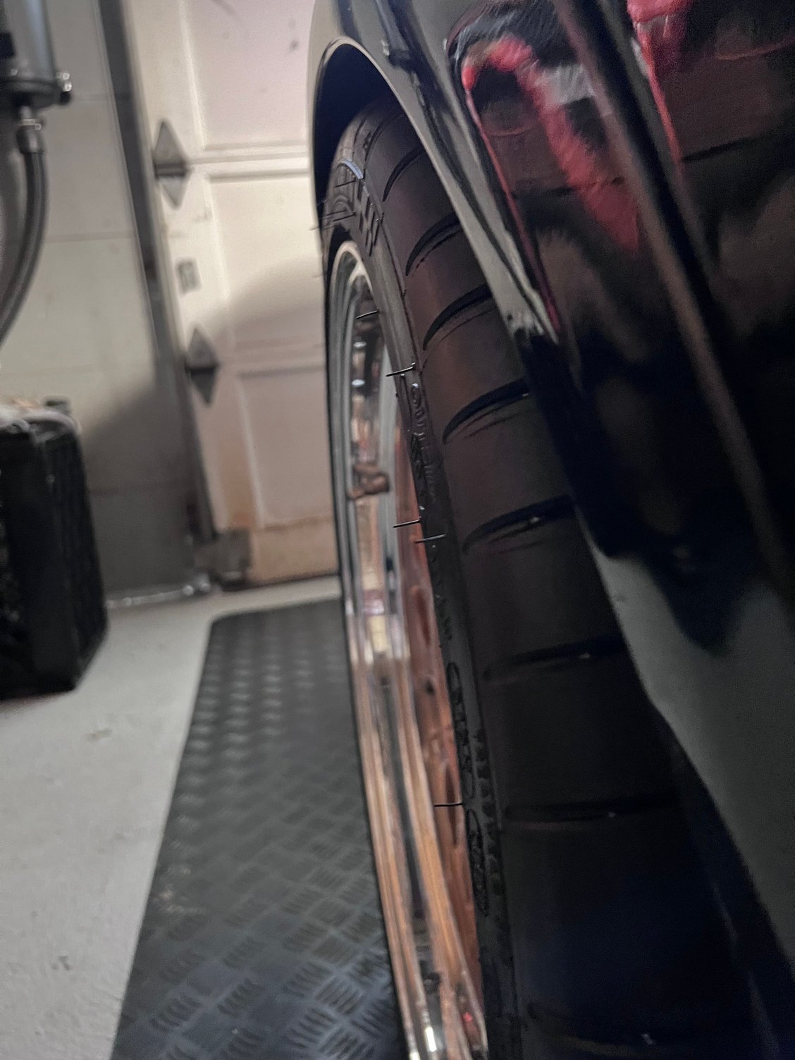

Anyone have any idea why my rear driver side wheel sticks out more than my passenger side rear? It is more noticeable when I put my spacers on. Driver side would rub, while passenger side was tucked in more and never rubbed. I know on the e55’s subframes bolts were an issue. But this is a 09 e63, I don’t think it’s the subframe bolts as I would notice/see it.
Driver side rear:
Passenger side rear:

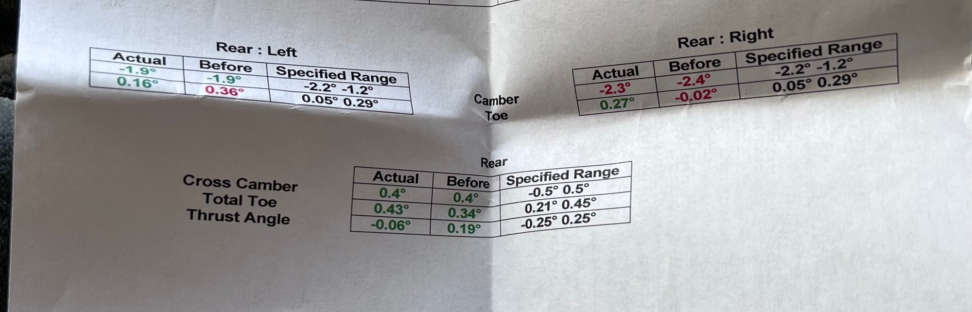

Just got my alignment done, here’s a picture below:
car has never been in an accident nor is there evidence of any body work.
The wheels are staggered but are the same size as bbs marks the wheels on the faces. Maybe some suspension components may be at play or maybe bbs built me a wrong rear wheel
