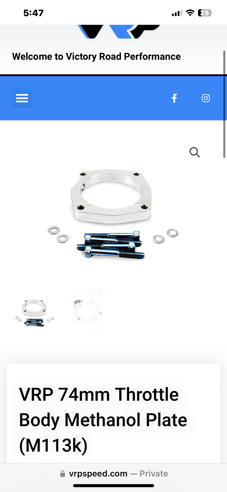

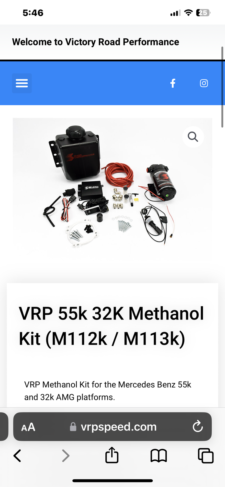

Hi Everyone,
I recently purchased and having it installed a Snow Performance single nozzle with throttle body plate kit. My tuner told me to track iat's and step up the nozzle from there but starting off with the smallest and only running 10-15% meth. This is for cooling only and zero tuning I'm not trying to gain power by using it and optimizing a tune for it just too cool of the iat's if that's possible. I will at the same time do split cooling. Has anyone had any experience running methonal injection and how did it work out? My car is. 04 E55 with the inly mods being 77 clutched pulley, intake and tune with 630cc injectors.
