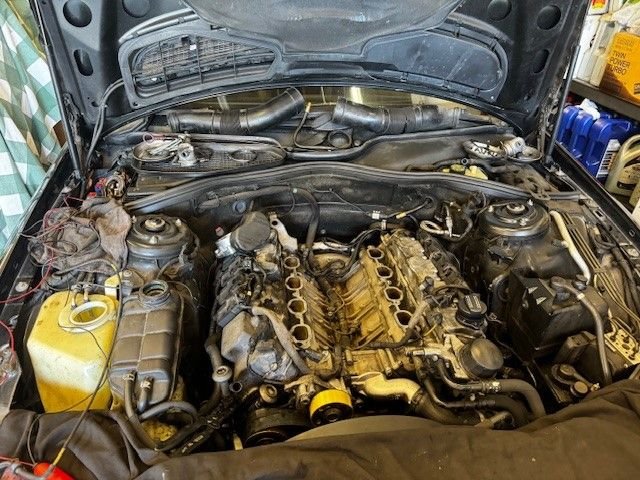

Alright guys today I got the motivation to finally pull the supercharger off and boy was that thing heavy. Here’s the video of how it sounds spinning it off the car :
Now that I have it off it looks like a headache to tear it apart and do the bearings. Should I just get a used supercharger for 850 that I found off of a cls55? Or should I attempt to change the bearings myself so that I can guarantee it won’t go out again in a while. How much would a shop charge to get the old bearings out and new ones in? I don’t really want to pay a shop to do it but if it’s cheaper than a used supercharger I’d go that route.

Yeah it did end up being the supercharger but people on the forums said it’s too hard to change out the rear bearings so I just bought a used supercharger for 850. I made sure it was my supercharger before I bought anything by removing the belt and turning the engine on the knocking would still lightly be there because the supercharger was still getting air to spin but when I’d stop the black magnet from spinning while the motor was on the knocking would go away. At least now you know you don’t need to worry about your rear bearings since you did them. But the clogged oil pump is crazyy! How does that even happen and how often did you change your oil. I do mine every 3k miles with liquid moly. But I don’t know how often the last owner would change it. And are there any issues with your car knocking now?
