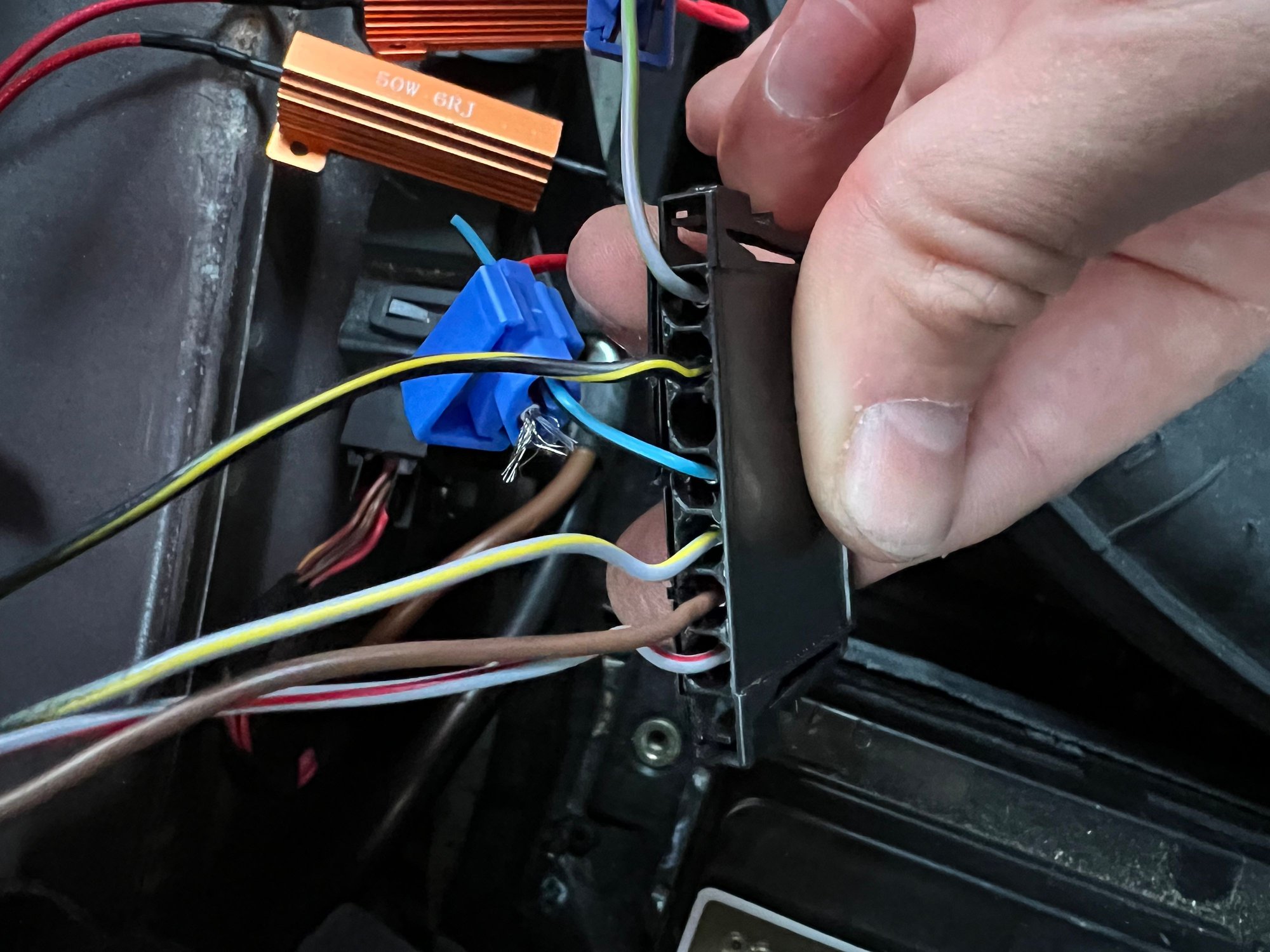

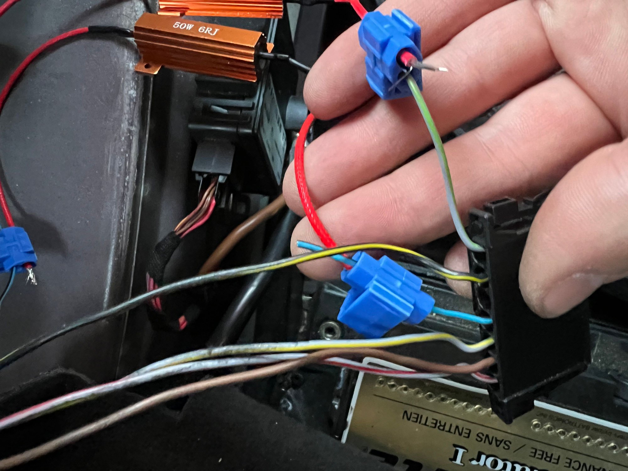

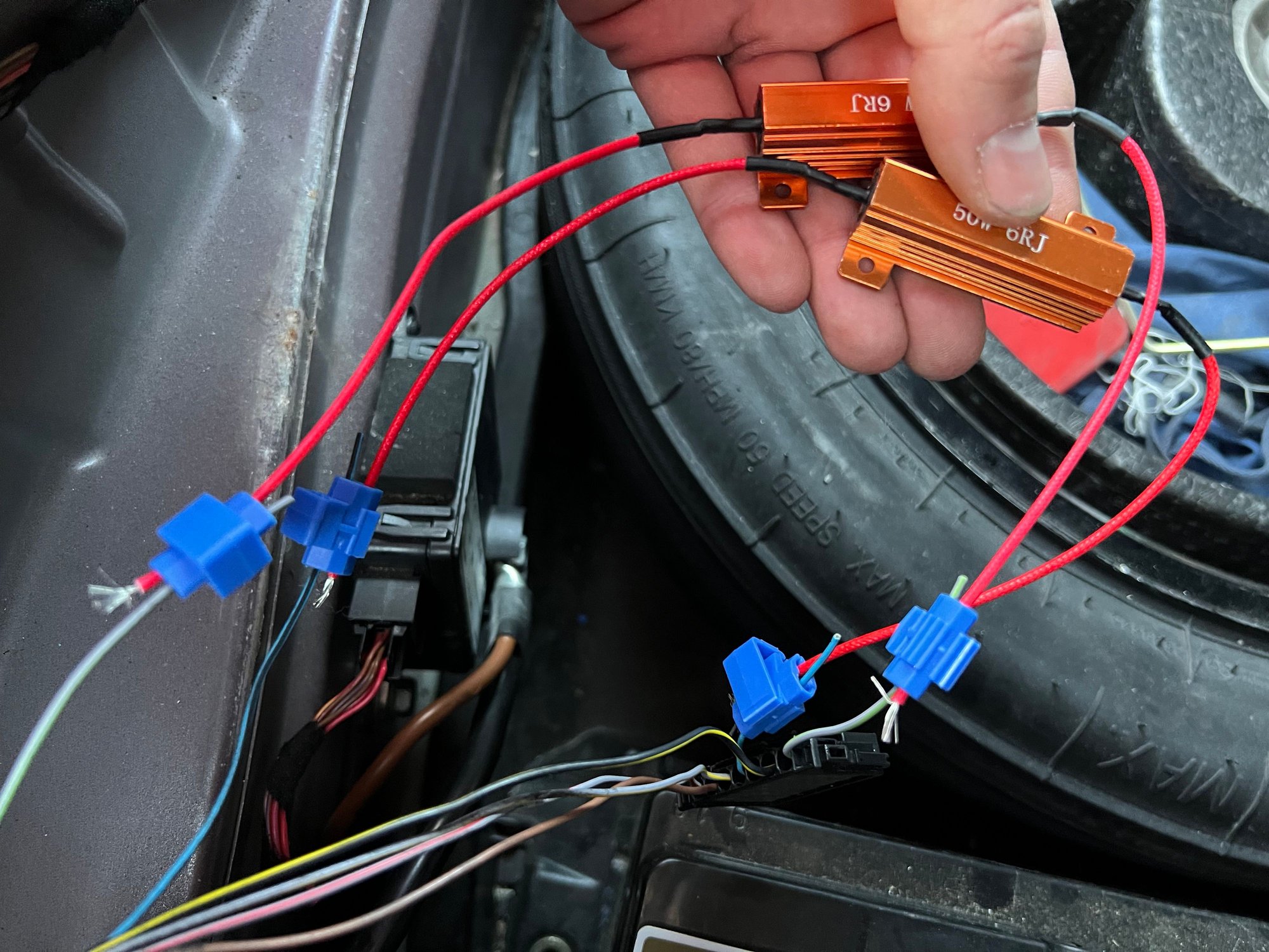

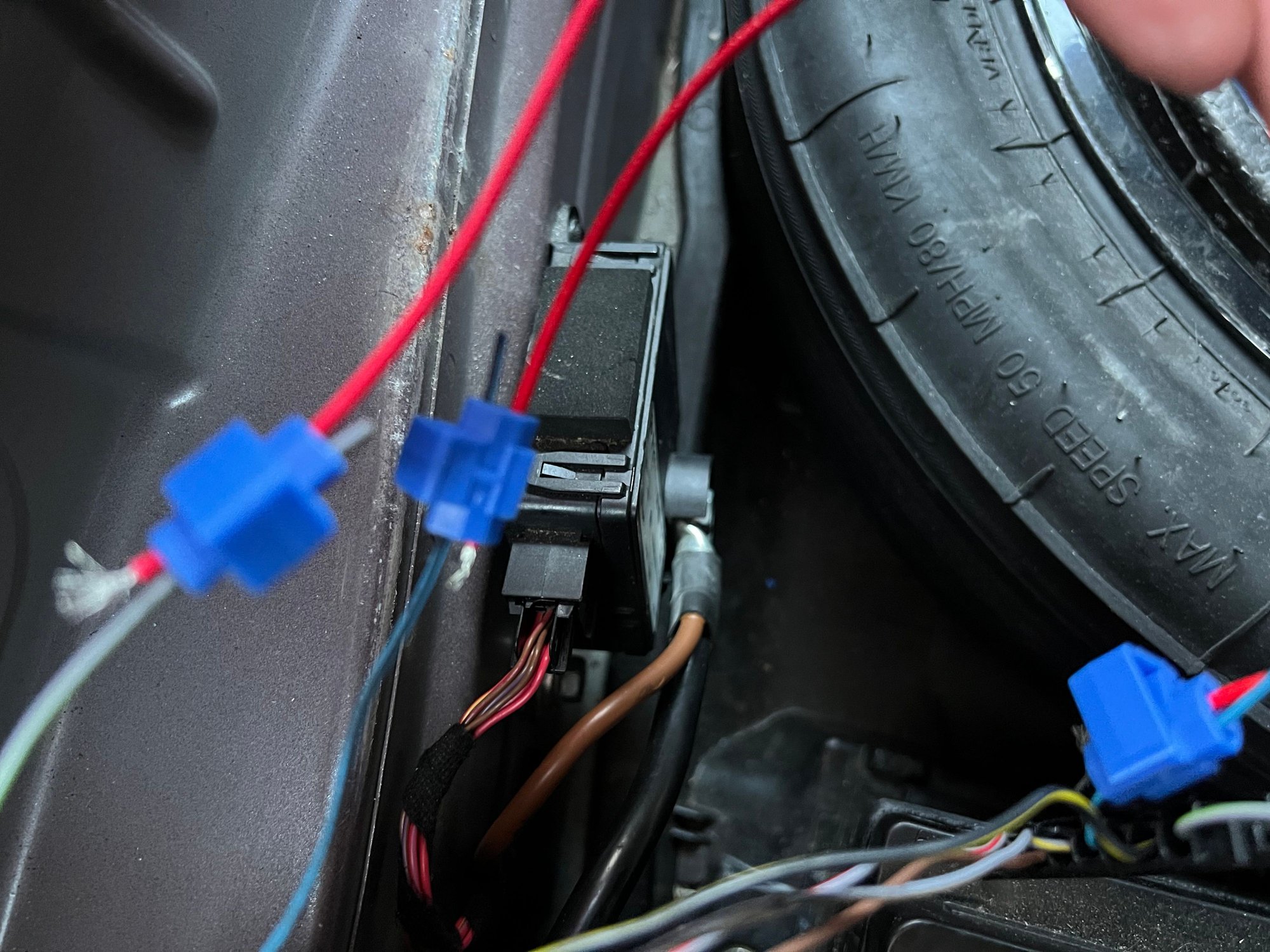

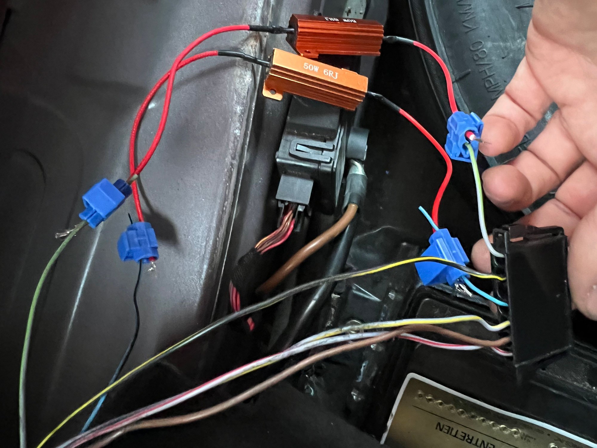

I’ve got a 2006 cls55 amg , purchased brand new oem tail lights from Europe. This is a Canadian spec cls55. Just in case that makes a difference.
Followed a guide posted that’s supposed to work.
you move the oem pins around, and add resistors and it apparently worked for others.
Everything works other then my passenger tail light.
shows as turn signal error on dash board , hyper flash on dash while tail light has slow turn signal light that’s intermittent.
Tried replacing both passenger side resistors, still doing the same thing.
did I possibly connect the 50w 6ohm resistors incorrectly ?
guide shows as needing 1 50w 6ohm resistor at the turn signal wire and 1 on the main lights.
Maybe I misunderstood or installed resistors incorrectly ?
