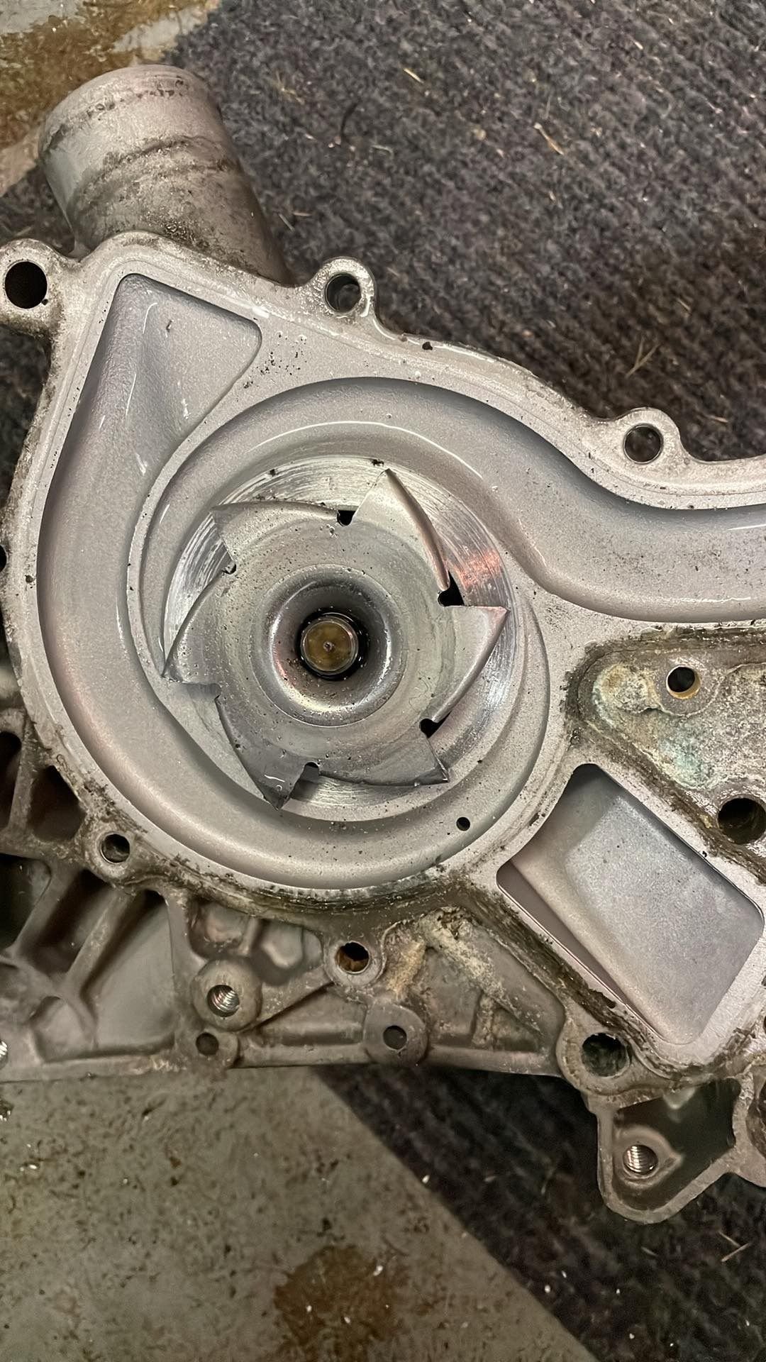

But now I had a strange sound coming from the engine, and when I popped the hood the water pump pulley was wobbling and making noise. I assume the water pump is bad and needs replacing.

This is what the water pump looked like;
