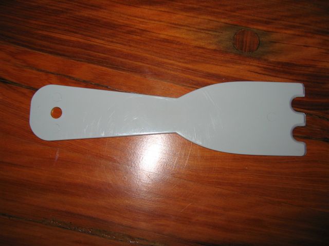

its late at night. i'm frustrated because i couldn't figure out how to get the bumper strips off from my stock E55. i should be studying for my test. the body shop wants $150 to take the bumper apart and put it back together to do it for me. seems a bit intrusive and hints that they don't know how to do this. and the dealership won't do it because they won't do anything that is not standard.
other posts say i need a special wedge which can only be ordered from glass specialty stores.
there has to be a way....
i give you the tool. it costs $29.99, and if you want the family size one, it costs $49.99. drum roll please....
oh, and it comes with a george foreman grill. it's the grease spatual that comes with every george foreman grill to clean the grooves after you cook. its very slick plastic, bendable, but hard enough to not give too much. also, i did not have any fear that the paint would be damaged at any time in the process.
it slides in the top and the bottom of the standard bumper strips by the parking light to unlock the latches there quite easily. then the rest is an easy task. just slide the stock one out (take care of the light), and slide the new one back in. (i'm simplifying the light issue, but i need to get back to studying). whole process took 10 minutes for both strips.

i was able to pop them out with a screwdriver with a cloth on the tip so i wouldnt scratch anything. worked fine
