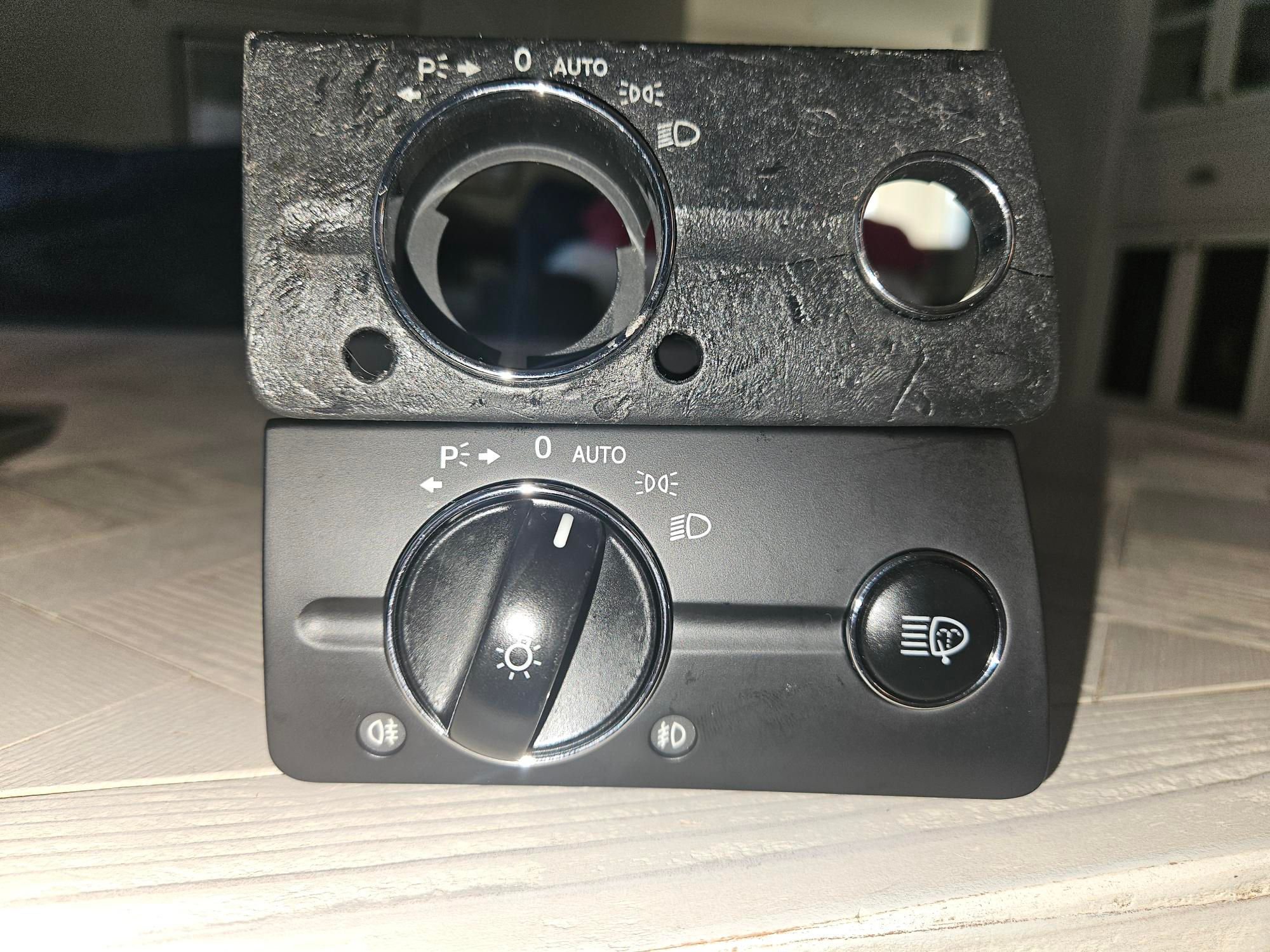

I hated the smudged graphics on my '09 E63 headlight switch and of course no new replacement available. The local salvage yard always has E class wrecks and I was hopeful to find one. Amazingly, they had a recent arrival '09 E320 and I proceeded to check it out.
The donor car had a front end impact but the car overall presented very nice. The shifter handle and other wear items were great. The R&R wasn't too bad and the pics show the two side by side. I'm pleased with the swap and feel fortunate to find a pristine switch for $13. I also snagged the driver's side impact door trim for $4.

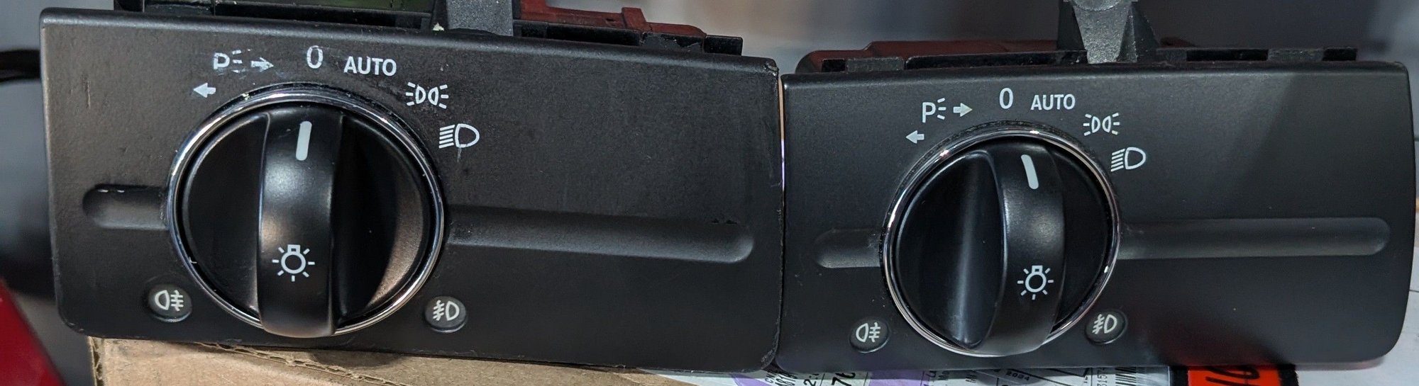

Another happy buyer of the Goodithy faceplate (
Amazon Amazon
The best Youtube description of getting the headlight knob out is this one:
The only thing I can add is that the knob needs to be in the 'headlamp' position (fully clockwise), with the knob pulled out 1 (not 2) stops. This best exposes the barbs that have to be levered outwards.
Before and after:
