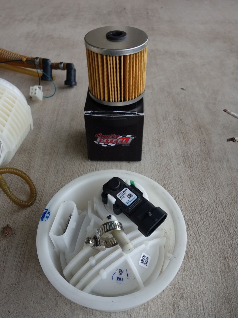

If you have to replace the fuel filter, do the whole kit and kaboodle. Seriously. Expensive but you eliminate any potential issues from overlooked parts or broken lines. And the cost for fuel filter/pressure regulator plus dual fuel pumps is approximately $1000. Now is the time to decide if you can afford and want an E55 AMG. I'm not being cruel; I'm being realistic for you. An AMG is an expensive car to maintain. I've learned this lesson over and over and over again through the years...
If you really want the AMG, and are willing to pay for it by performing as much work as you can yourself to save the labor charges from the shop, go for it!
FWIW, the filter is available from Creative Steel if you decide to attempt filter replacement only. The fuel filter/regulator top is very difficult to rotate so you will most likely need a vise. I recommend silicon lube on the o-ring when you reassemble the top to the bottom.
Best to you. Seriously.

yeah I gotcha you make a good point. Definitely not bringing it anywhere though I can do it myself. Got the pressure gauge a little bit ago so I’ll hook that up tomorrow and see if it’s fuel at all.
Thanks for the tip for the filter only. It does occasionally leak when filling full so I’ll end up doing the whole job if it is fuel related. If not I’m due for a filter change so might see how far I get with just the filter. Hard to swallow but part of the life.

@Orznick14 if you find you need a MAP sensor I happen to have a couple of new ones that I can pass one on to you for the cost of a shipping label. Send me a private message for details if interested.
