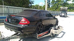

2003 E55 the rear wheels are wearing on the inside big time I have 2500 miles on a new set of rear tires and the belt is starting to show. Car is sitting on BC coilovers is there anything on the market to fix this negative camber issue ....can't replace tires every 2500 miles. The alignment shop said they can't adjust anymore it's all maxed out.
Thank you for any suggestions.

OEM recommended camber range for wheels is:
Front - Negative 1.4 +/-0.3 degrees
Rear - Negative 1.7 +/- 0.5 degrees
If you car is outside this range, get rid of the BC coilovers. If you insist on keeping coilovers, go to the Eibach website and find taller springs that will bring your camber into the acceptable range. Low may look cool but it does not translate into handling or reasonable tire wear.

I purchased it like this, unfortunately all air ride components are removed kinda stuck with what I have. Have to do some research saw something online for aftermarket adjustable Components.
