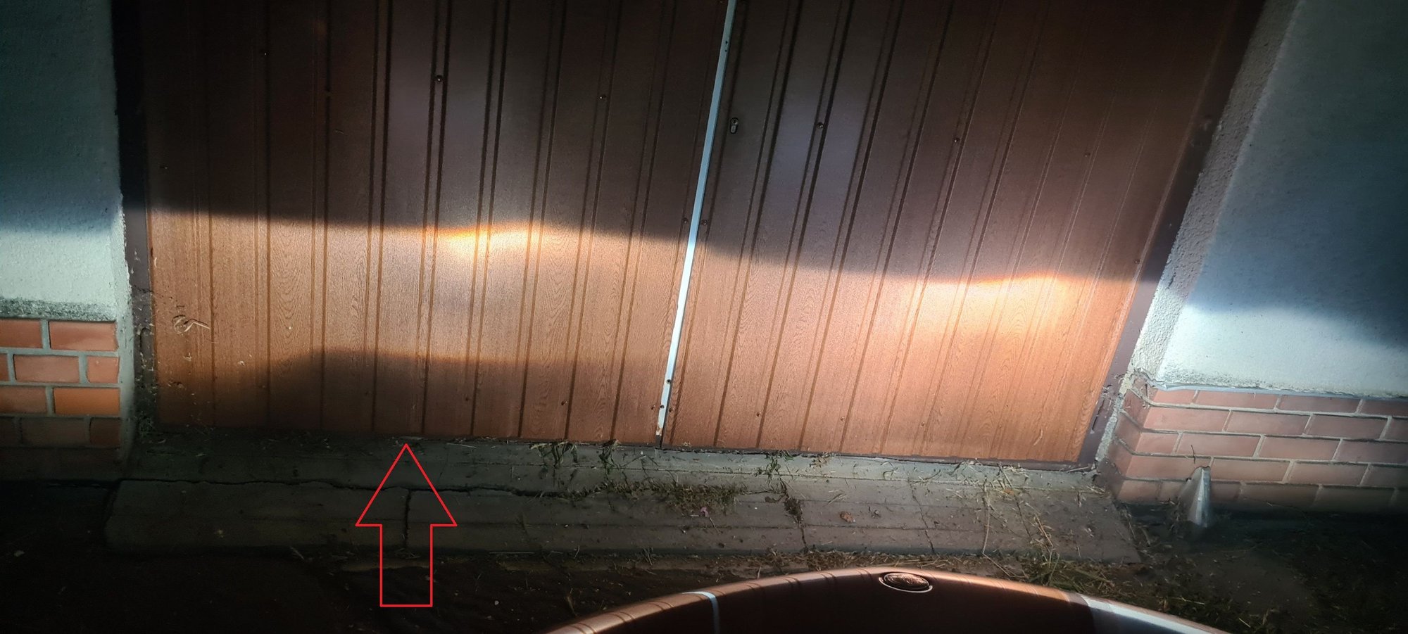

Hello!
I have a 2005 CLS 55 AMG. The headlights have different beam patterns. The left (driver side) one was also less bright. I was planning on painting the inner silver part of the headlights black. I did this change myself over the weekend. When I took the headlights apart, I also cleaned the lenses. The reflector (inner reflective silver part) on both headlights looked good. After reassembly, the brightness increased, but the beam pattern did not change. Is this the factory beam pattern on the CLS, or are my lights not the same? They looked exactly the same from the outside and inside. The headlights are factory bi-xenon with cornering function. All functions work perfectly. The xenon bulbs is also new. I checked the the bulbs position again, but nothing changed.

Thank you for your answer. I understand the problem but my problem is mainly not the weaker brigthness, rather the beam pattern difference. The lower part of the left lamp has no patterned light at all, not just weaker. The silver chrome layer inside the lamp did not appear cracked or incomplete, it looked similar to the silver-plated part of the other lamp. However, the projected image is completely different. The lower part of the left lamp is completely missing, not just dimmer, but there is a sharp cut separating the dark and light parts, as if it were directly like that.

I found a video where you can see the beam of light. Based on this, the beam of light from my cls left lamp looks normal. In the video, the dark and light parts are also sharply separated.
