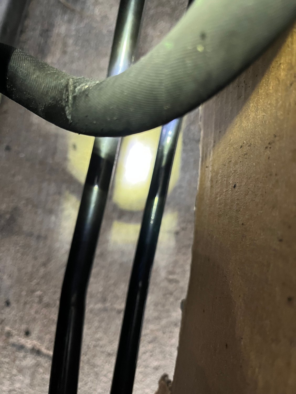

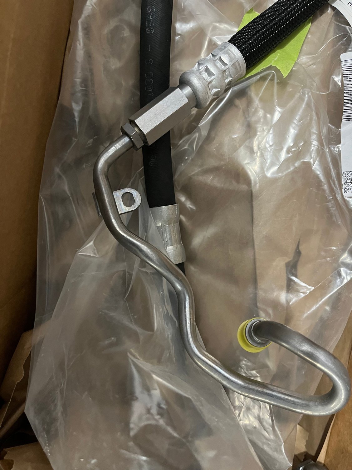

I need to replace the power steering hose which runs in front of the radiator, which appears to be a two piece hose. Anyhow, are there any special procedures to do this?

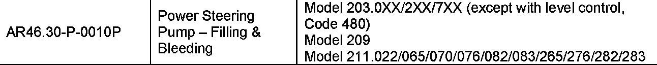

Follow the tech bulleting instructions to turn the steering wheel lock to lock 30 times before starting the engine. The repair procedure does not make that clear.
Tech bulletin:
The W211.076 is included in this tech bulletin:
This is AR46.30-P-0010P:

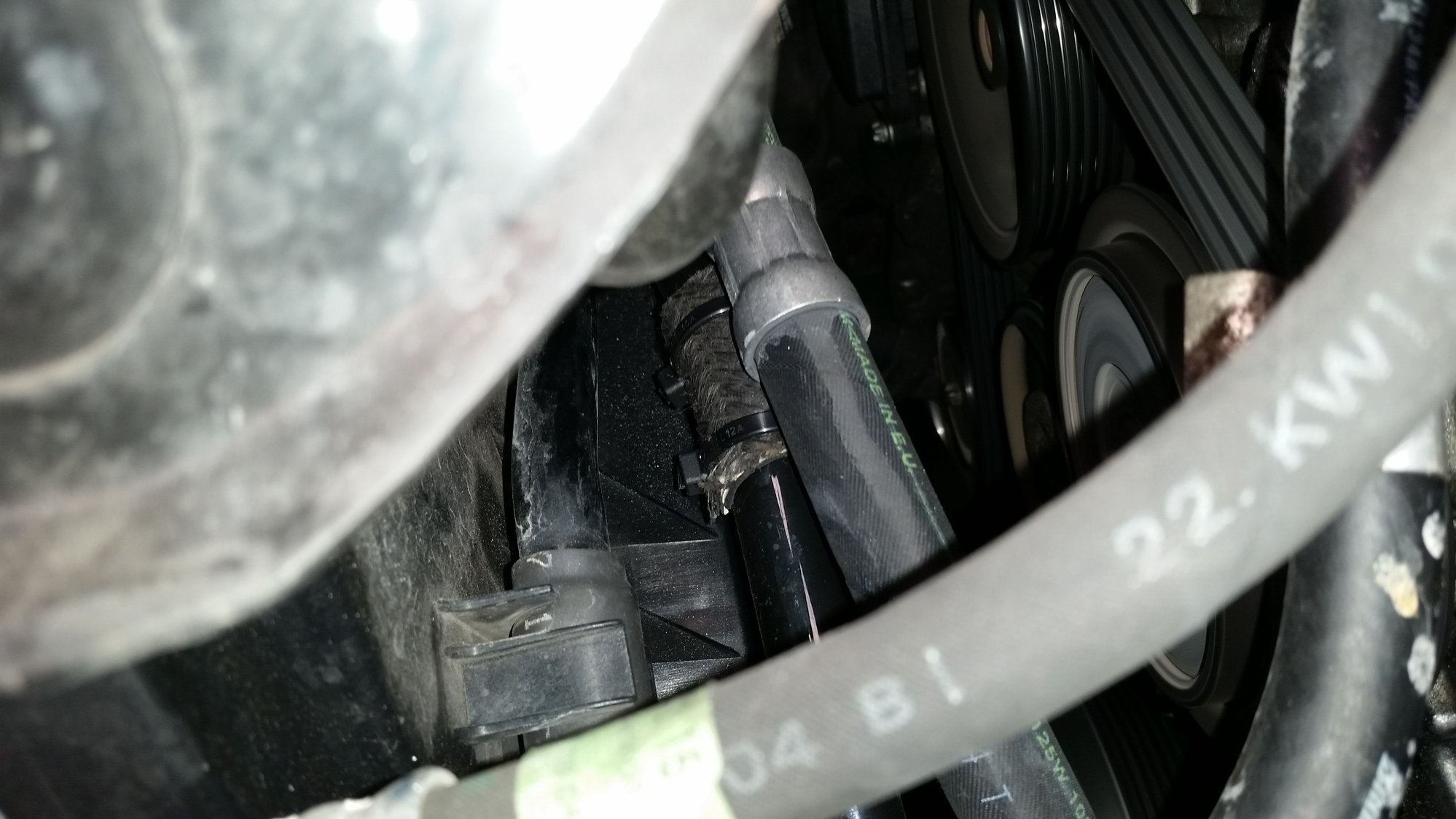

It also appears the hose is two pieces and can be separated with 17mm and 19 mm wrenches. The split is underneath the car before it goes up into the rack. I really would rather not have to drop the rack. This would make the job a lot easier. I will look tomorrow.
I had pulley failure which took out both belts and pulled the power steering hose up into the crank which slightly split the hose.

You do not have to drop the rack to replace the high-pressure and low-pressure lines. You'll need a replacement tie wrap because the one on the low side line will need to be clipped. Be sure to clean the area around the steering rack hose connections before opening the system. Disconnect the solenoid plug, then proceed with the removal.
The high-side hose should come with a new o-ring. Have a low-side o-ring on hand. Torque specs below.
Banjo bolt, pump (use new seals): 40 NM
Bolt, bracket to oil pan: 14 NM
Bolt, bracket to steering rack: 10 NM
Bolt, oil line retaining plate: 18 NM
Good luck!

One more thing. Do yourself a favor and protect the coolant pipe positioned near the power steering hose. The pipe is prone to puncture over time due to contact with the power steering hose.
