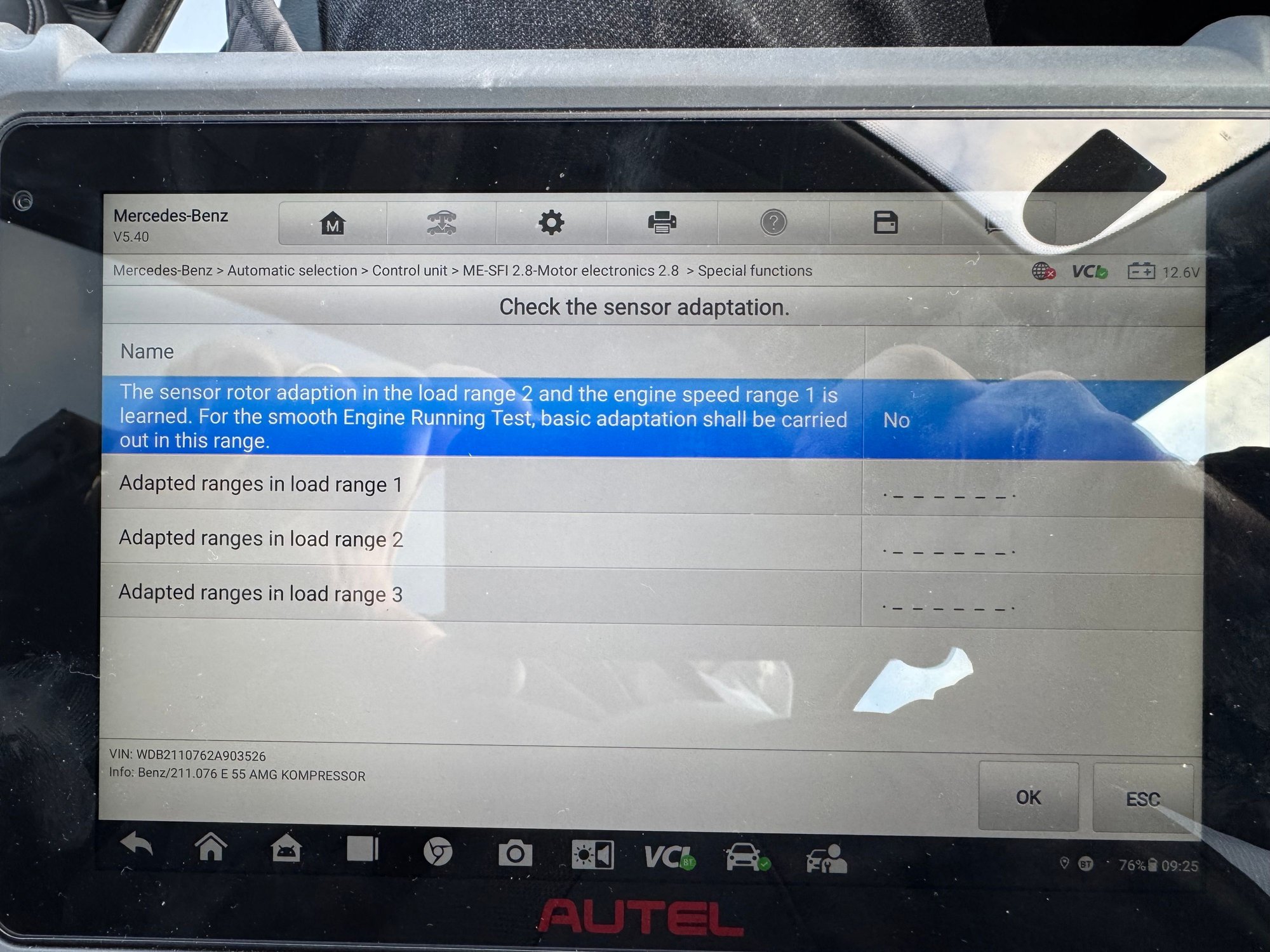

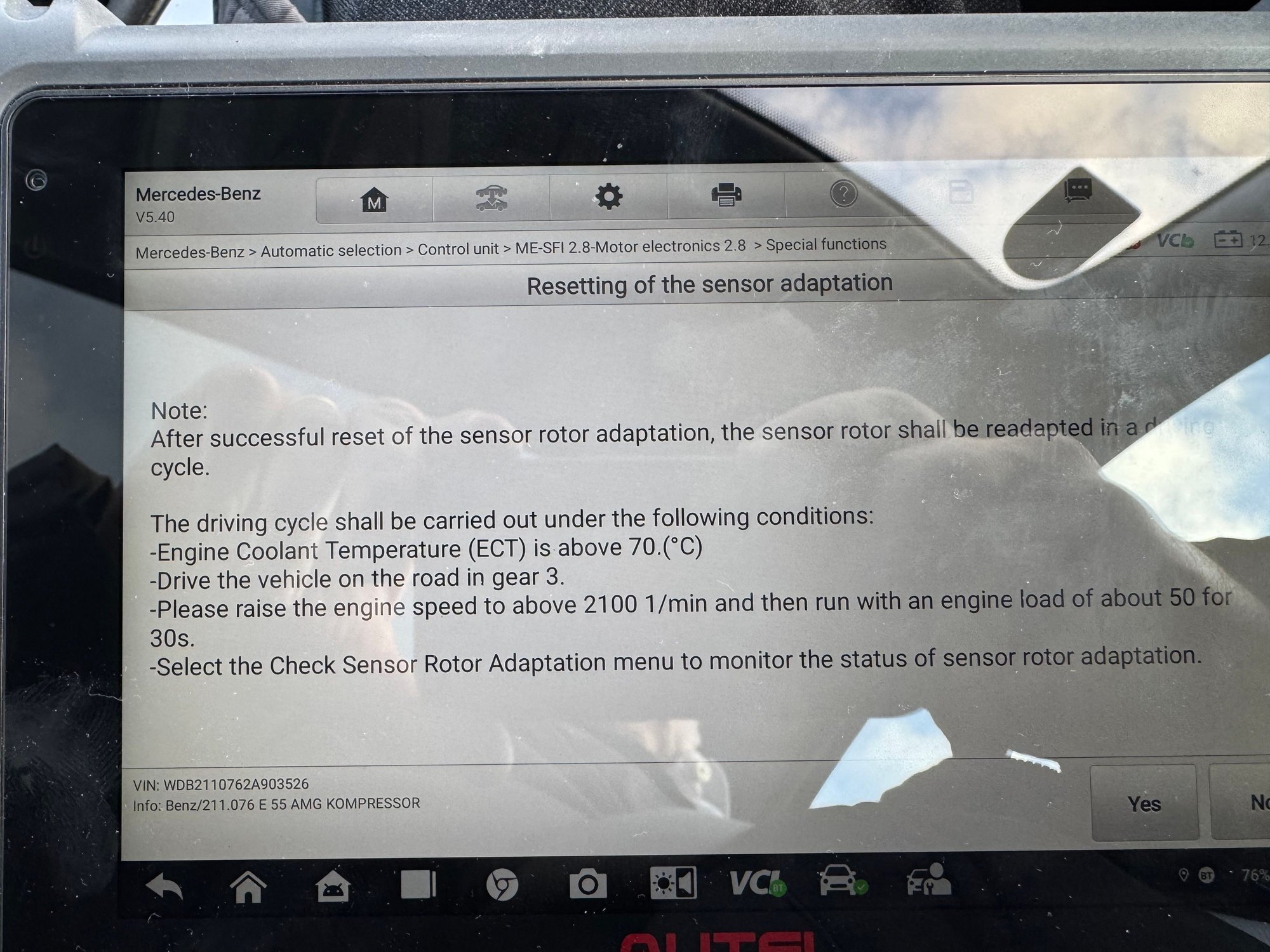

So did a Sensor Adaptations reset as part of my rabbit hole dive into my P1999 code issue but it seems the system is not activating the reset? Any ideas? And yes I have followed the teach in process.

After some more driving its now set to yes. Yay

Awesome !! These ECU's sometimes need some crazy drive cycles to set things.
The Evap monitor takes the longest to set, around 50 miles or more.
