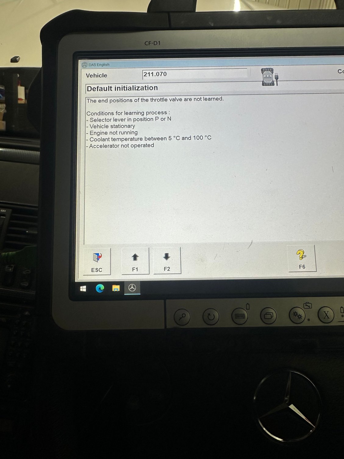

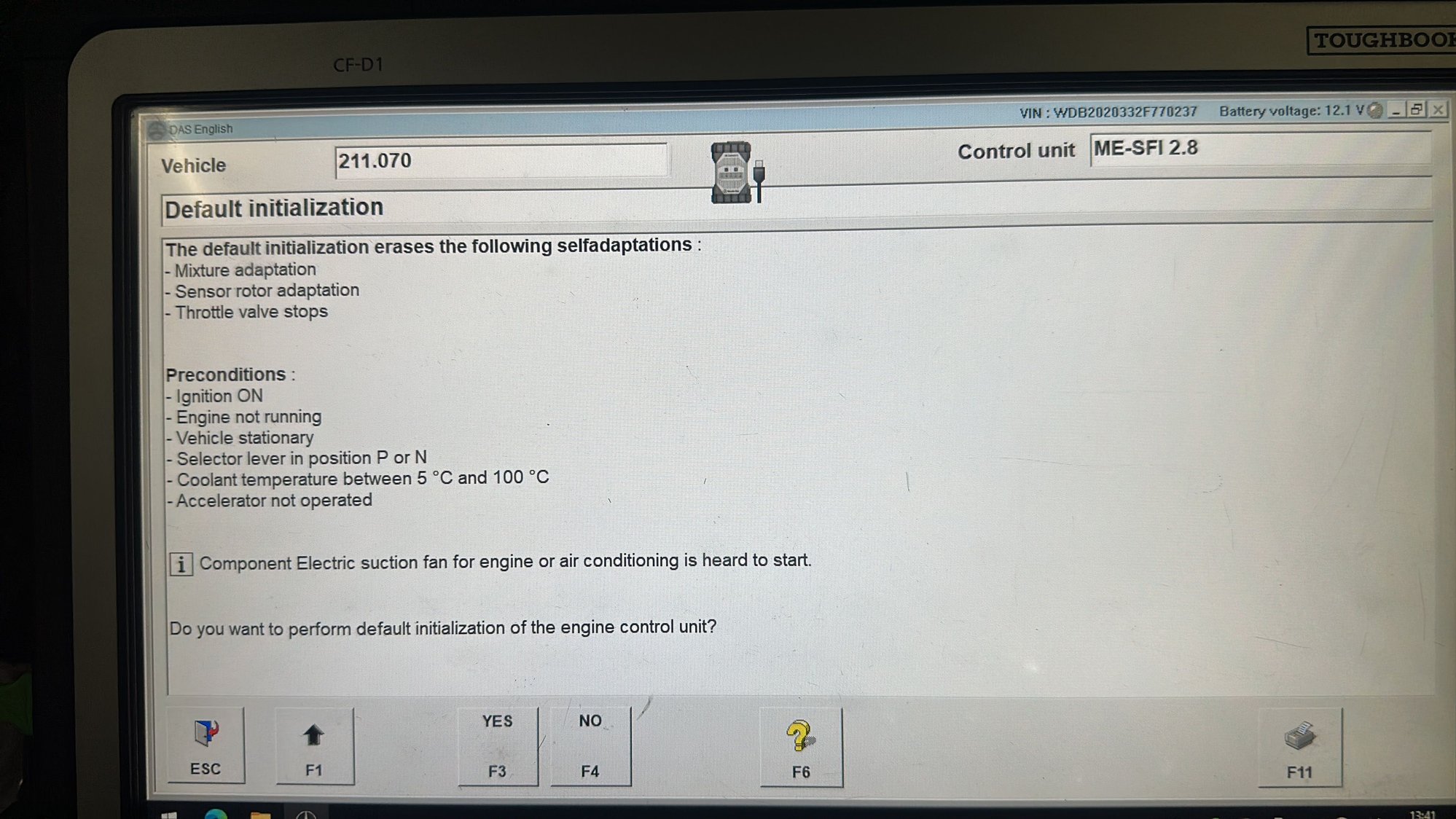

I have an issue with intializing throttle body with DAS
All preconditions for the intializing are met, but it’s not intializing.
I have no gas pedal now since the reset.
can anyone point me in the right direction, no fault codes present.
