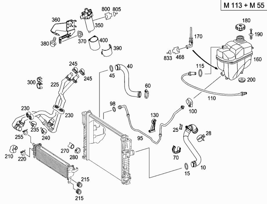

Having a hard time finding an aftermarket or OEM auxiliary water pump hose that connects to sc intercooler system for my e55. found out in the middle of taking the sc off that one of the accessorie pulley had eaten into it. wondering if anyone knows where I can find one online because I've had no luck so far.

Still available. 11 in California, 2 in New Jersey, 21 in Germany. Contact your MB parts department. I received this information from Mercedes of San Antonio.
225 HOSE
HOSE LOW-TEMPERATURE COOLER TO WATER PUMP AND COMPRESSOR 001 A 21 150 001 75
