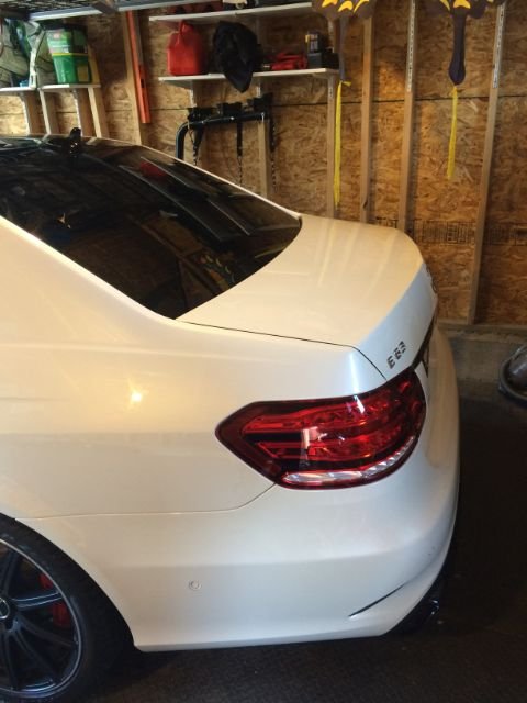

Here's the car sans spoiler.

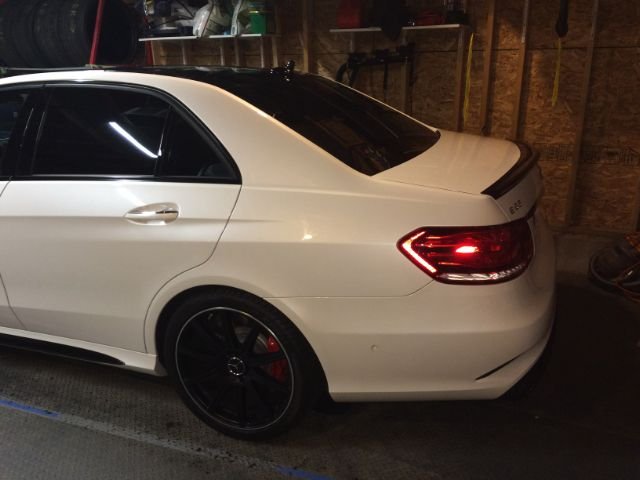

Here are a couple shots of the spoiler, and the final result. I think the black spoiler adds some nice 'pop' to the car. It should have been part of the Night package from the factory.
