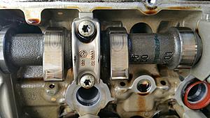

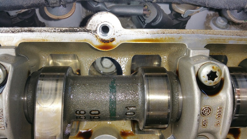

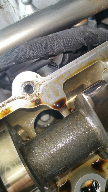

Guys...so I'm thinking to inspect the cams again now, seeing as it's been a few months since I last had a look. If the wear on the lobes is any greater, I might as well replace the cams. Here is what they looked like last time. They weren't terrible, but probably were showing light signs of wear. Engine is still pretty quiet IMO and although I think the car is a bit slow, apparently it's normal for an E63 to feel like this.

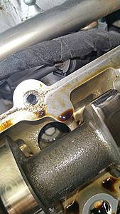

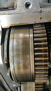

FWIW the motor has revised headbolts, although whether this was done at factory or by a previous owner, I have no idea. Here's a part number of the cam gear though FWIW (if it's even legible)

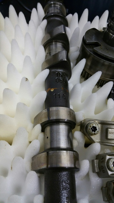

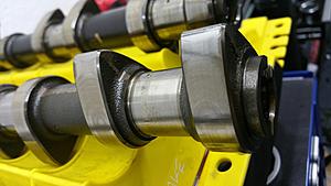

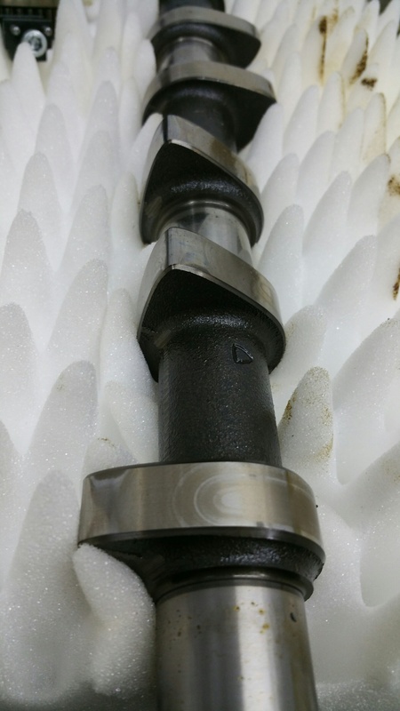

Update

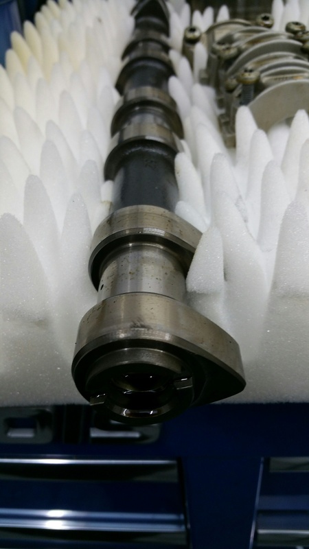

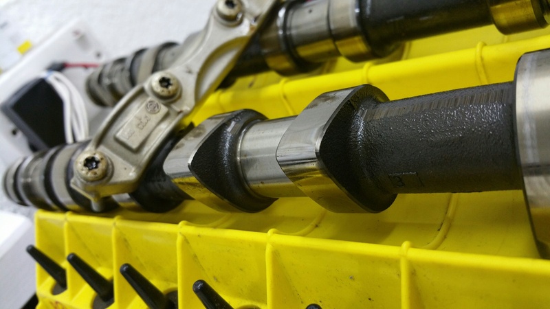

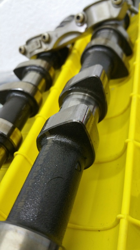

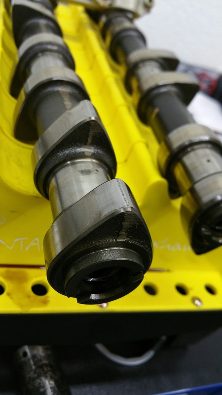

Ok so here are my stock cams with 79k on them...slightly worn in places. Probably had another...7-10k of life in them until they would completely die in typical M156 style . Some pitting in places and a little meh n worn on a couple of lobes. Light scoring on my followers (sorry, no pics of those) and one was a little gauged apparently.
