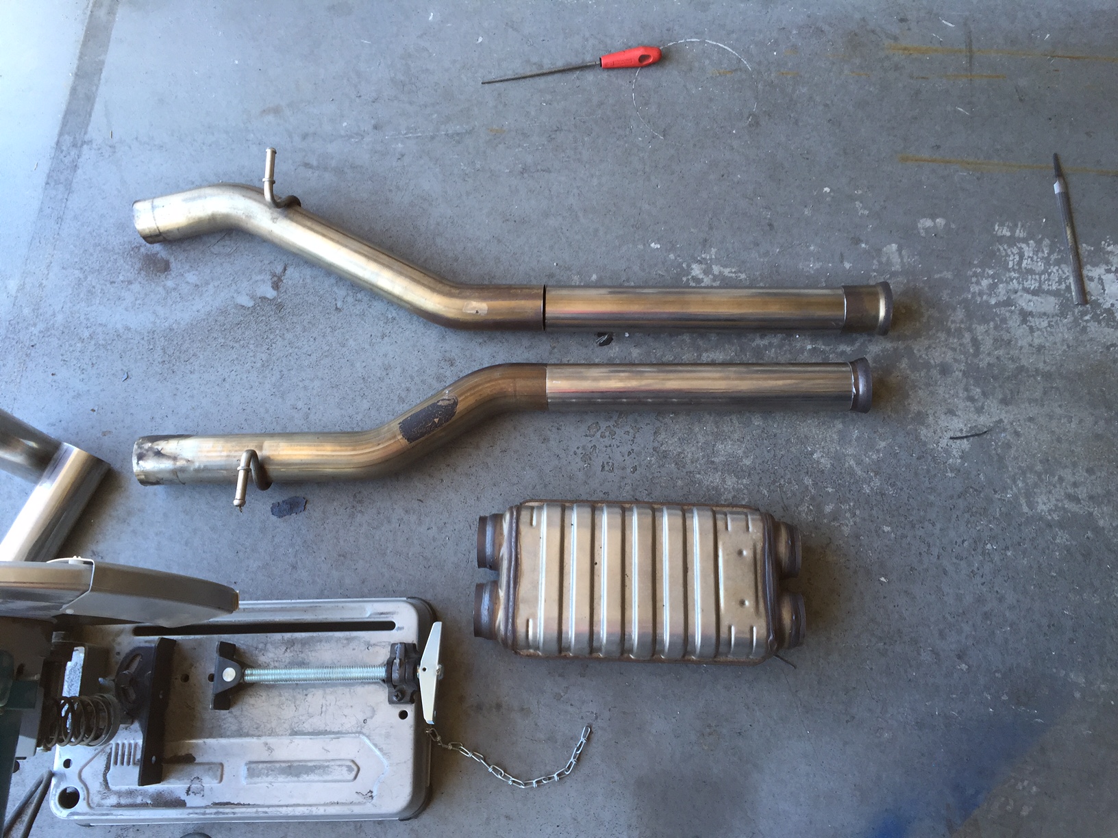

I just purchased a 13' E63 and am looking to remove the resonator with some straight tubing or possibly an H pipe. My friend is willing to perform the delete if I provide the materials.
Does anyone have the resonator lying around that can provide the measurements? TIA

I just did the delete this past weekend on my 2014 E63S. I don't know if the 2013s have the same resonator, but my resonator, after making appropriate cuts, is approximately 17" long and the tubing is 2.75" in diameter. Attached is a picture. Hope this helps.

Add the H pipe back. Something between 1.5 and 2" for best sound.

How about going with a X pipe or is it too far back
for performance gains.

At that location I think it's probably too far back and in my case it quieted the sound too much.
