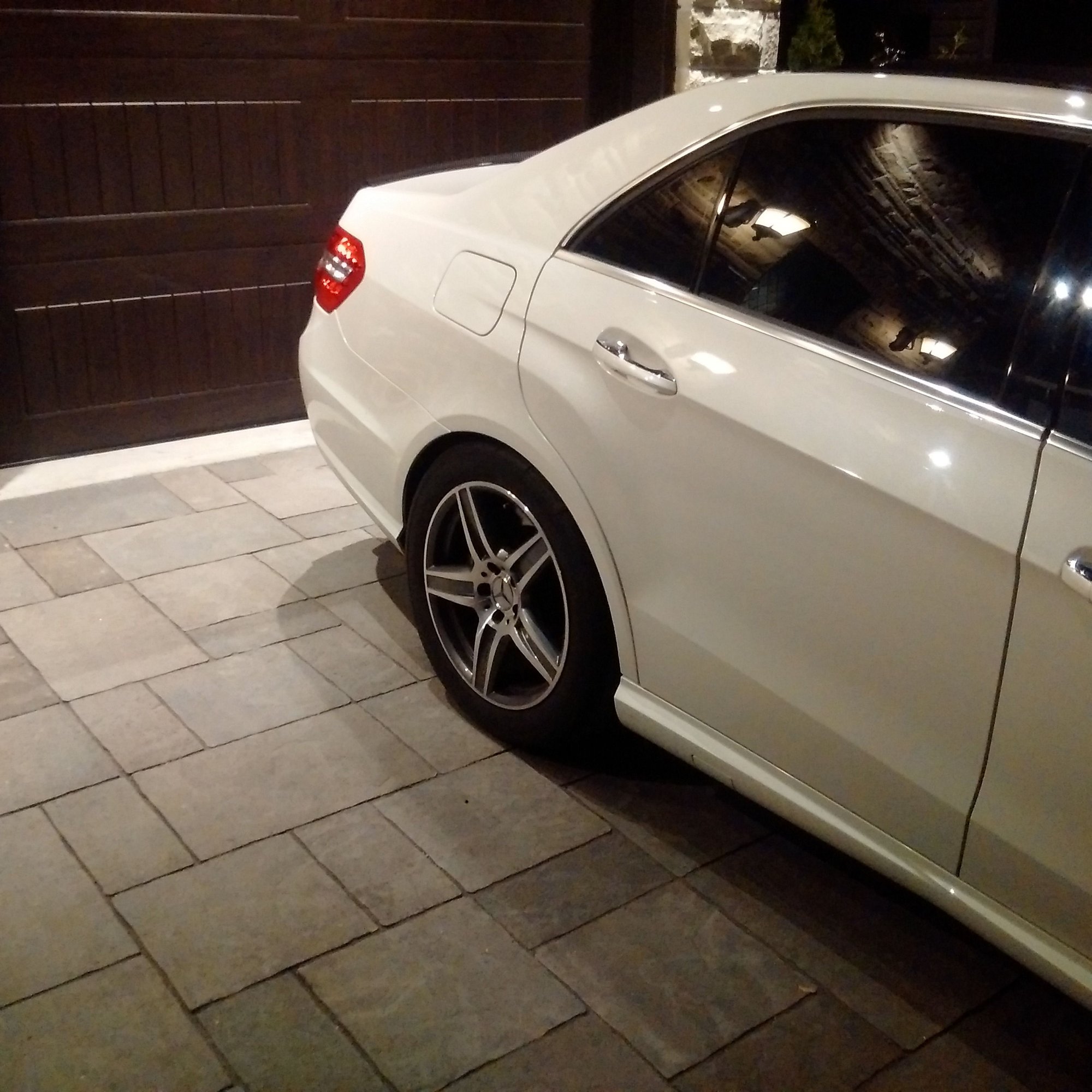

mickey Thompson et street SS 18" grips like a ****

17" will clear the rear if you cut the tabs off the back of the pads but the rim can't have a tapered barrel
