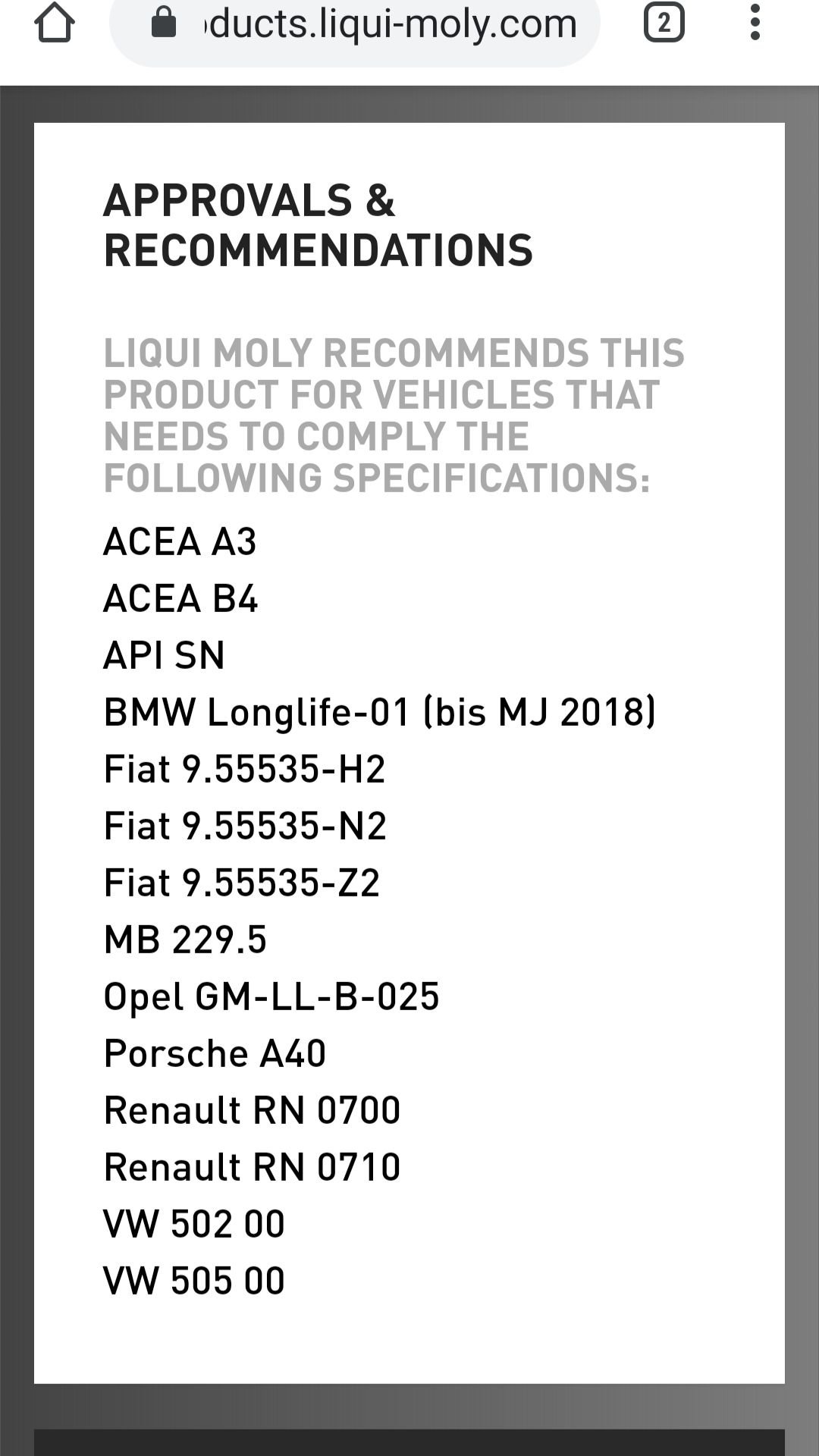

Yes it does meet MB 229.5. Do YOUR homework.

Let me help you learn to read... This is direct from the Liqui Moly website page for Molygen 5w40. Clearly you didn't earn enough money to buy a Mercedes based on your reading comprehension.
No where does it say 229.5 approval, it says Liqui Moly recommends.....
There is a difference

This on the other hand is for Leichlauf 5w40, again directly from the Liqui Moly website. See the difference chief? One is approved and one is recommended. There IS a difference but I doubt you'll understand that

Furthermore.... Here's the list of approved oil direct from MB. Show me where the Molygen is...

Molygen Next Generation actually doesn't have ANY approvals. Is it possible it's just so new they haven't added it yet? I'd find it strange they would start selling a product with no approvals by any car makers with no hope of obtaining them in the future? Would it be possible in say 6 months molygen next generation shows up on the MB approved list?

Anything is possible. Approval testing costs a substantial amount of money. If Liqui Moly had approval for a new oil I'm sure it would be a high priority to advertise it as such.
