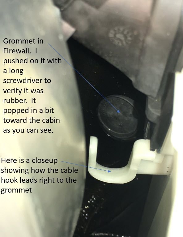

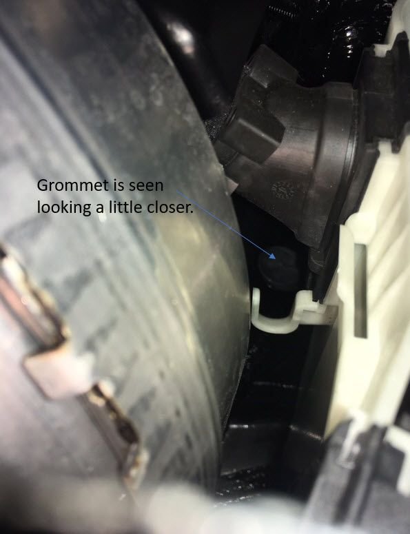

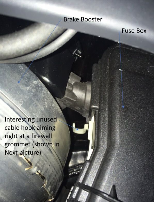

UPDATE: Can it Really Be This Easy?
Hey Guys,
I finally got to looking at this a bit closer and I believe I found the Holy Grail for getting through the firewall! I will need to confirm my find this weekend by popping off the panel above the pedals in the cabin. But I did find a sweet 1 inch diameter grommet that looks promising as you will see below in the pics. There is even a vacant cable hook lead-in toward it. It is unused. So either the madmen in Stuttgart thought ahead and did us this favor, or there is some option that I am not aware of that my car does not have leaving this vacant. Car is loaded, so I kinda doubt that. I wasn't sure when I first saw it if it was a rubber grommet. So I pushed fairly lightly on it with a long screwdriver and the darn thing slightly popped through toward the cabin. This is what I need to confirm this weekend.
Here are the pics:
