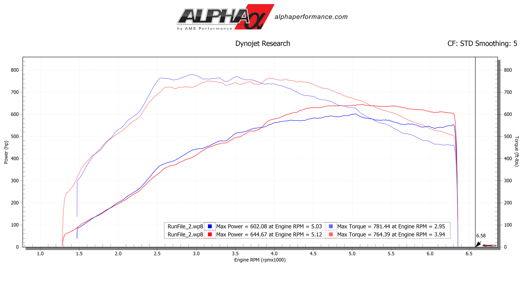

Here is the MS109 and 93 pump fuel. I was told they softened up the race gas profile, the torque spike was higher than desired.

how are you switching back to pump gas file? I use ms109 as well. Just throwing it in and after about 10 miles of driving I literally feel the tq get extremely violent. I can’t imagine what it would feel like being tuned for it. Probably great

I might be missing it somewhere but I didn't see clarification that these numbers are at the wheels. The Hp numbers look like what I would expect at the wheels with a 15% drivetrain loss. However, the torque numbers look like what I would expect at the crank. So I may not be understanding your charts entirely. AMS advertises on their site that they can get ~ 830 Lb-Ft of torque at the crank and 700+ Hp at the crank with their ECU tune. I believe this may be a stretch, however, it shouldn't be too far off. BTW, I have exactly your setup without the catless.
Can you verify what these were? Appreciate it.

honestly it looks about right for a race gas file. I put down 630- 728 tq just on pump gas. Stage 2 , no cats . When I throw on the water meth I get an extra 40 hp at the end of my rev. I just can’t see having a race gas file and I have to constantly put race gas. Wish they can use the sport buttons to swap from pump gas to race file

Yes, this was reported at the wheels.

why does ms109 have less torque until 3800 rpm?
Ive had good results running 100 tune using 94 pump fuel blended with 15-20% methanol. My ECU adds ~20% fuel at WOT which could exceed the fuel pump capacity at 640whp, so I would not use more than 10% methanol blend with oem fuel setup.
maybe AMS and other tuners can test a ~10% mixture like this on the dyno, if the knock resistance is similar to ms109, it is cheaper, more convenient, and cleaner-burning.

I was told the torque spike was to high on ms109. They softened up the boost hit.
As for E85 / methanol fuels, it's my understanding the the existing high pressure fuel pumps (2) cannot keep up. There is a pump in development for the " AMG 43 " engine, TT V6 I believe. I'm told it would be possible to use two of these pumps on the M157. If I recall correctly, the 43's use one high pressure pump. M157 uses two.
