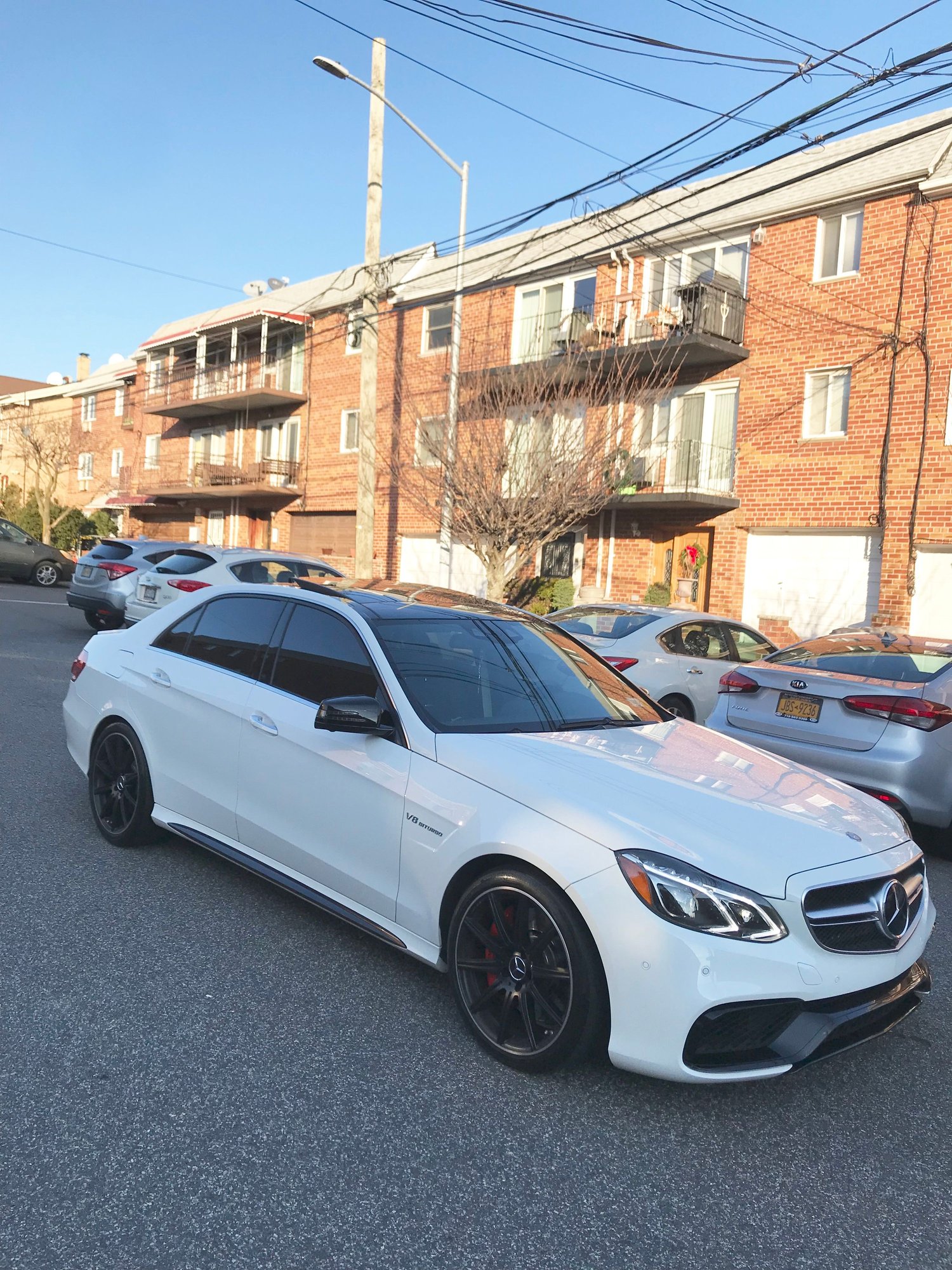

We will start with a picture of my pride and joy.. Showing off her 20% tint. Also can see the tow plate mount, after a bunch of tickets here in NY, i had to install a plate -__-

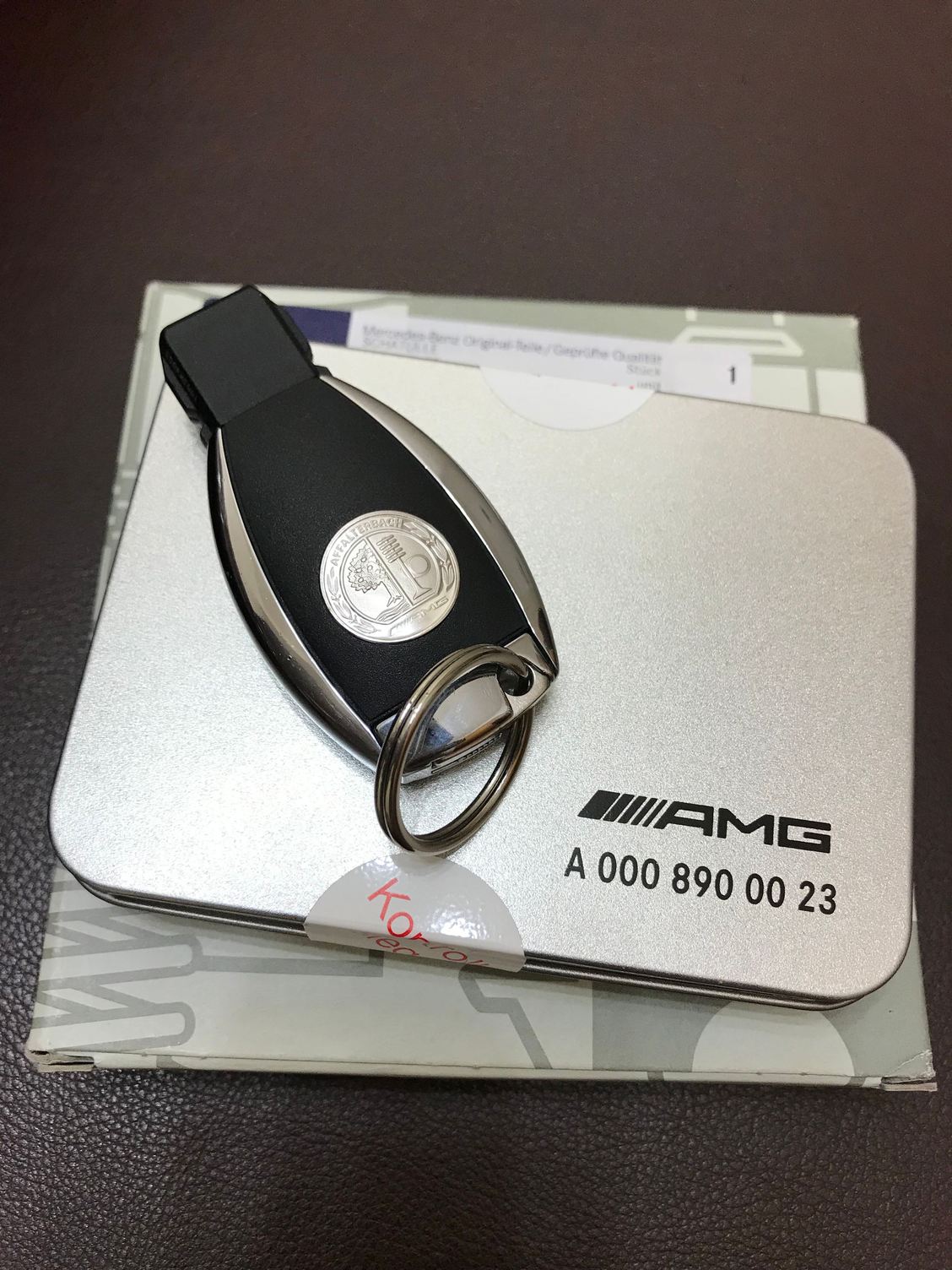

Every AMG comes with 2 of these new from the factory in the car as a present. If you are a second owner and want one, there is the part number on the case it comes in

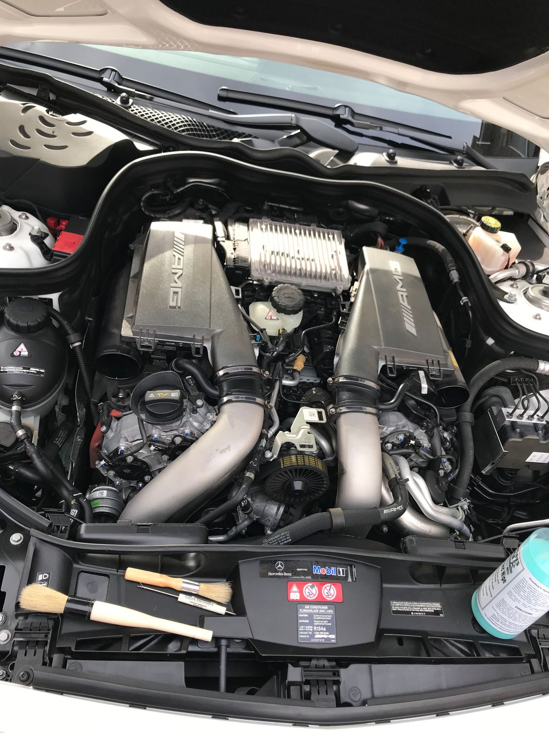

Nobody likes a dirty engine, removing some of the items to get in those hard to reach places with some detailer spray and detailing brushes

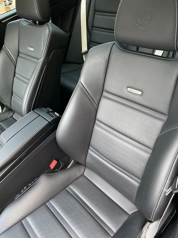

Used Leatherique leather cleaner with some leather brushes to get the seats clean and factory matte again

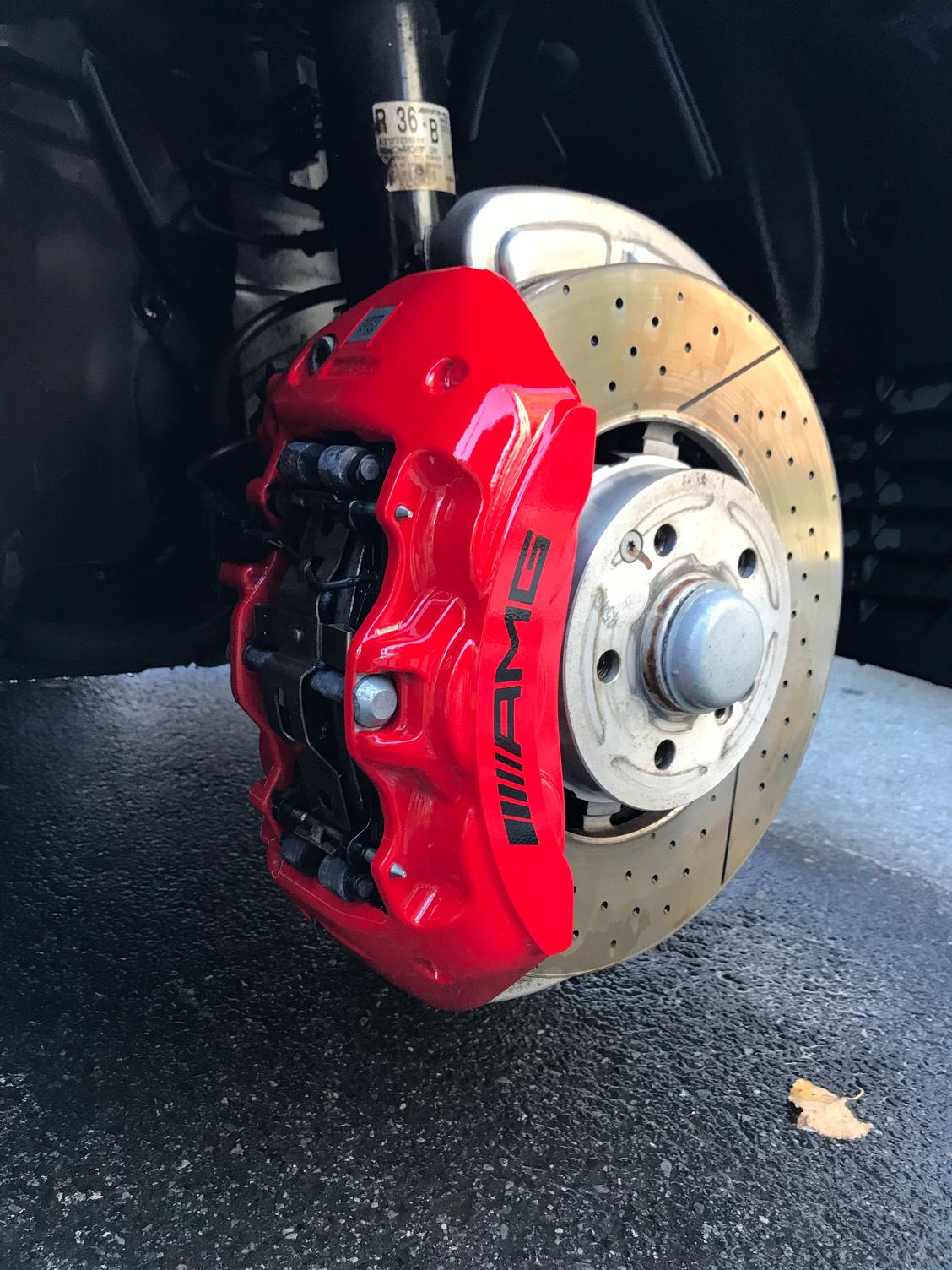

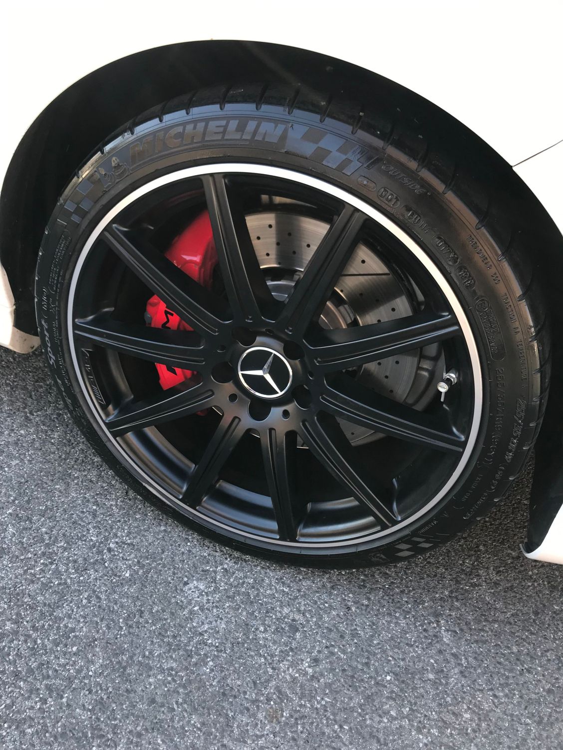

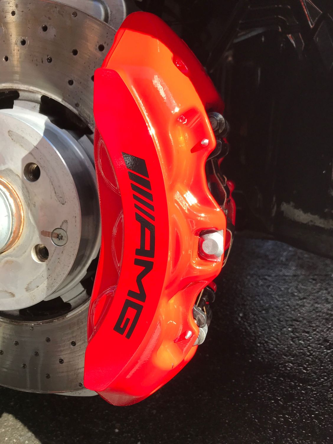

Removed the wheels and cleaned the calipers with some iron X and brushes.Sealed them with sealant aswell. Also used some 0000 fine steel wool on the dust sheilds and hubs to clean them up.

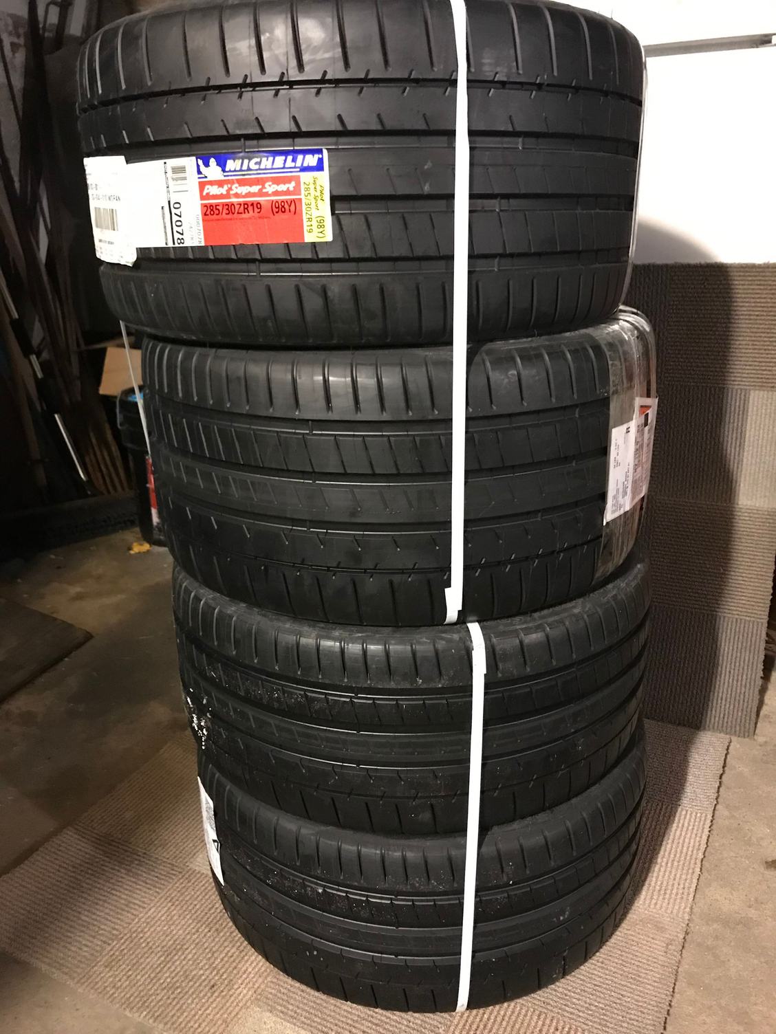

New OEM sized Michelin pilot super sports and a Mercedes dealer wheel alignment.

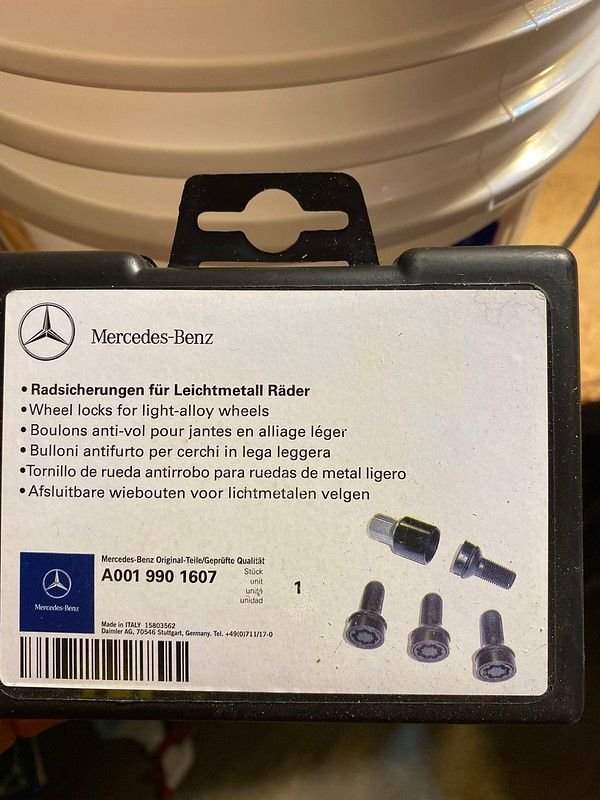

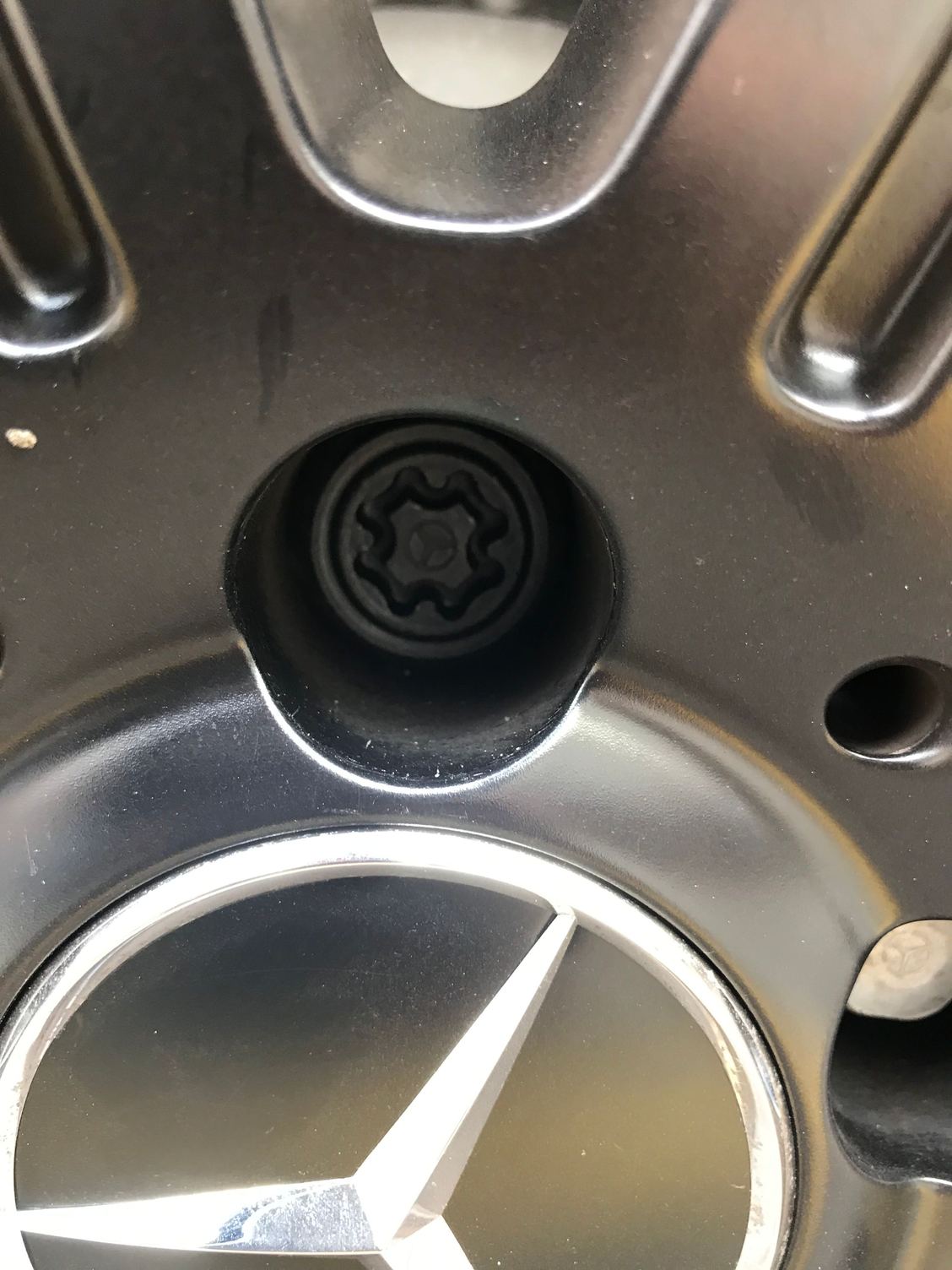

OEM black wheel locks

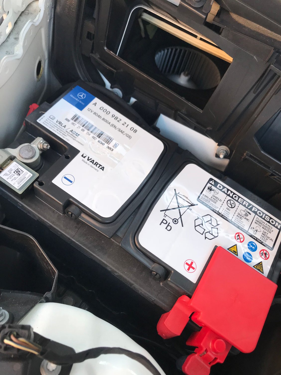

Changed out the front main battery and rear aux battery as preventative maintenance. Was a easy DIY job.
Front battery has a small tab holding it on the bottom front via 1 bolt, passenger side of the battery has a vent that needs to be pulled out on the top of the battery.
Remove the POS and NEG cables and up and out.
Remember, our hoods can be pushed to 90 degrees straight up for servicing items like this and for easier work in the engine bay. Just push the hood past its normal seating position and it will go to the service position.

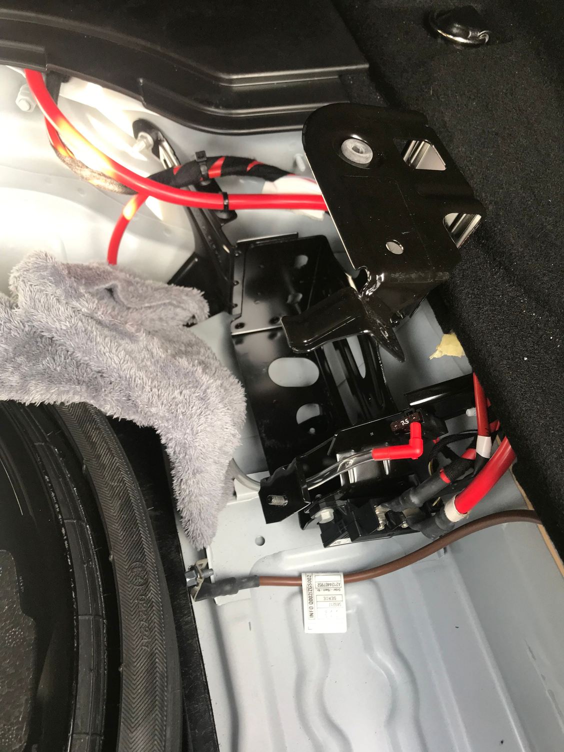

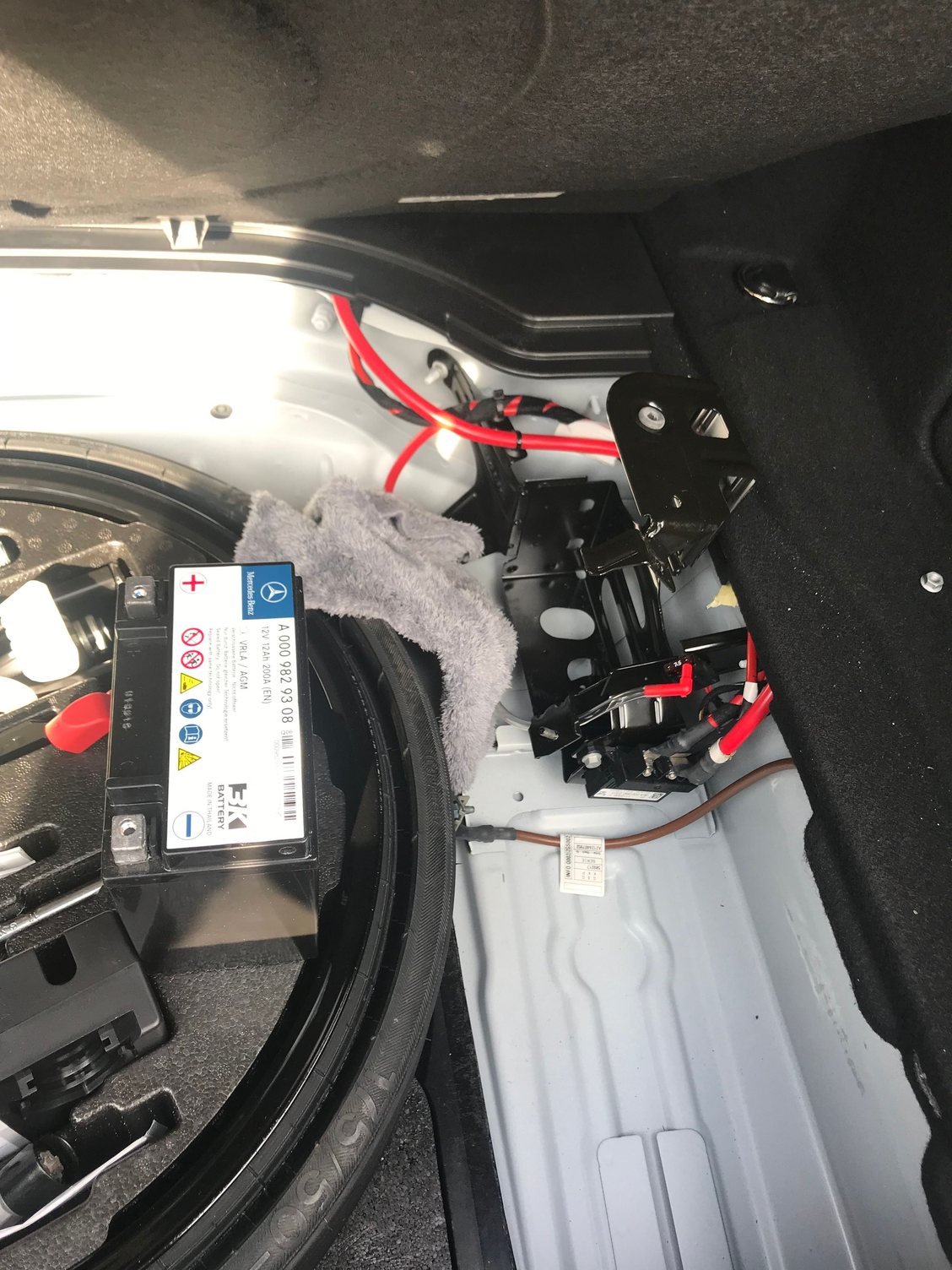

Aux battery in the trunk is mostly the same as the main battery.
Vent on the top of the battery just pulls out, neg and pos cables get removed, and then a nut holds a bracket that goes over the battery to secure it, remove nut and unfold bracket up.

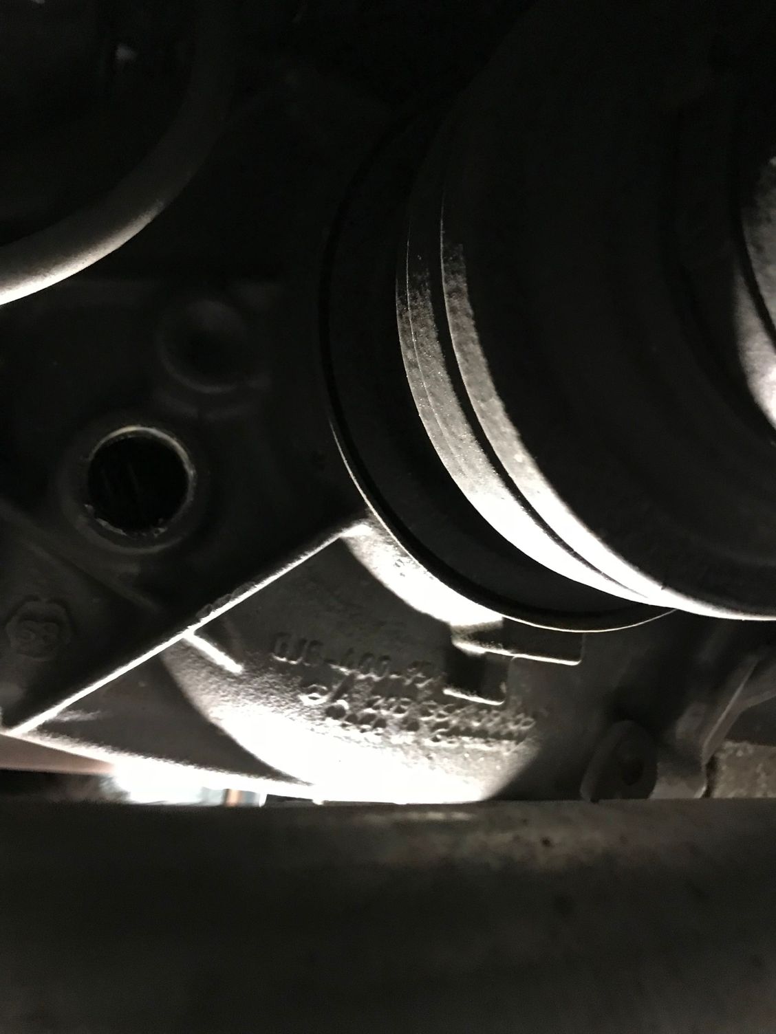

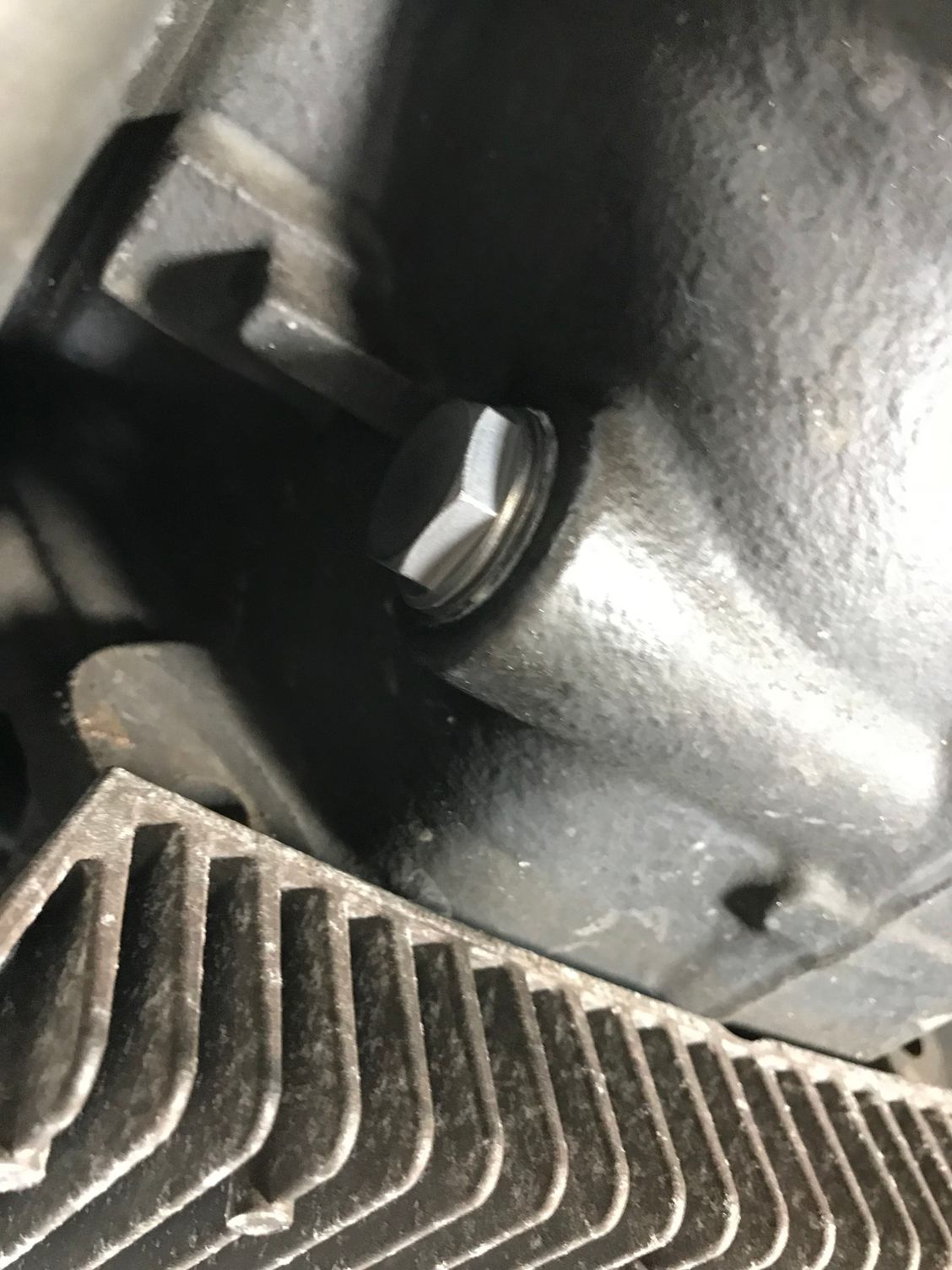

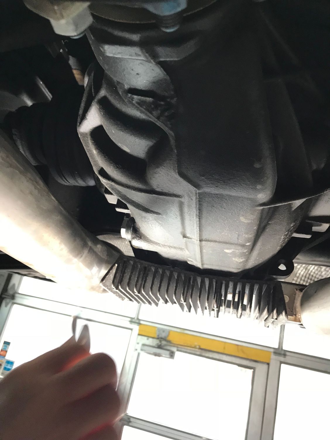

Many guys forget to change the diff fluid in our LSD's. Its easy and worth to do.
Fill and draing plugs.. 3 bottles of oem fluid (pricey) and some liquid thread sealant from your local auto parts store to put on the threads of the fill and drain bolts when re-installing.
I bought new drain and fill plugs just to be on the safe side, a dot of sealant on the threads each, fill until the fluid begins to slowly come out the fill hole, and close her up.

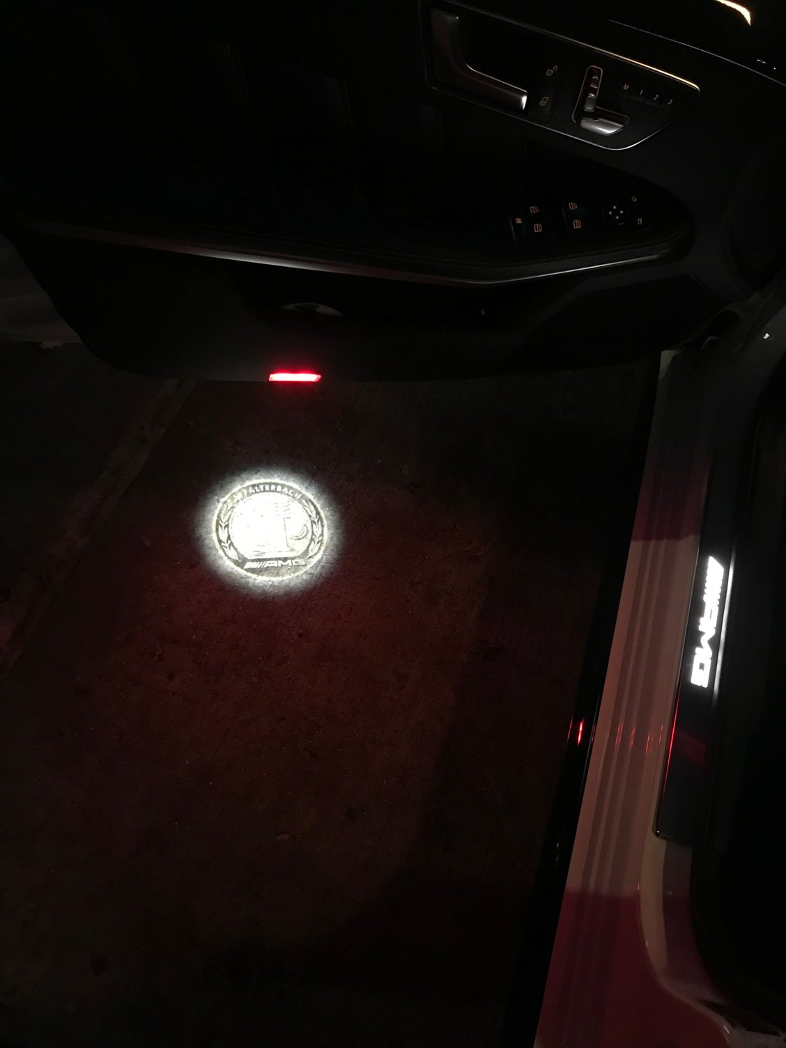

OEM AMG door puddle lights.. Expensive units but nice detail at night.

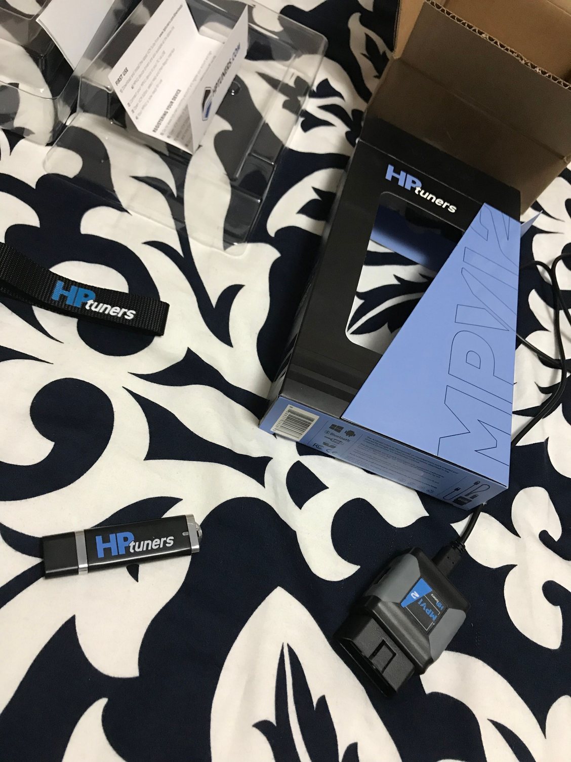

One of the most important items, HP tuners datalogger

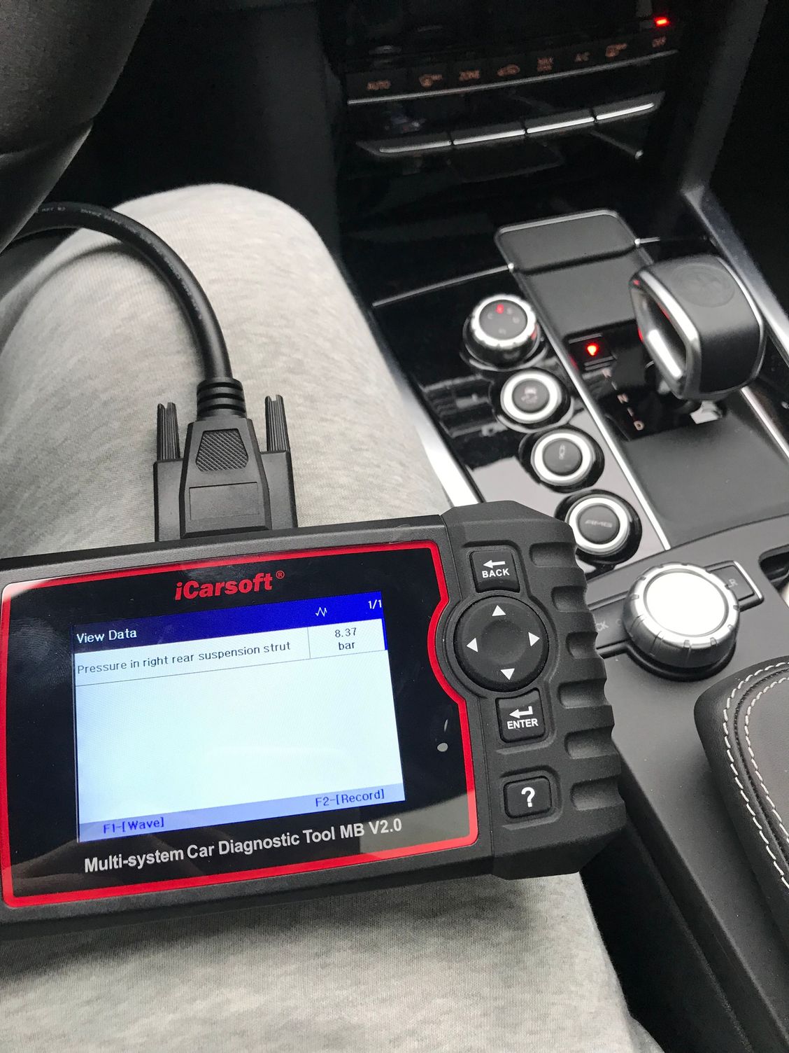

Also got an extra code reader that can read some values like airmatic air pressure, height, AC pressure, trans temp, etc etc.

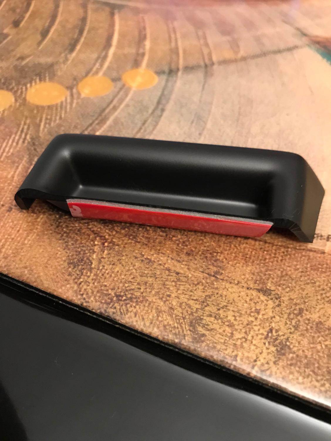

Got these paddle shifters off Amazon, im actually VERY impressed with the fitment and quality. Not 100% sure i like them, but very nice for 30-40$ shipped.

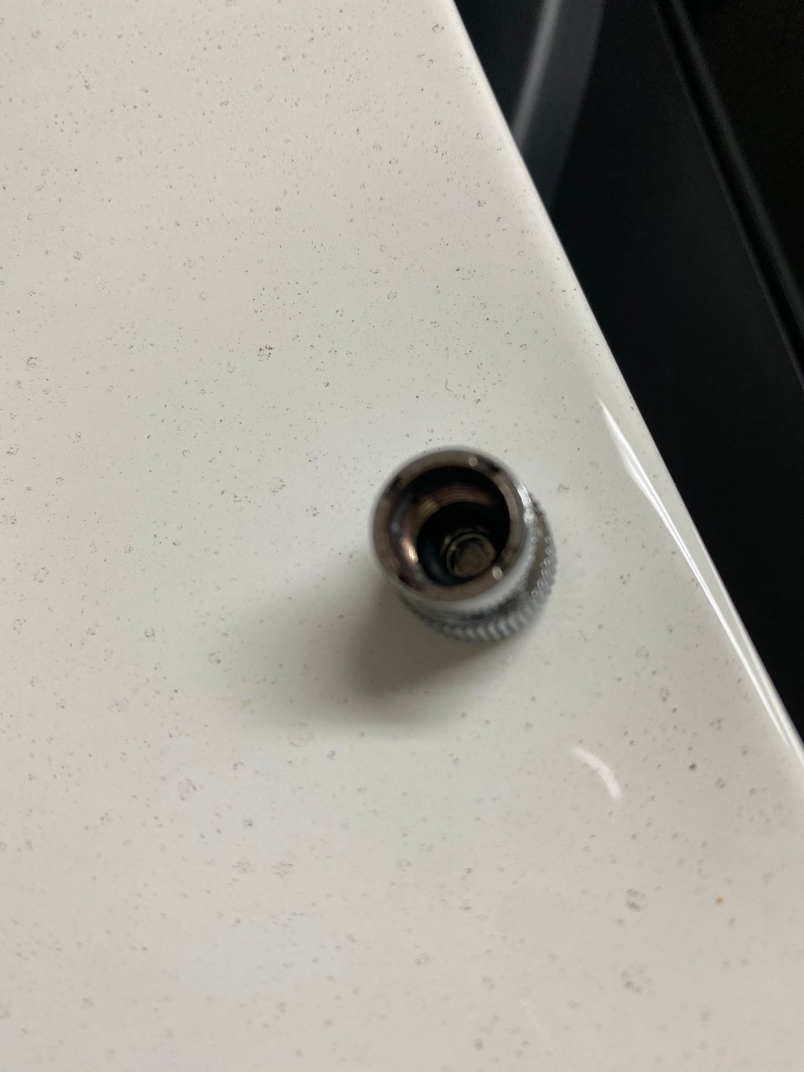

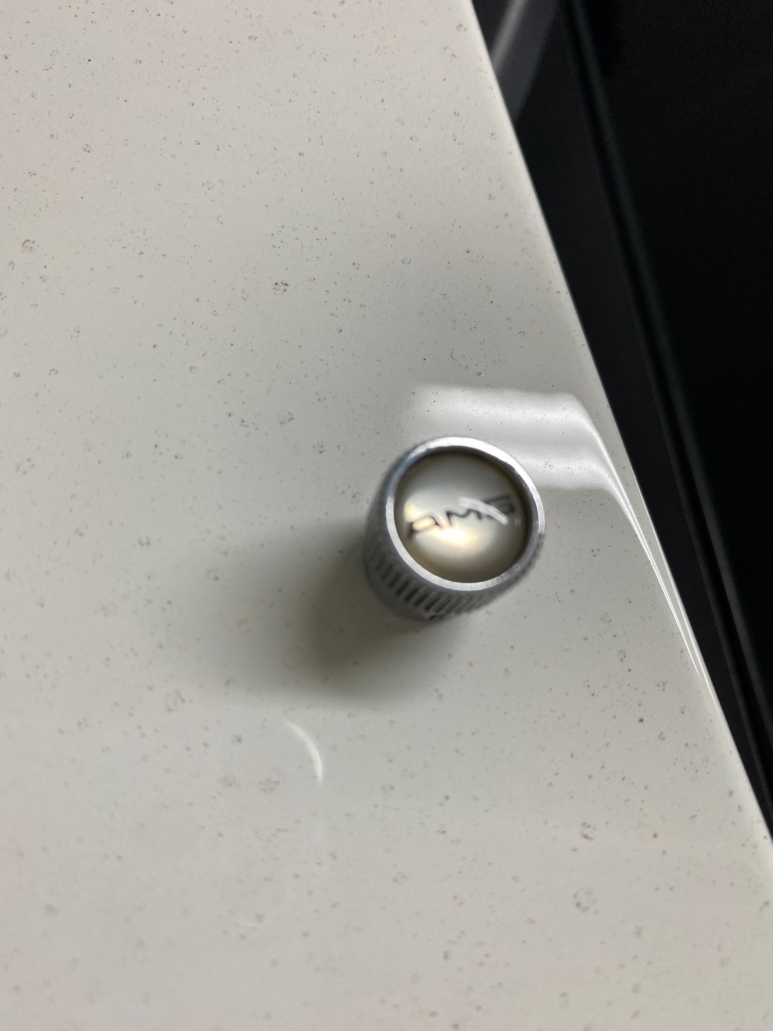

I love the look of the AMG tire valve caps but the metal ones are not recommended as they rust and effect the TPMS I heard. Unless the metal ones have rubber inside. Took mine off and went back to plastic ones.
Good eye, i forgot about those.. These are oem plastic AMG ones i got from the dealer. They have rubber o-ring in the inside, not sure if you can tell from the pics, but i havent had any issues with them or water getting in the air valves.

Would you have the paddle shifter link . I like the look of those.
Thanks much

Do you have a part number for these?

https://www.amazon.com/gp/product/B01M7QMUV5/ref=ppx_yo_dt_b_asin_title_o00_s00?ie=UTF8&psc=1 https://www.amazon.com/gp/product/B01M7QMUV5/ref=ppx_yo_dt_b_asin_title_o00_s00?ie=UTF8&psc=1

Not sure if they are still selling them, at the time i bought mine, benz told me these are becoming a factory option only, and not for order. They do wierd things like that sometimes.
Here is the P/N: A2138206003
I believe the price was around 200-300$

Absolutely stunning car, great composition of colors and many thanks for useful posts!

A213-820-60-03
