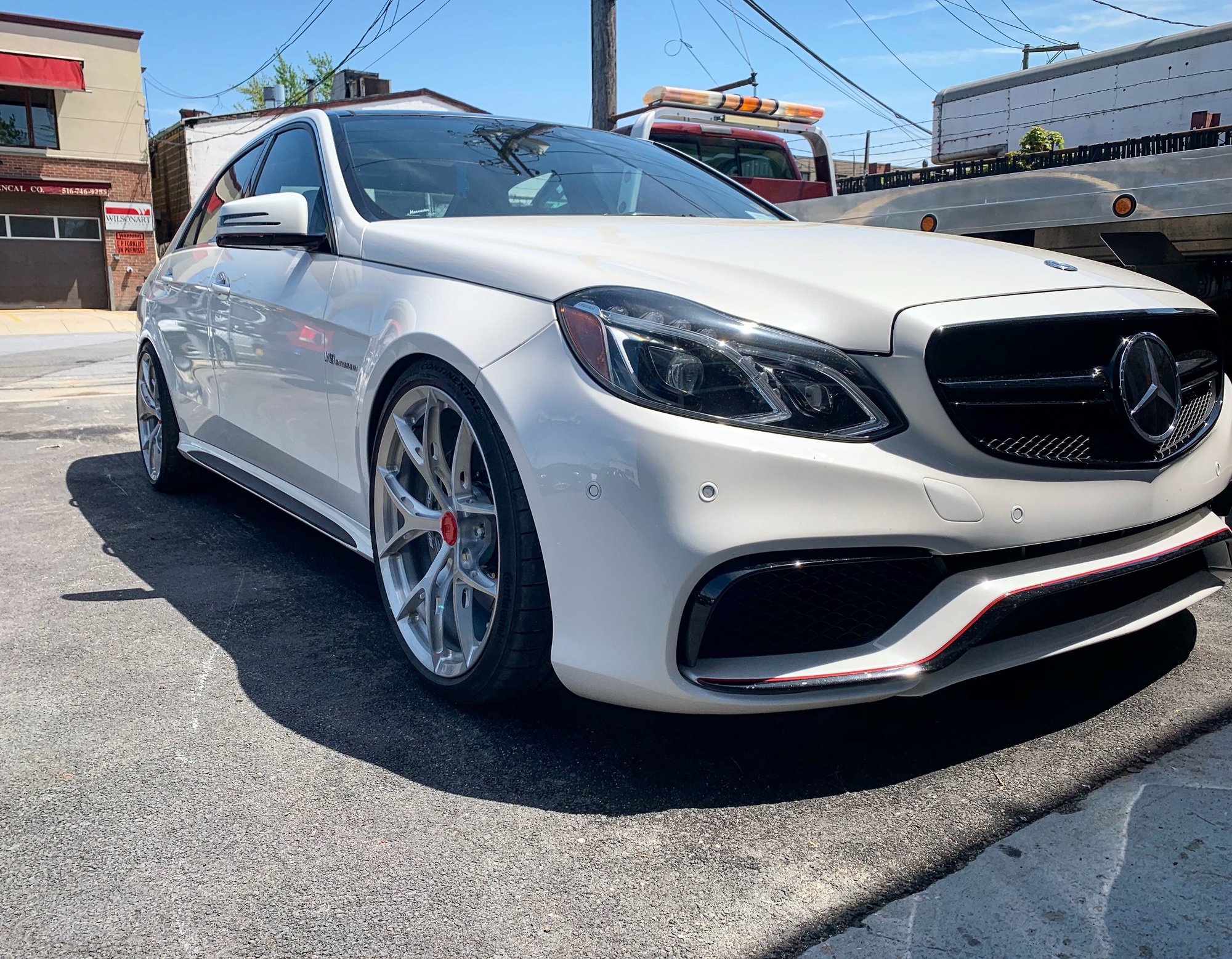

For an even concave look, 20x10 et35 all around. Or 19x10 et35 or 19x9.5 ET 40 I believe will give a concave as well but not 100% sure

Nice Wheels. Might have considered these instead of my new ones. I’m curious how they macined those crossing holes. Those holes really make the wheel look nice!

Thx brotha. They are super light as well. I’m curious as well lol. I do know bbs version of these cost 13k

Agreed . It’s absolutely absurd. These are made to order so the price is much better then bbs fi-r prices. since they don’t have to pay for a warehouse full of already made wheels. Comes with authenticity card, forged materials, strength etc. definitely a well made wheel.

Very nice. What wheels are they?

bcforged kls01 but they have a lot of nice wheels very very good quality. I can’t contact my guy inside if your interested that way you can possibly get a good price.
