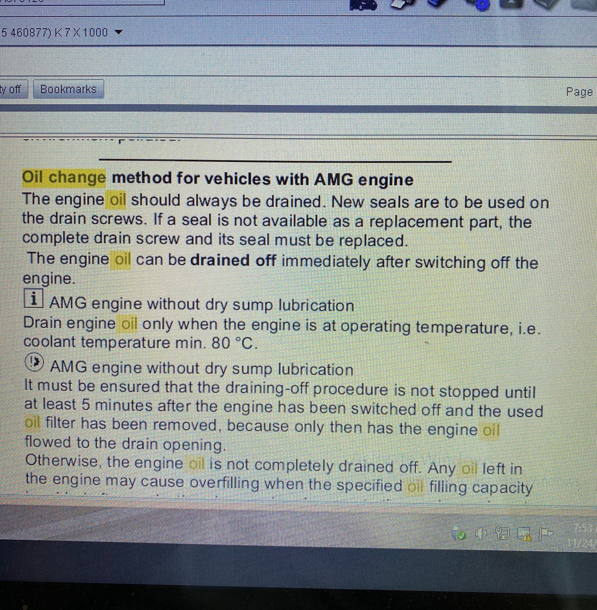

Im sorry but he is 100% incorrect, and the way the oil pan is setup on the 4matics with M157, it is not even close to being designed for top side extracting. May help quicken the job and turn over for the dealer, but the oil swarf that would be left over in the pan is something i wouldn't want for my personal high powered M157.
Per Mercedes, for efficiency (money maker talk), NON AMG’s 'CAN' get the top side service. I would still recommend drain.
For the M157, the work instructions are via drain plug.
On top of this, there is a specific warning on the notes on M157 oil changes page in WIS;
