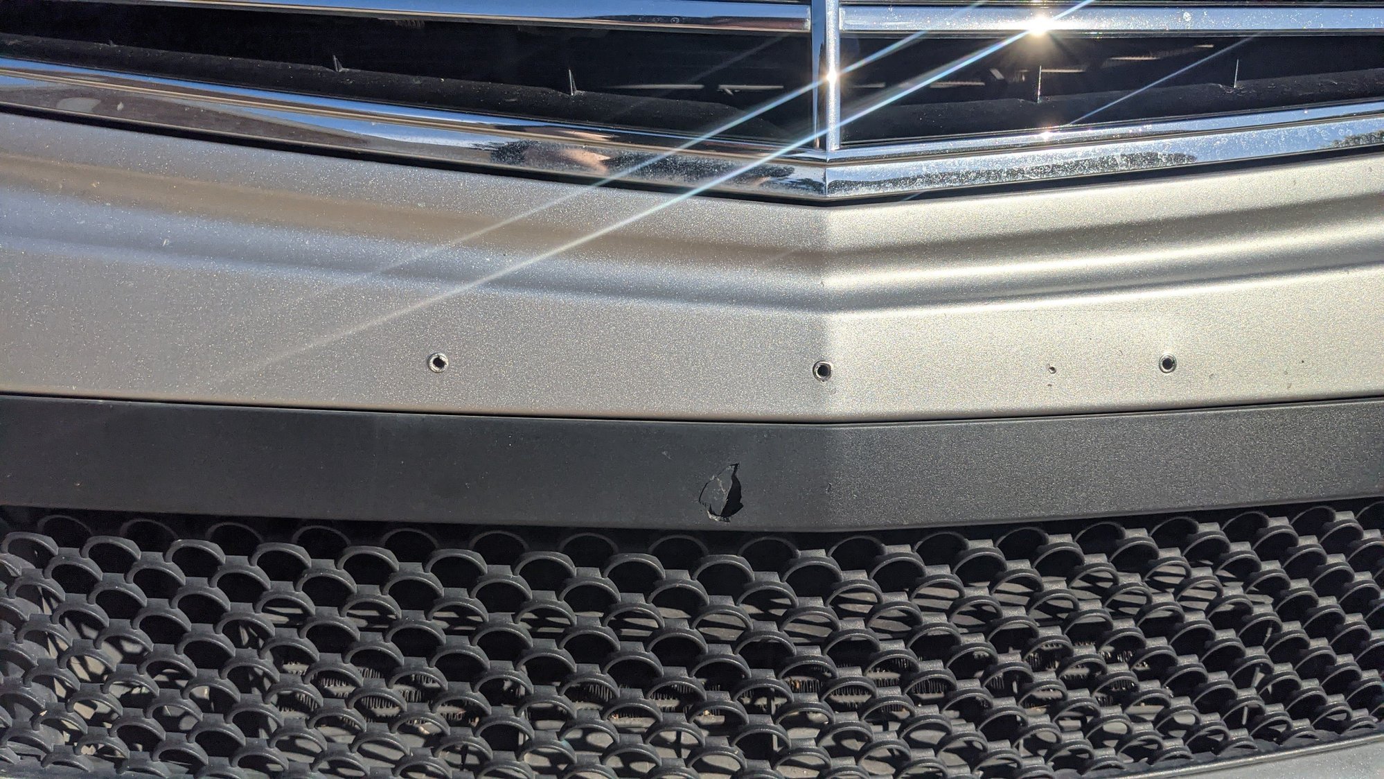

Came out to my car in the parking lot this morning and found that somehow, a nice hole had been punched in the black trim piece in the front of my car. I'm not seeing a part number on it, and can't seem to find it in parts catalogs. Anyone know if this is replaceable on it's own?

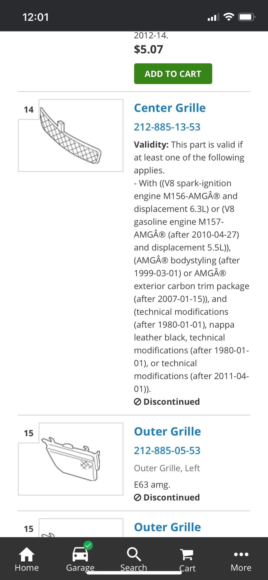

https://www.mbpartscenter.com/v-2013...mponents-front

Thanks, you all are legends! Somehow from the diagram I didn't think it covered that top trim piece, but this is perfect. Really appreciate it!

Part # A2128851353 is verified correct. The lower center grille comes as one unit with the black plastic bar at the top. You must replace the entire grille. Hope this helps.
