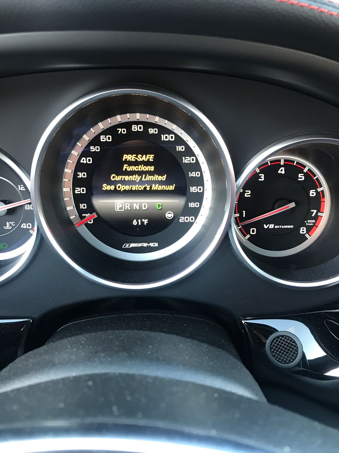

could this have anything to do with the coils or spark plugs? I also just got this message
Old Nov 20, 2020 | 05:01 PM
PeterUbers's Avatar
Joined: Jun 2004
Posts: 13,799
Likes: 3,229
no... limited means you may have a dirty windshield or sensors .... not related
Check main battery. Faults in the past such as distronic, pre-safe, car behaving weird with missing and shifting up/down etc i've encountered all had to do with needing a new battery. The night and day difference in the way the car drove with a new battery really had me scratching my head.
Worth a look.
