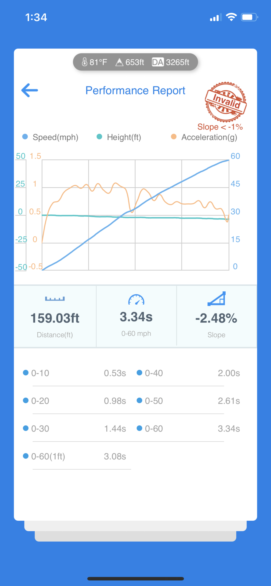

this was with full tank and spare and I let up at 125 cuz I got skerrd ... also I should have started at 40's instead of at 55mph
Old Dec 16, 2020 | 02:35 PM
PeterUbers's Avatar
Joined: Jun 2004
Posts: 13,799
Likes: 3,232
Slope on this same stretch is 1%, so it's valid I was having a satellite issue with dragy. Also this was on all seasons and I kept spinning to second gear lol .. I'm prolly good for a 2.8 with 1 ft and 7.5 second 60-130

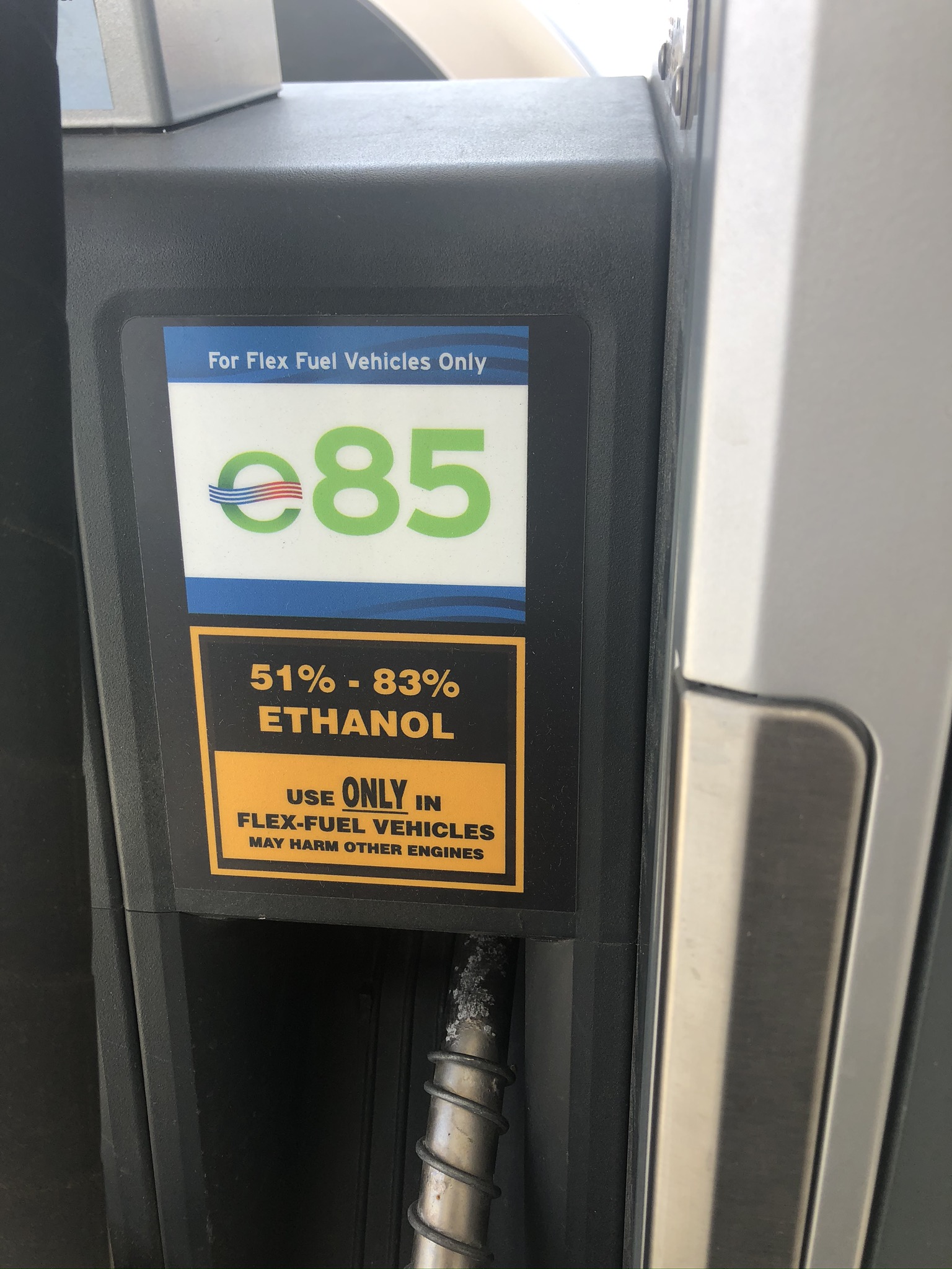

e50 is stupid easy ... 50:50 mix
That's the intention of the e47 tune (e85 + e10)/2, where e10 is normal pump gas.
However, a 50:50 mix only gets you there if pump "e85" actually has 85% ethanol content. The speedway by me has e75, and many have reported wide variations. It's best to check content each fill-up.
The different EC tunes mentioned (e30, e47, e60) in this thread as able to be obtained imply that any particular tune will not actually adapt to the different ethanol content. Otherwise, why wouldn't all the variations just be on one tune? Check your content and ensure it always matches with the expected content of the tune.

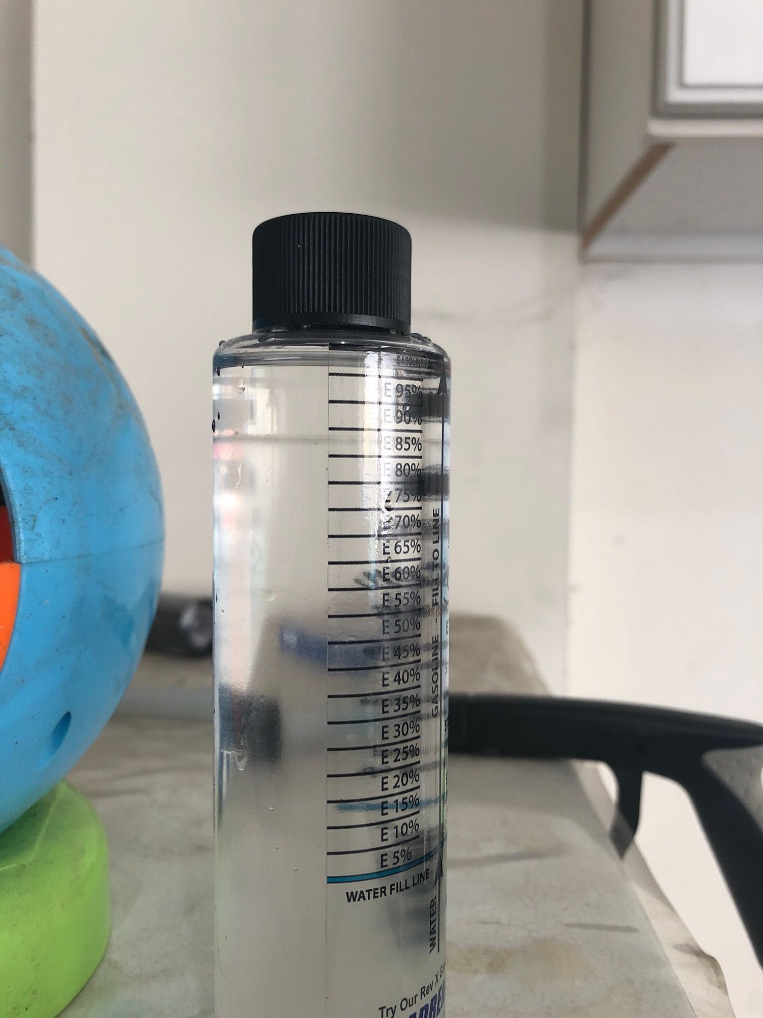

Can you explain what is in the bottle? or is that how you put in E85?
Old Dec 19, 2020 | 02:34 AM
SAMzE63s's Avatar
Joined: Jul 2018
Posts: 456
Likes: 151
E63s
i’m pretty sure that’s for measuring ethanol content. You mix E85 with water I think and it gives you the E amount.
Old Dec 19, 2020 | 08:17 AM
PeterUbers's Avatar
Joined: Jun 2004
Posts: 13,799
Likes: 3,232
correct
